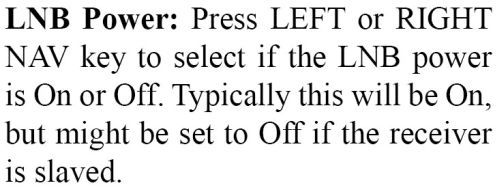

I'm not necessarily disputing what you say but this is what the manual says (below). To me LNB power means just that, power to the LNB in a non-slaved configuration. In a slaved configuration the LNBs are being powered by the master (4DTV) unit. Until I see further confirmation I'm reluctant to turn it on and feed LNB power to the Diseqc switch. I really wish the manual was clearer on this.

If you have a proper slave set up,each lnb should be connected to a 1 port power blocking splitter.From the splitter the power passing port goes to the 4DTV,the power blocked port goes to the Disqec switch,the Disqec then goes to the MicroHD,LNB power should be on to power the switch.Power will not get to the LNB because of the power blocking splitter.LNB's will be powered by the 4DTV thru the power passing port.
Well with all due respect, thats wrong. I figured it out and LNB power does not get turned on when slaving the microHD. This receiver takes a lot more work than the old Visionsat did to scan in the channels. As usual in a master/slave setup the master must be pointed at the bird you want to scan. On that bird select a V or H channel. On the microHD set up the Antenna settings to match the bird and select either Diseqc port 1 (C-band) or port 2 (Ku band) depending on which you're scanning. Go to Scan a single satellite and select either V or H depending on which polarity the master is tuned to. Now here's the part that was causing me the trouble, contrary to recommendations posted elswhere on the forum (by the developer I believe) selecting a detailed scan was required. A normal scan just wasn't getting it done. I have no idea why but selecting Detailed instead of Normal did the trick.
