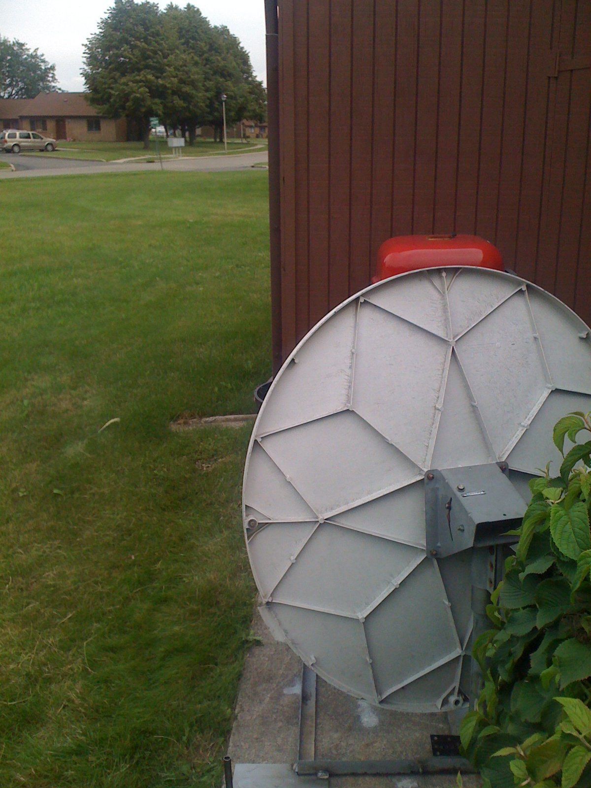

Have some pics of the new dish called Fridea.

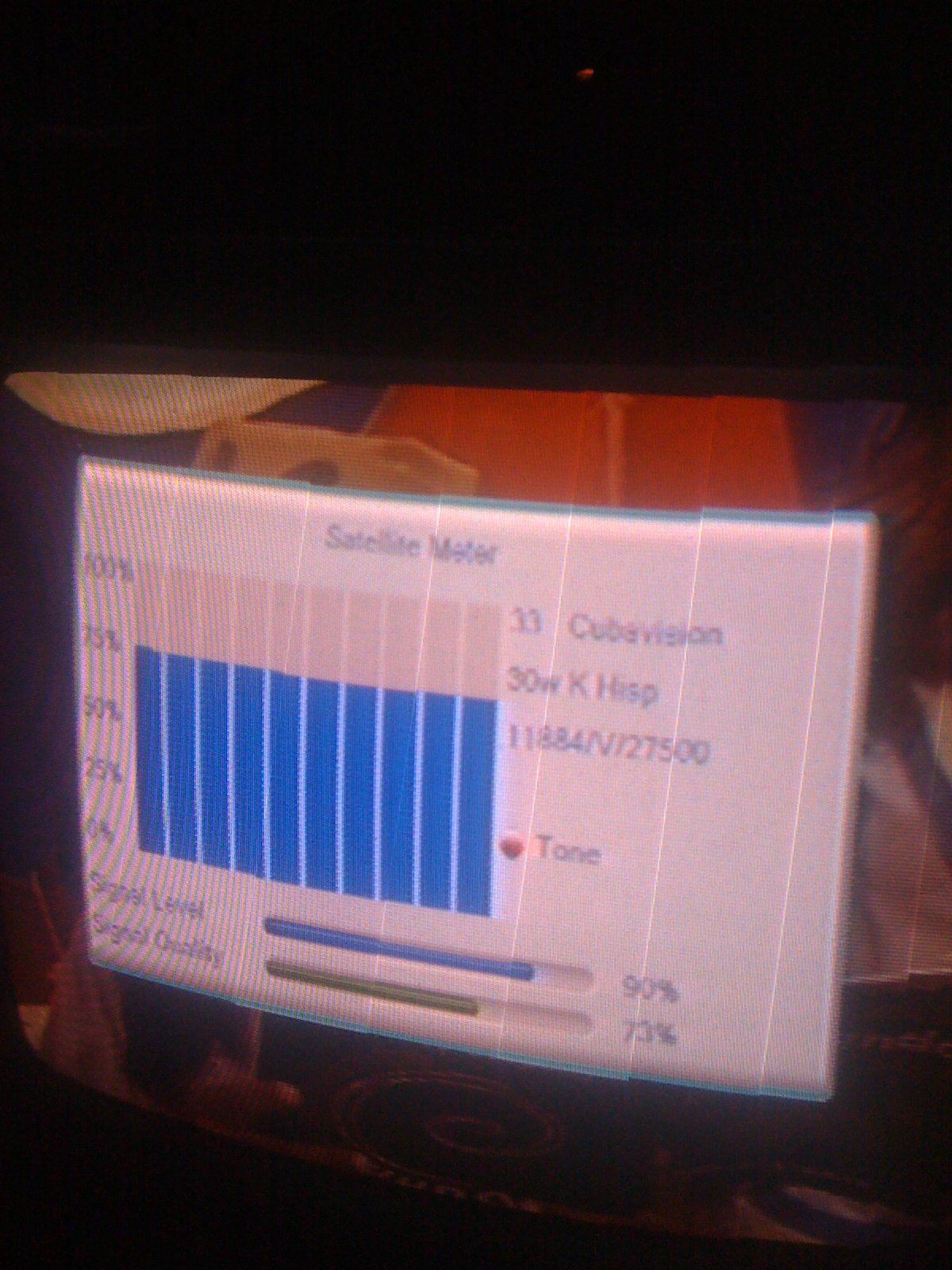

its am at 30w on the back porch. Also using the geosat pro pll lnb. hope you uys like the pics.

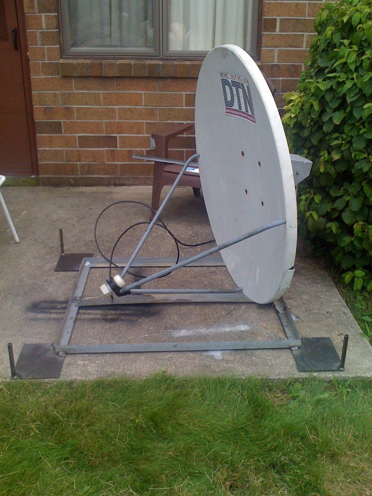

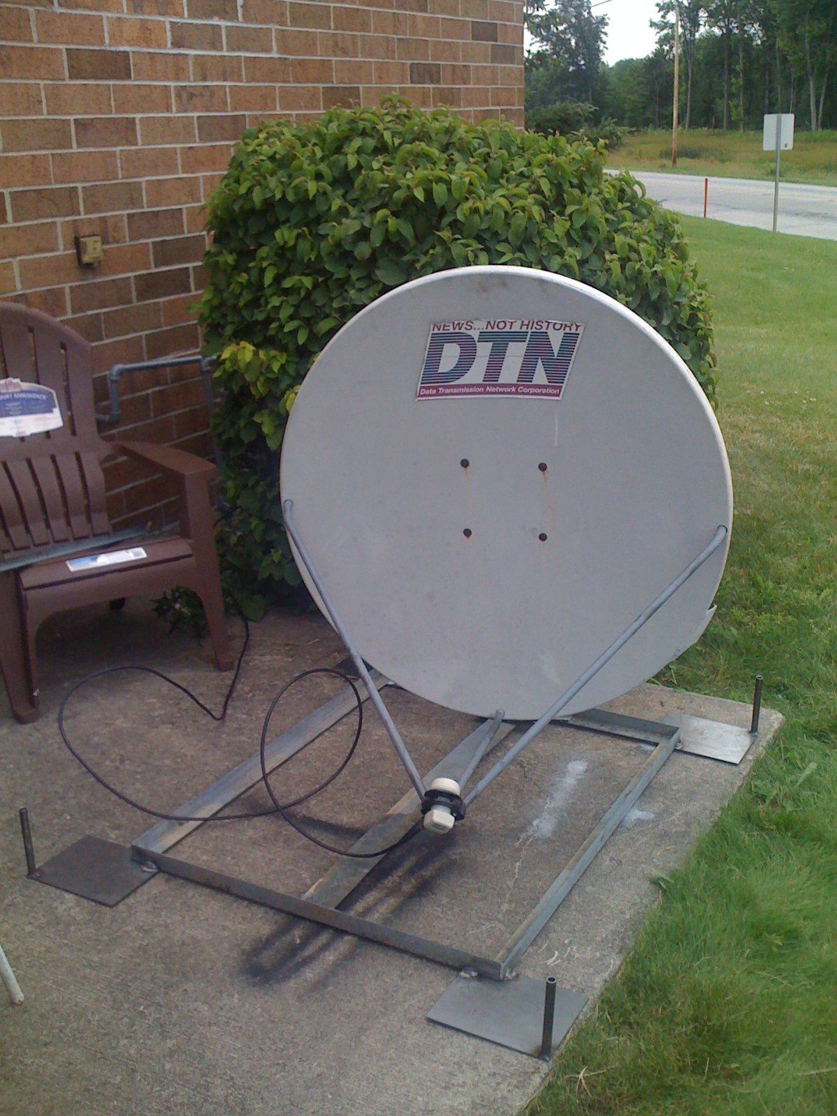

I may be wrong but that looks like a 1.2 meter dish but your lnb is more suited for a 1 meter dish. If you can find one of those older lnbs with the more defined feedhorn, I suspect you will get more signal out of that dish.

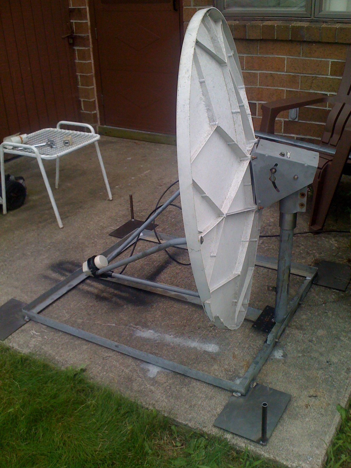

Nice home-made platform! Might be a bit heavy to move around, but then that is the point. Needs some paint though before it rusts.
I got some plates welded on so I can add a canvas cover to make it look like a BBQ grill so I can fool the manamgent at the apartments i'll have more pics coming soon. i got 62 channels out of that dish.

Edit: and if you're going to post a dish picture, remember that everyone doesn't know its brand and size.
that dish sits on the back porch is a channel master 1 meter. I have so called permission for the dish on my pole outside my apartment but it didn't say in the rule book that I couldn't add on. They banned satellite dishes but I got to keep mine but others can't. I tested out the cover material on my other dish covering up cband lbf and ku band lnb got a good signal quality its the same materia tey make boat covers out of here. Here in Angola they have everything for boats cause of the 101 lakes in the county.
