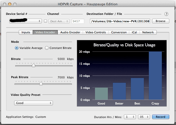

The other question is about recording and bit rates. The Hauppauge app has a lot of options to select when recording.
They are, using variable rate in the kbps range,
1. Good - 5 to 7
2. Better - 7 - 9
3. Best - 9 -10
4. Insanely Good - 14 - 14
Of course the faster it goes, the more it burns up disk.
Ultimately I will end up editing out the commercials and scaling them down from 1080i/60 to 720p/24. Doing that will save disk space. But I want to maintain a balance between the best possible quality but still keep a focus on saving disk space..

As a person whom has the original HD PVR and has done many recordings, you'll want to record in the maximum quality possible. You'll also want to have it set as m2ts format and the ac3 audio. This will give you the best possible recordings for your editing program weather it be FCP, Handbrake, ect. Reason you want to record in the maximum possible level is because any compression you do in your editing program can degrade the quality depending on the codec. As a suggestion on the final edit from your rendering, you might want to keep it as an m2ts format. That way, in case you want to save it to a Blu-Ray later on, it will be easy and you'll have the best sound possible for your archive.

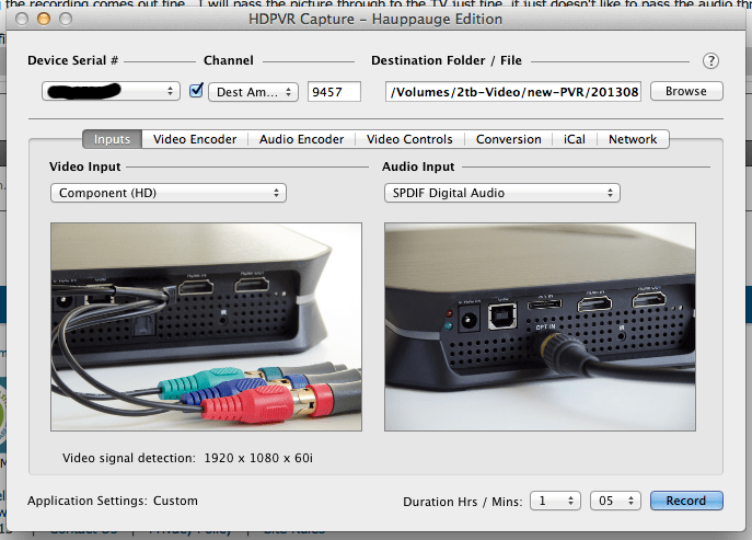

That is what I had to do. Nothing I tried would let me use the HDMI pass-through. I don't know why they even have that feature if you can't use it!
Screen Shot 2013-08-06 at 6.28.27 AM.png This is how I have it connected and working now.
Cool, thank you.. Sounds like good, solid advice.. :)

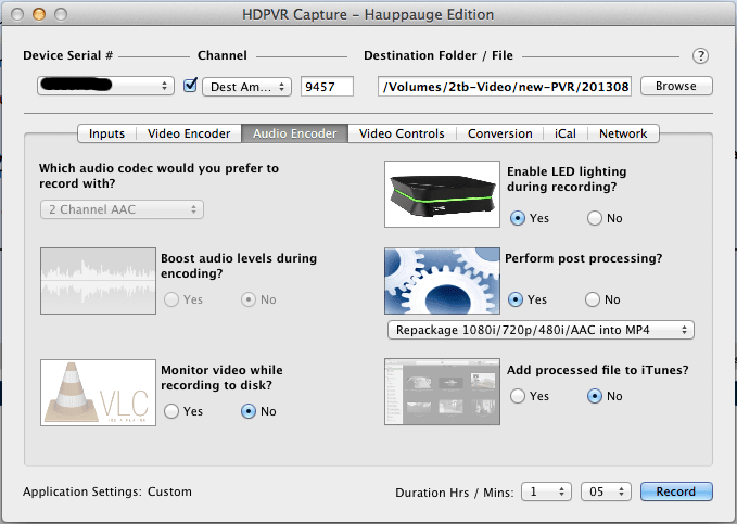

Oh, and here's what the options are it gives me on the audio
It won't allow me to change any settings on the audio recording. I am assuming it's because of the optical rather than HDMI input.
When I did attempt to connect via HDMI, the audio options were not greyed out and I was able to select them and change them to a few different options.
Once I switched to the component/optical it greyed out the audio settings.

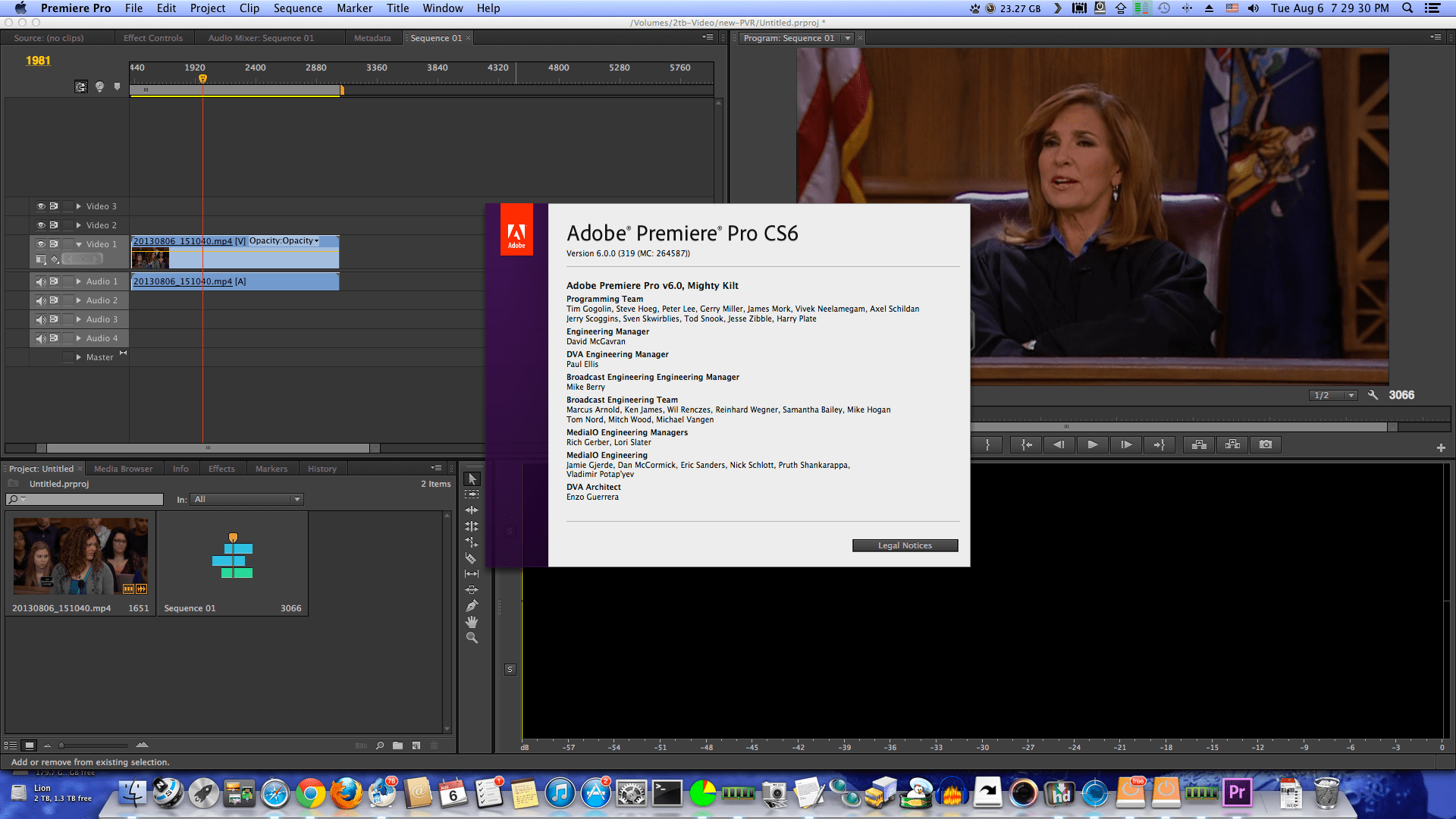

As for the post processing, I'm just experimenting with it. There aren't really any options you can select there.
One thing I did find out is that iMovie will not import the .m2ts files at all so that why I tried letting it convert them to .mp4 files.
I guess the other option would be to import them into Adobe Premier Pro. It seems to be able to read the .m2ts files. I'm just not very skilled with it. Yet.

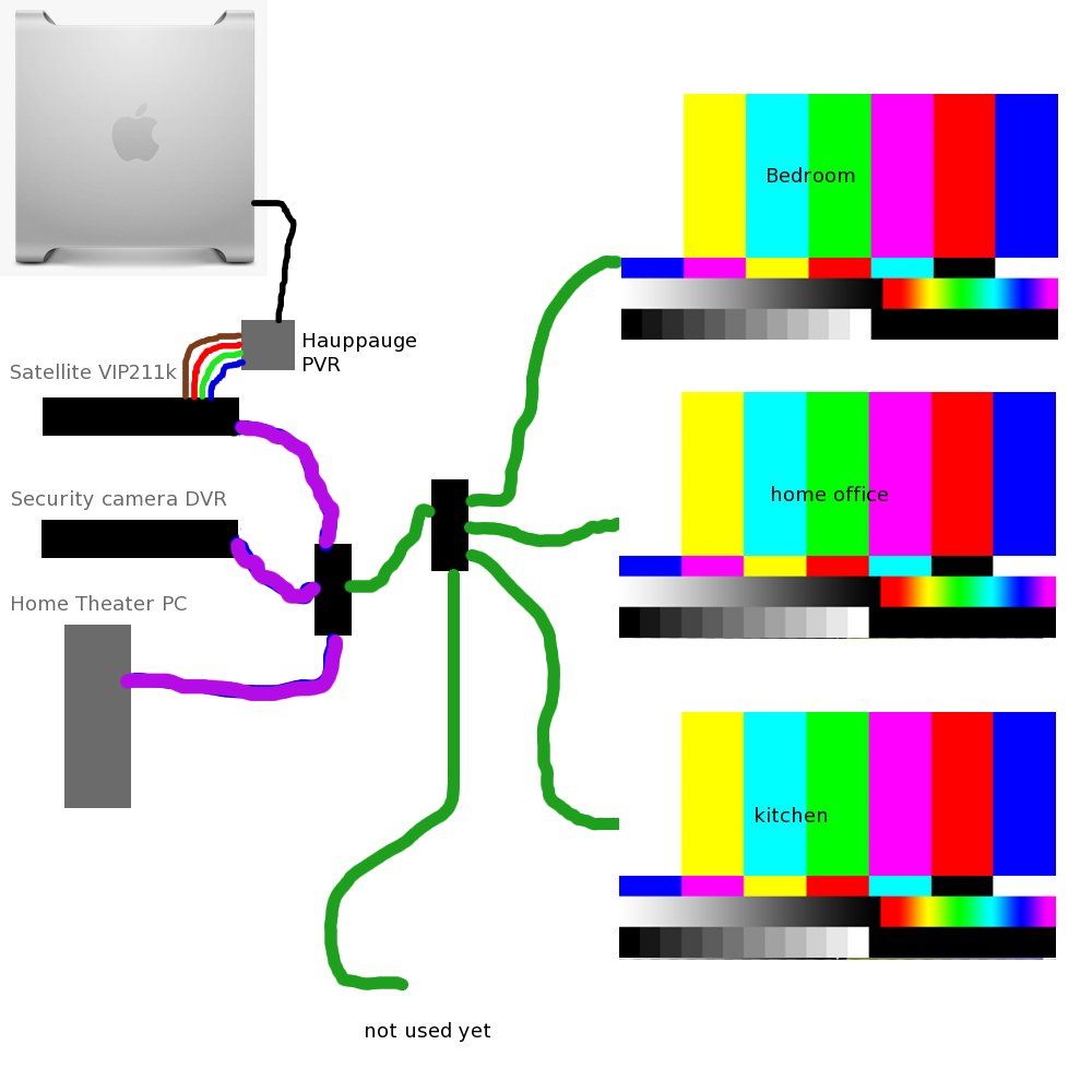

Well, I can't really do this because my system is a little weird. The VIP211K feeds into an HDMI 3 to 1 switch. That feeds into a 1 to 4 splitter.
With the switch I can I can select which video source I want to see. That goes to a 4 way splitter so that it then will display on all the TV's in the house at the same time.
I have never had any problems with this configuration. When I tried to insert the Hauppauge into it all and it didn't work, I thought maybe it maybe have to do with the switch or the splitter.
So I tried putting it in before the switch, then between the switch and the splitter then between the splitter and the TV in my office. No luck..
Then I tried putting it straight in the middle between the satellite and the TV in my office, without the switch or splitter in it at all. Still no..
So it seems that the Dish system does not like the Hauppauge trying to record through the HDMI. :mad:
Well, that's ok, I just hooked it to the component and optical on the tuner and that works fine. The HDMI circuit remains the way it was before and works just fine.

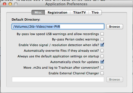

Oh, and as for some sort of IR blaster thing, I'm open to suggestions! Is there one I can buy that plugs into my Mac? In the setup there is an option for using an external channel changer. ???
I tried to use the auto-tune on something last night and while it did work, for some reason it didn't record audio. So I've decided that I'll have the tuner actually record to disk then play that back into the tuner so that in case the Hauppauge doesn't record properly I can try again and again until I get it right then I can delete the file from the Dish disk.
