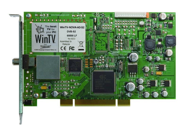

I picked up this Card at a ridiculous cheap price of EBay a while back; less than half the asking price. I got the card, remote, and the connected IR wire for the remote. I know next to nothing about computer software, but there was no installation CD with it as it was like new removed from a new computer. I did download what I could from the Hauppauge web site.
I installed it like you would any new add on to a computer and it says it is all working fine, but... I get no menu on the computer monitor and have no clue as to what to add to it? I connected a RG6 for testing that is straight through a 1x8 switch, but I cannot even get a menu to pop up yet, so did I waste $22?

A software package must be installed to control the card. Examples are Myth TV, My Theatere or TSReader.
Sounds like you may have installed the only the hardware and driver.
I have one of those cards. I used it with MyTheatre. It should come with a disk with WinTVv7.2 or close. The disk is the key to the software that you download from their site. The drivers are included with the WintV app. There is no support from Hauppauge for that card in the US. I had issues with certain FEC rates on DVBS2, other than that it worked good. I have a Hauppauge ATSC tuner I use all the time.
Okay, as I said, I did not receive any CD or software with the card, probably why it was so cheap. I will review some software to download. It does appear I only downloaded hauppauge drivers, so next step is a view. I did read somewhere on the net to not let windows media player load, as it will not work with the card.

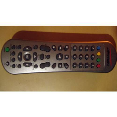

One complaint I have is the Hauppage uses a weird sort of remote and it's almost impossible to use a universal remote (the learning kind) to duplicate and replace their remote. Their remote is weak and you have to be close to the "eye".
