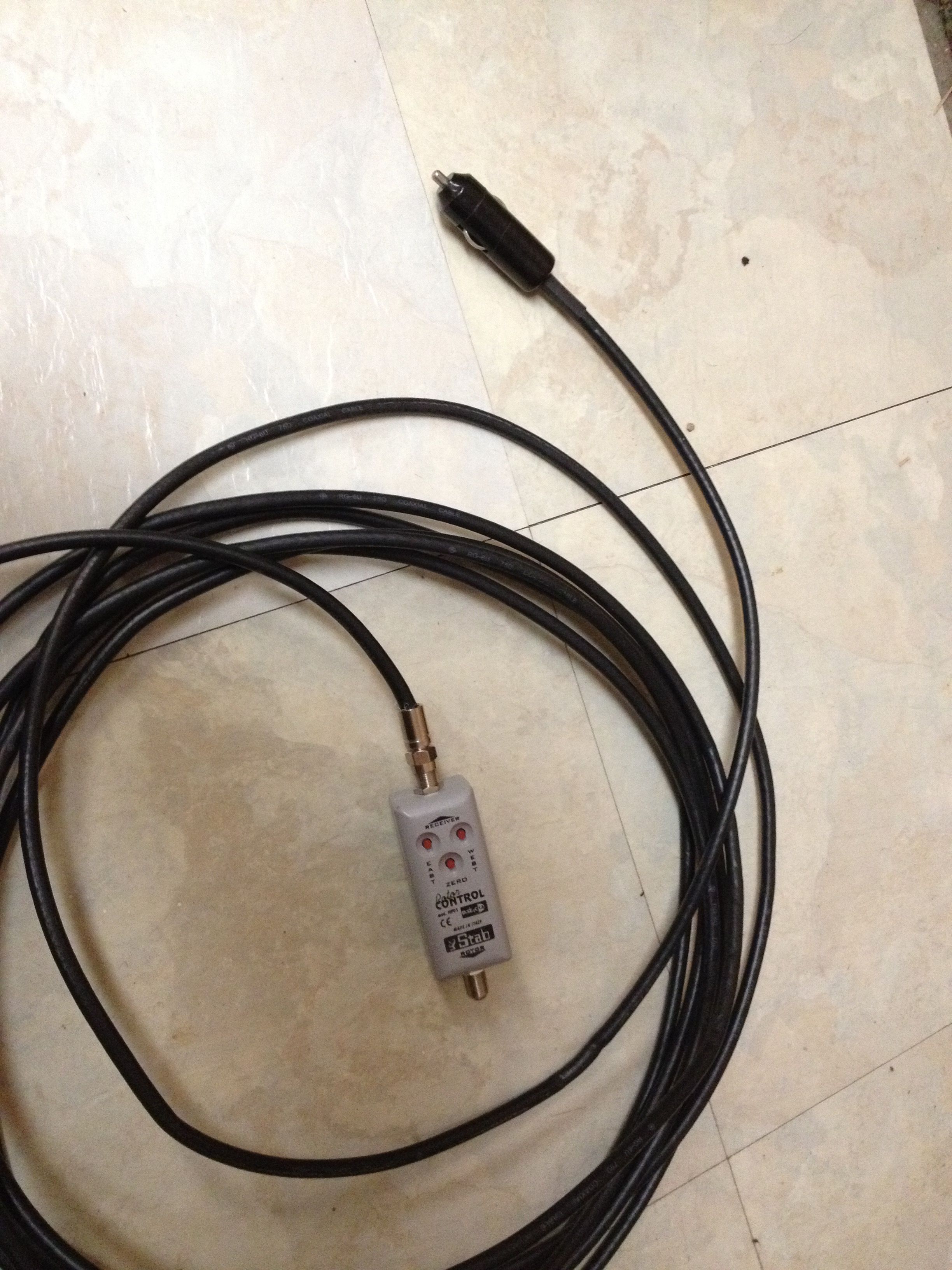

My dish is connected back to the house using the standard ribbon cable with two coaxial lines. I only use one of the lines for the LNBF, and the other is a spare mounted inside of a demarcation enclosure. I disconnected the receiver input to the V-box and connected the second dish cable to the the input connector. Using the spare cable gives me a "loop-back" to the dish for control signals to the V-box.

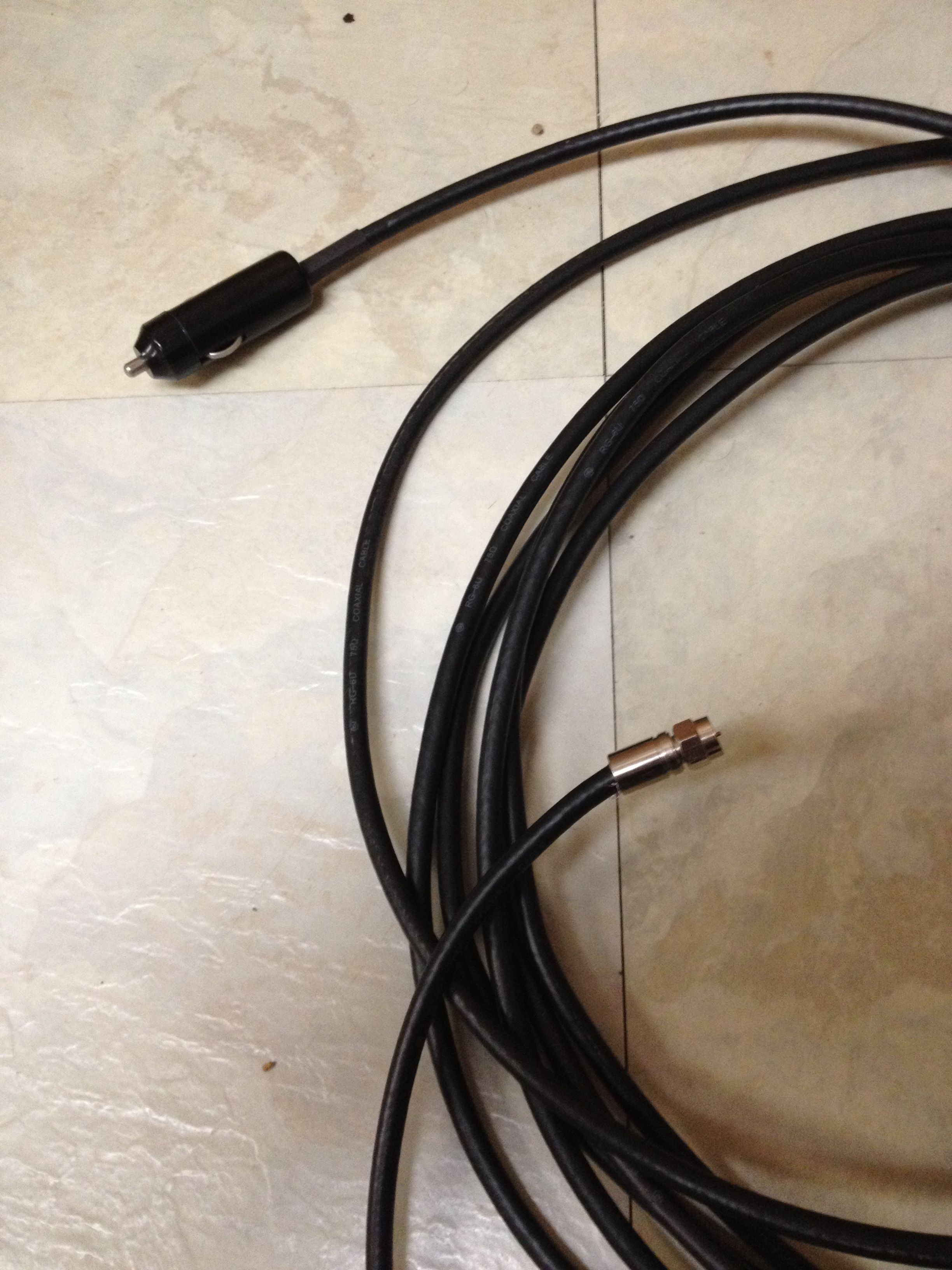

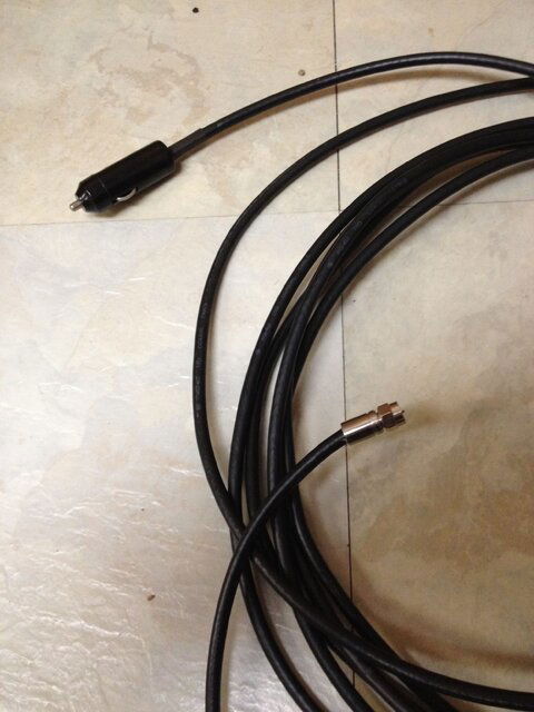

At the dish I connected a hand-held DISEqC controller to the second cable, and used an adapter cable to apply 12 VDC (center-positive) to provide power. (I plug the connector into the utility outlet in my utility vehicle)
Using this hack, I can control the dish actuator from the dish! I can now see that the dish has been knocked off of "zero" from a storm last winter, and I can also "gun-sight" the western stop at the top of the ridge by our house. All in all, it makes things much easier.
