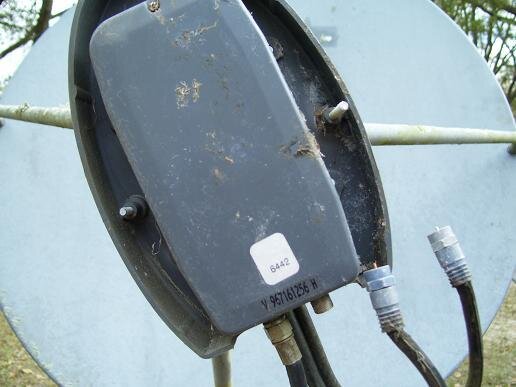

The outputs are not marked. How do you tell which port is H and which is V?
Euro,
I don't know that there would be a method other than hooking it up and testing it. You have a 50/50 chance to be right the first chance and 100% chance the second time! LOL :)
Sorry to be funny, but mine are not marked either and I wouldn't know unless I connected them and played around a bit. Unless someone has the same LNB and will tell you that the H is on the right or left side.
Radar
Yup....the serial # on the LNB had a V at the beginning and an H at the end...I thought it was just a serial number until a closer inspection revealed it! (duh):rolleyes: Thanks for the help guys! :D:up
Okay, so now post a picture of that location.
That way, the next time this question comes up, we'll just point to your picture for the answer! - :up

Actually FINDING dishes that are ripe for picking is the only TREATMENT. There is NO CURE!
For you, green one! :D

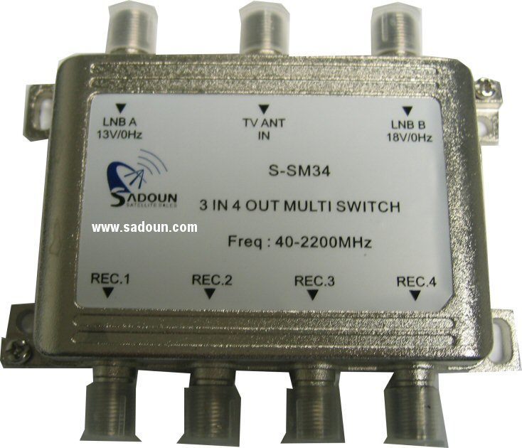

I just want to add, if you are hooking this LNBF up to a multiswitch,
Connect the H to the 18V, and
connect the V to the 13V side of the switch.
hmmm...I thought the markings (H & V) was on the other side of the LNB....at least one of mine had it that way
Maybe they are, Iceberg.
Show us a picture. :)
Hey, did you just answer 10 posts in 10 minutes? :eek:
Trying to set a new track record? :rolleyes:
Thanks for the nice picture, eurosport84. - :up
Thanks, Sadoun! This info helps me, as I will be rewiring my entire FTA system to use the P* LNBs, with the seperate H/V on all 4 of my P* dishes.
