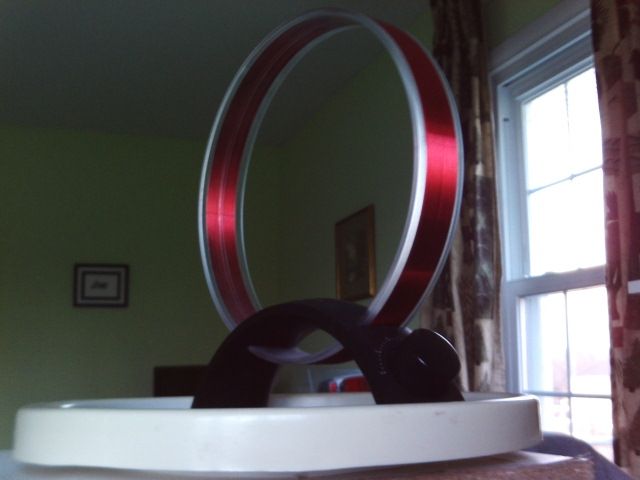

Been using the Grundig AN-200 loop antenna (bought from Universal Radio) placed atop a Lazy Susan (for easy rotation). The AN-200 is a loop antenna with a variable capacitor for BCB radios. You can place it near the radio if the radio has a ferrite loopstick or if not the AN-200 comes with a 1/8 inch jack to connect to the receiver's antenna jack.
Have used it indoors with a Sierra 303B selective levelmeter and a Yaesu FRG-100, works great. Nice thing is that you rotate towards the station for best results while nulling out other interference.
The AN-200 (sold under Eton, Grundig, Kaito and Tecsun brand names) is designed uniquely for AM broadcast (540-1600KHz) reception. It is a more stylized (and a little more tipsy) version of the AN-100 and offers identical performance.
