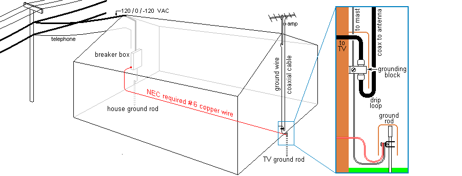

I'm running a ground wire from my coax spliter and attaching it to the ground wire coming from the antenna mast leading to the rod buried in the ground....i.e.
Mast>>Mast wire>>intersection of coax ground wire and mast wire>>grounding rod
Is this set up OK or do I need separate ground wires running from each item all the way to the grounding rod?
separate wires aren't needed, but i would recommend all ground wires be atleast 10 gauge, and make sure that electric is grounded to the same ground rod. The ideal situation is all utilities and your antenna share the one ground.
see pic

My antenna and coax ground block are about 60' from my power ground. I have a #6 run from the power ground to another ground rod at the coax ground location. There I have a #10 from ground block and a #6 from the ota bonded to the #6 at the 2nd ground rod. When in doubt, bond the hell out of it.
A little cornfused!!!!
According to the NEC, mast/mount grounding is to be done directly with no splices or connections between the mast/mount and the ground rod.
Yet, in the picture above it clearly shows the mast ground going to the ground block first, a run to the ground rod, then onto the whole house ground. What gives???
Or, is this simply a matter of "BONDING" the antenna ground to the whole house ground?
