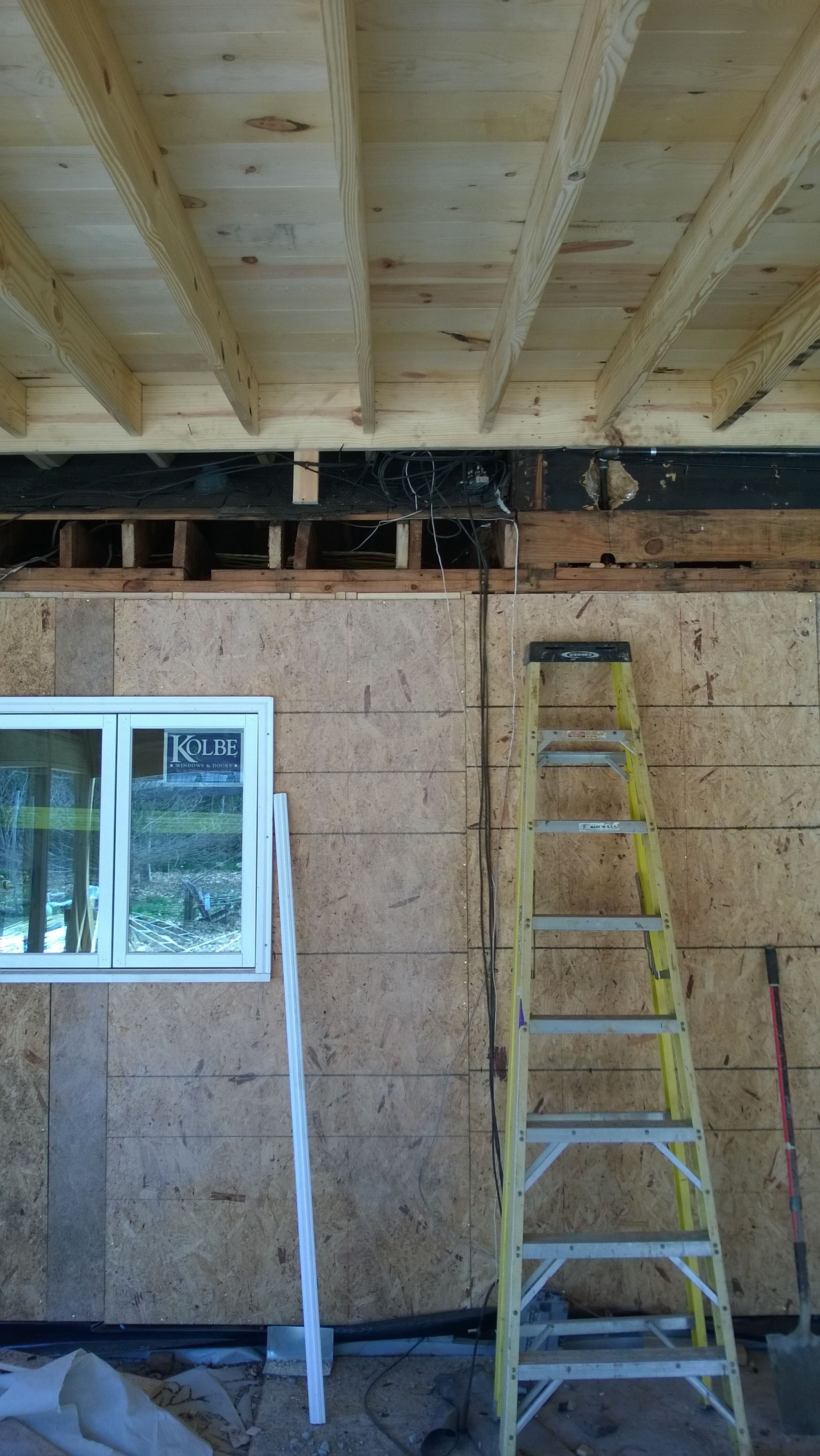

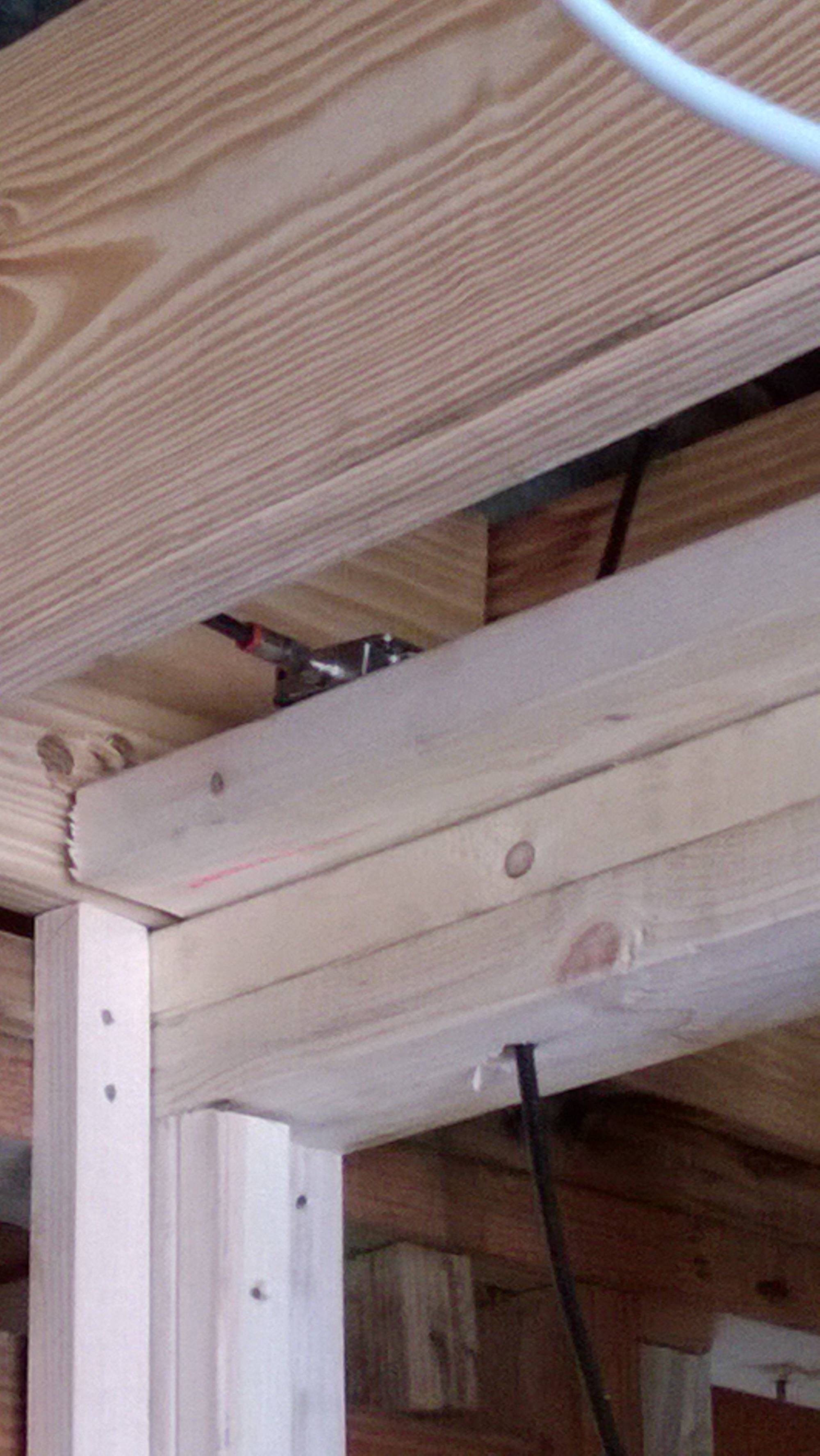

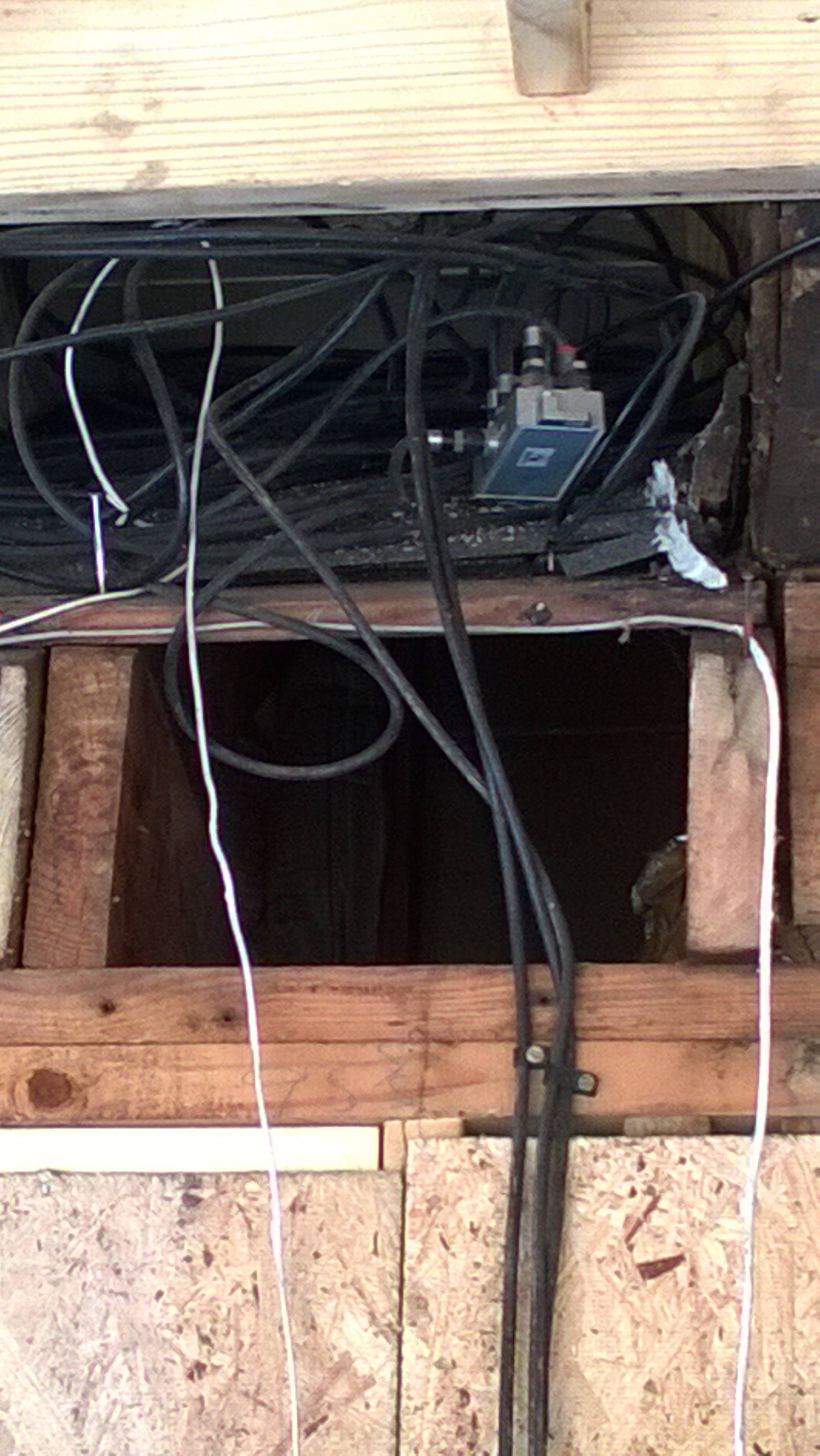

Well another tech came by over the weekend to clean up the cable.
The dish did not get grounded. Tech told the GC that it is grounded at the box.
The splitters will be concealed after the finish goes up. GC brought this up with the tech and the tech said he did not care.
Oh well, I am just the electrician.

That is more significant than the grounding thing. Hiding a component like that is just asking for a big rip out! The tech is not paid to think or care........someone should spec out relocating that splitter.....nearer to a power source and rerun the cables...inside the wall while possible. Not a big job now.
joe
