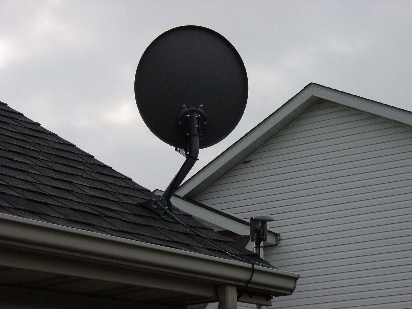

Here is a photo for you.

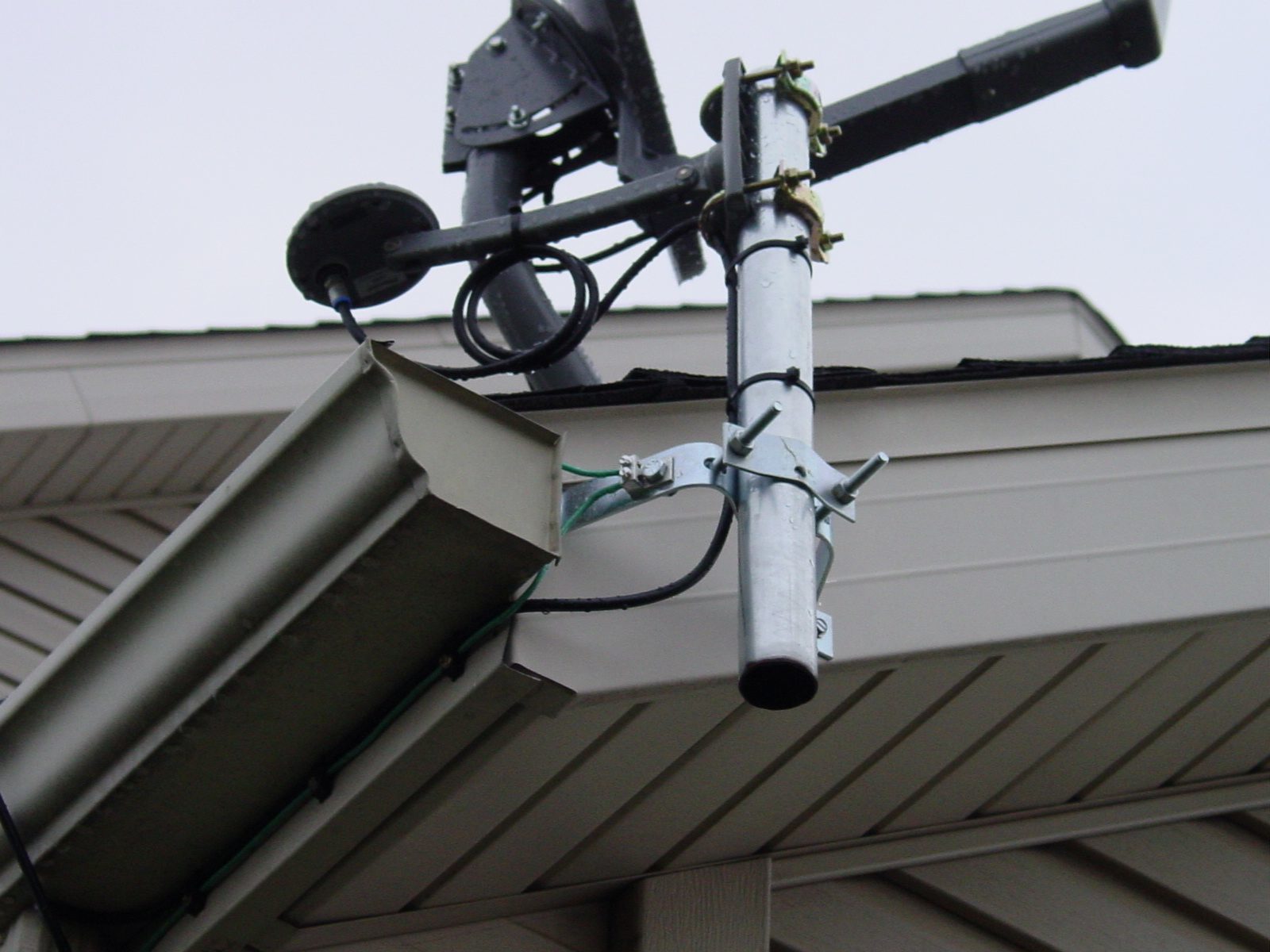

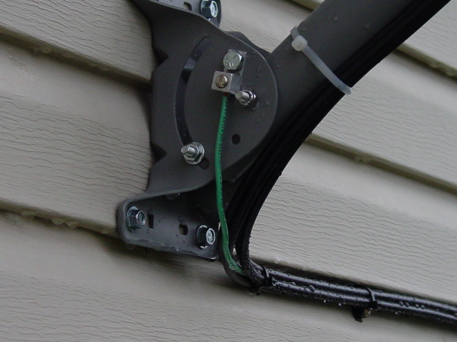

Is that OK to use 7/16 bolts? They are aluminum that I found at a local hardware store.
I don't see a problem with it. I think Tyralak was trying to say you're supposed to use those green ground screws as oxidation and galvanic corrosion are more possible with other bondings of dis-similar metals. Water usually aids that process. You have a good mechanical bond there so you should be fine. If you're any bit concerned about it, you might put a dielectric sealant on that connection to prevent rainwater from accelerating the process.
A good example of this concept is in older homes where the electrical wiring was originally done with aluminum wiring and the homeowner replaces an electrical outlet with one intended for copper wiring. The corrosion that takes place makes the aluminum wire lose its aluminum and become gradually smaller in size. Eventually, the aluminum conductor is too small to carry the electricity and a lot of heat is produced, increasing the risk of fire. Fire has happened in that circumstance. I'm not trying to scare you. You're ground connection should never carry any amount of current capable of starting a fire or even noticeable heat.
OK, thanks. Was concerned more with a good tight connection. Used flat and lock washers to keep it tight. Just figured that was better than the green ground screw. Is the green ground screw the better way to go?
Probably isn't anything to worry about either way. Just check on it every 6 months and see if any corrosion is building up around it. If there is, you can decide what to do about it then.
