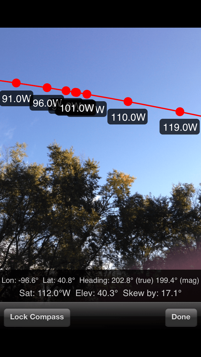

I'm in Lincoln, NE. I currently live in a second floor apartment with my dish on the balcony mounted to a non-penetrating desk mount as required by my complex. The ground floor apartment directly below me is available, and I'd like to move down. I used the DishPointer app to take this screenshot while on my knees on the patio. Does it look like I would be good? DirecTV won't come out and do a site survey without setting up an install, and I don't want to waste an installer's time. Opinions? The dish would have to remain in the non-penetrating mount on the patio, hence the screenshot from a kneeling position. I think I'd be okay, but wanted a more knowledgeable person to give me the thumbs up.

I'm in Lincoln, NE. I currently live in a second floor apartment with my dish on the balcony mounted to a non-penetrating desk mount as required by my complex. The ground floor apartment directly below me is available, and I'd like to move down. I used the DishPointer app to take this screenshot while on my knees on the patio. Does it look like I would be good? DirecTV won't come out and do a site survey without setting up an install, and I don't want to waste an installer's time. Opinions? The dish would have to remain in the non-penetrating mount on the patio, hence the screenshot from a kneeling position. I think I'd be okay, but wanted a more knowledgeable person to give me the thumbs up. Thanks!!! <img src="http://www.satelliteguys.us/attachment.php?attachmentid=92081"/>
clear skies! You'd be ok to switch to directv without any issues, as you know unless approved you'll be forced to use a flat cable to get in to the apartment though
As an installer I agree...those flat cables suck!
An alternative = acquire a 2 x 4 and cut it to a window width. Drill through the 2 x 4 with a 1/2"drill for the cable runs. THEN think duct tape and mortar and spray foam insulation to seal & lock the window for heat conservation.
No issue with the sat LOS,good pics!
