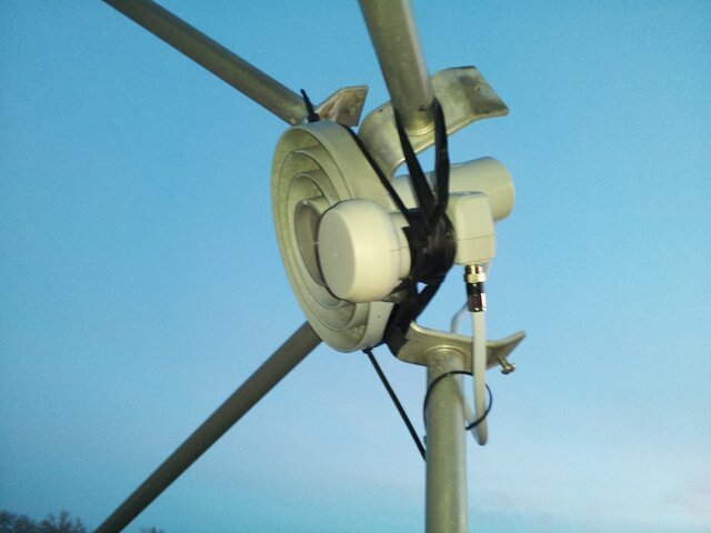

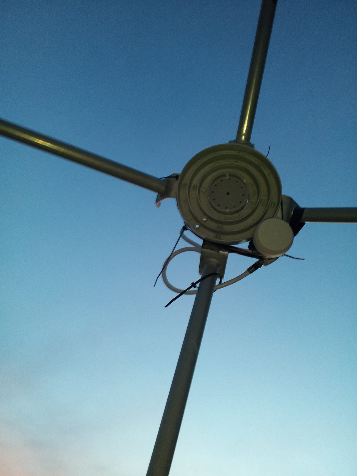

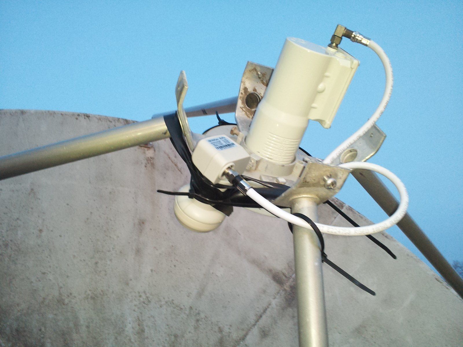

I have an extra SL1 PLL LNB, and duct tape:) I took the LNB out attached to the SAT HERO SH200 and held it up next to the C- LNB while pointed at 131w trying to get 125w. It worked! I ran in and got some black tape, zip ties and some rg6 and connetors and 10 minutes later I'm programming the receiver for KU off the big dish. Signal strengths are great, I'm getting COZI and all the odd-ball NBCs off 103 plus tons of stuff that was just threshold on the 1m geosat. LPBS is rock solid unlike before. I don't know why I didn't try this when I first put the dish up. I have about 6 degree offset at the sides of the arc and about 4 degrees looking south. I have an extra scalar which will get the side faceted for a proper mounting surface.

Even though your Ku LNBF sees only the middle of the dish, you could hardly choose a better dish!
And of all the LNBFs to play with, you picked a fine one! ;)
He he,,, it sees enough to way out-perform the 1m dish. Sweet.
