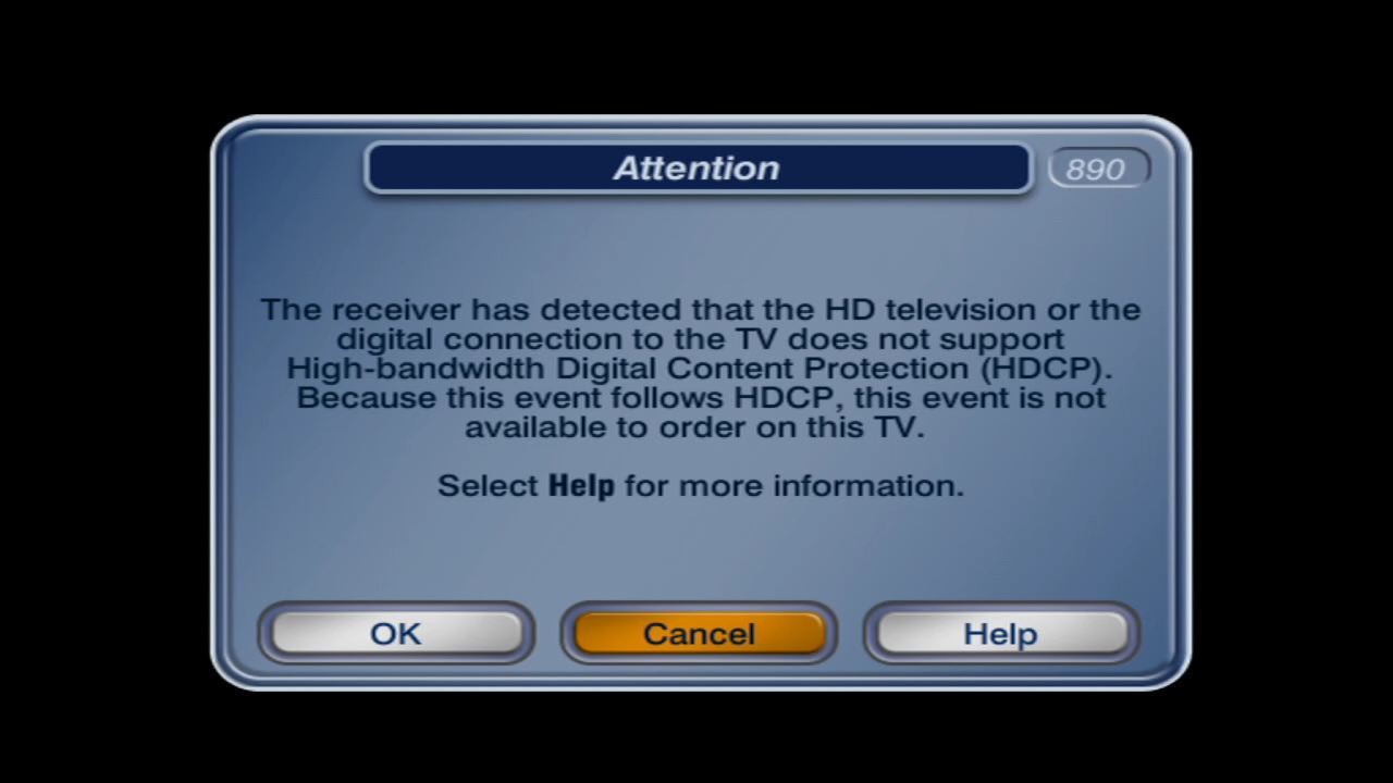

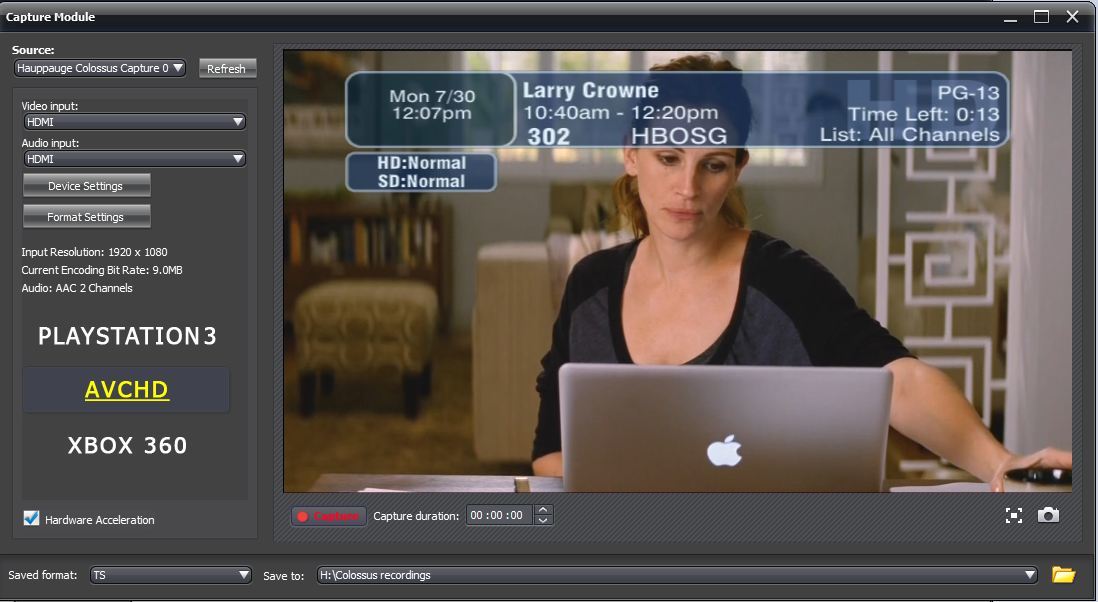

So the HDMI output from the DVR will work w/ the DRM programs from HBO? I've just put together one that has a Hauppauge Colossus capture card. Thought I would have to use the component inputs to record.

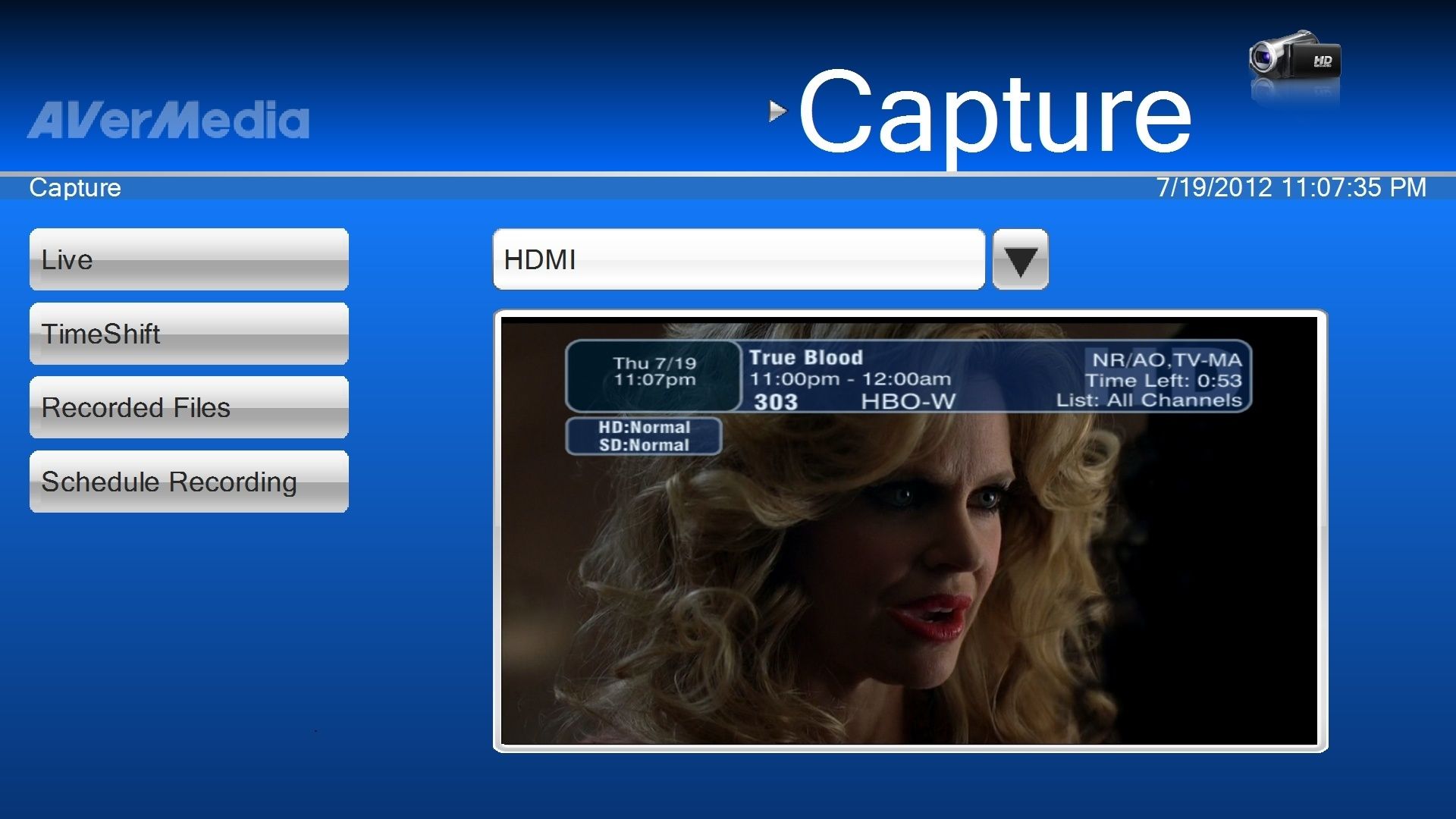

With the current drivers, I am not able to capture any of the premium channels like HBO via HDMI using the Hauppauge card without some type of workaround.
If you insist on using HDMI over component, you can use a HDMI-to-DVI>HDMI conversion box as discussed here. Only downside is the purchase of another box and a few more cables that will add more clutter to your setup.
