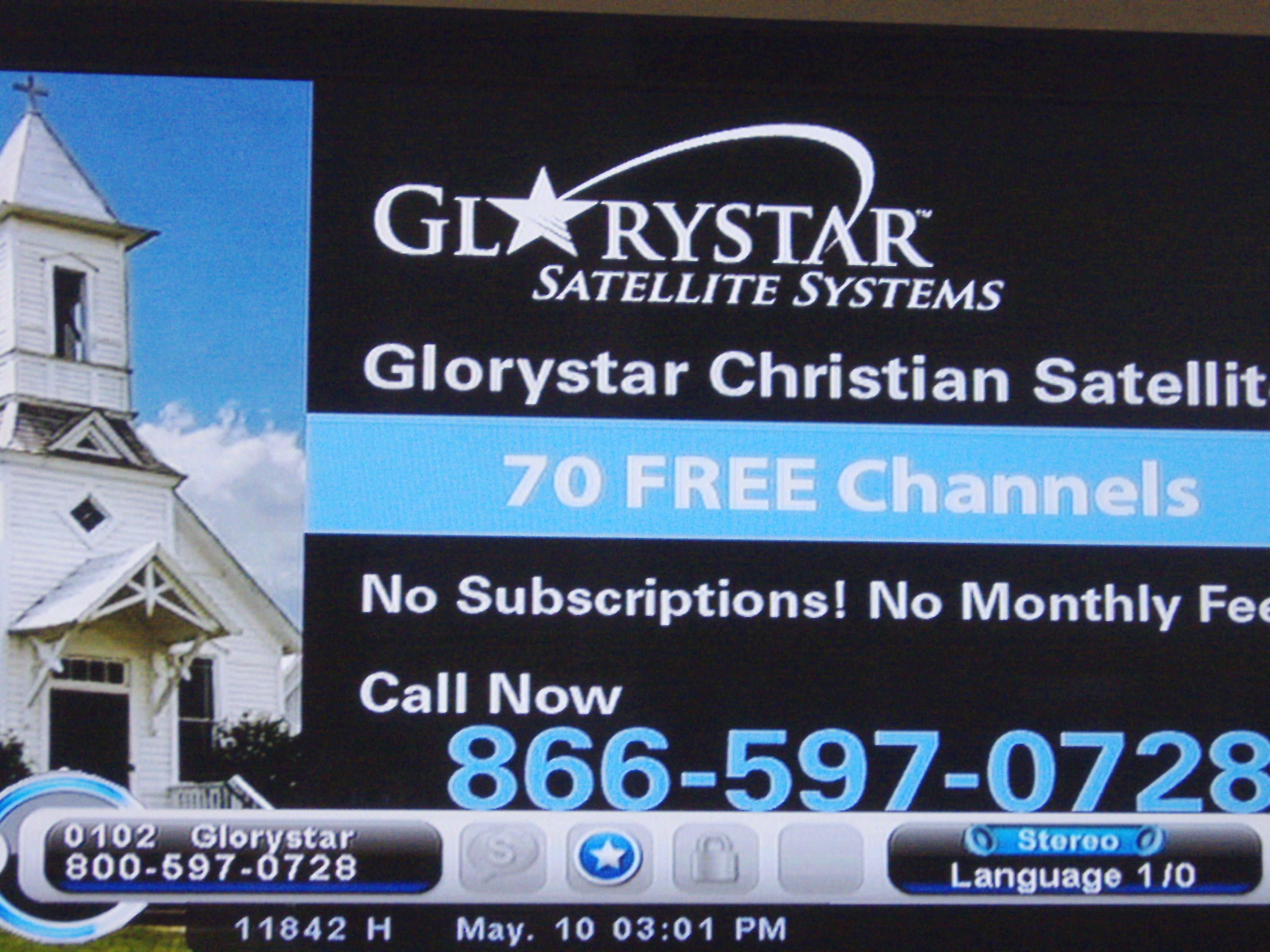

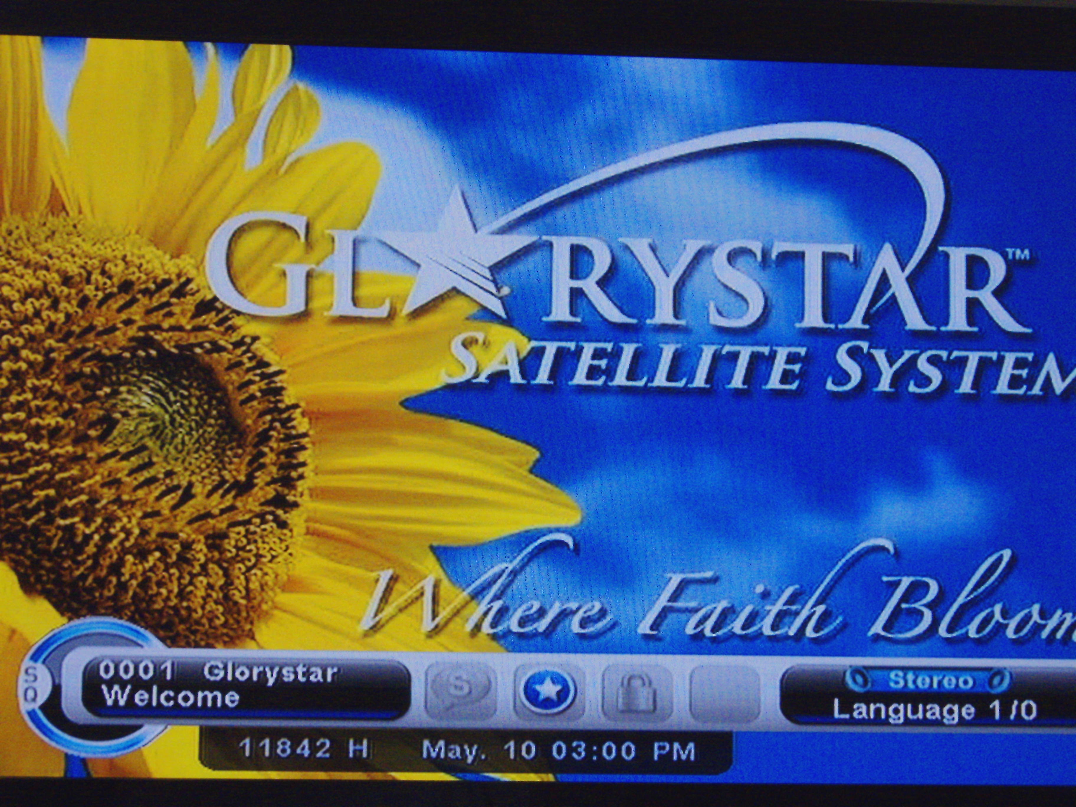

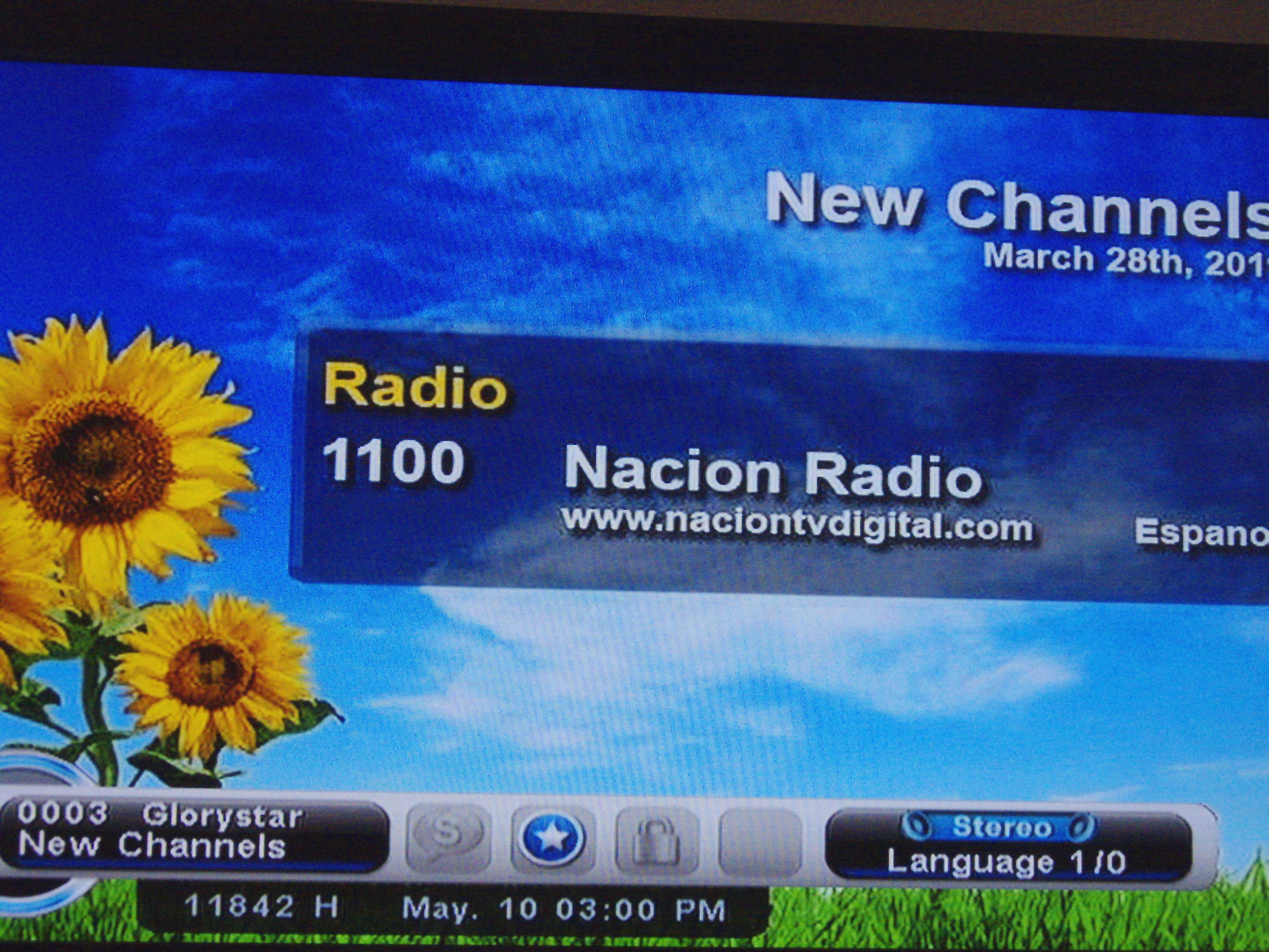

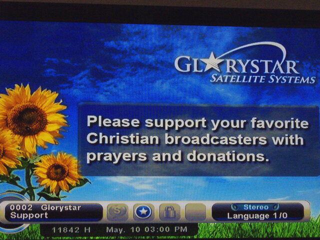

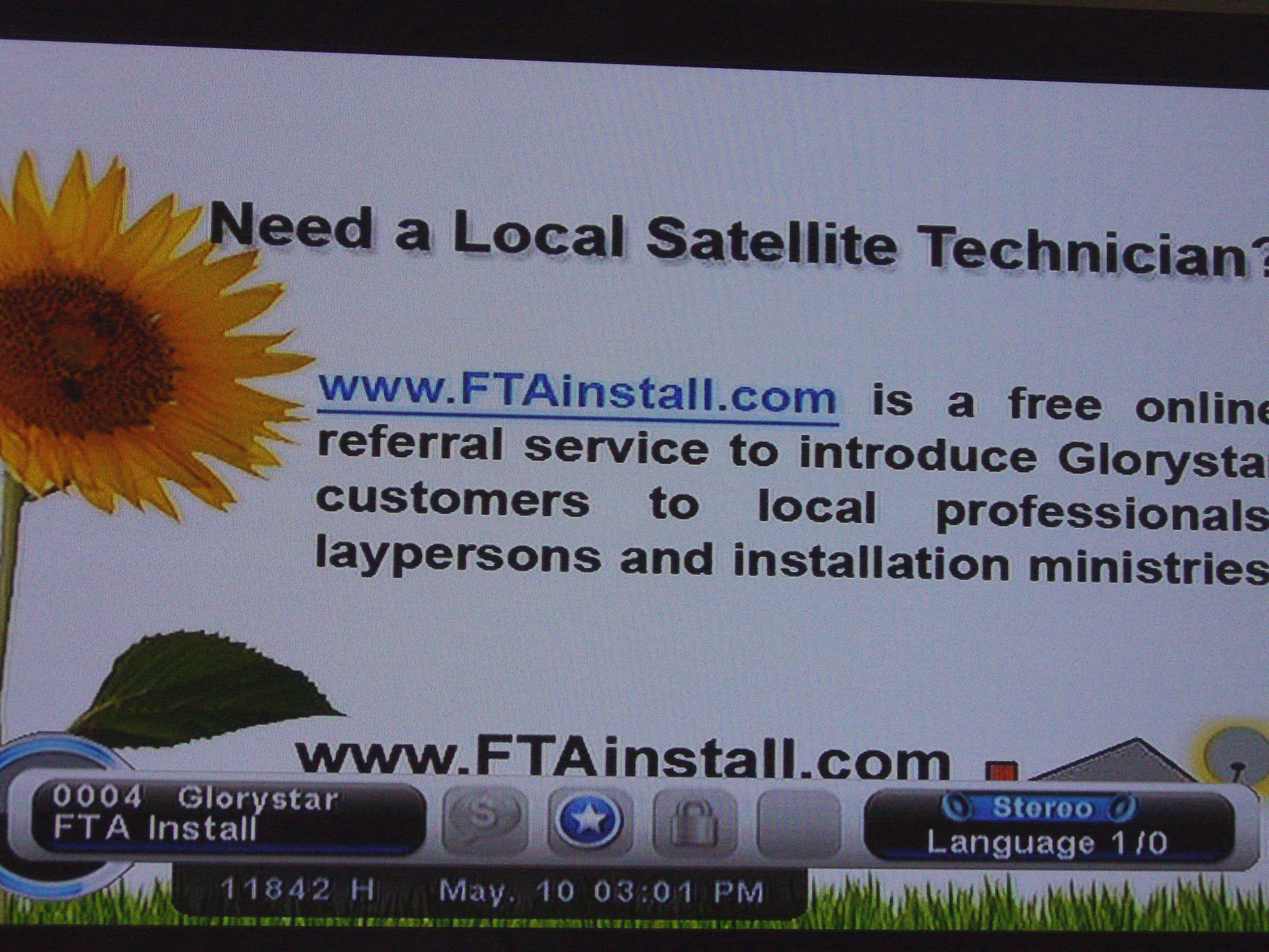

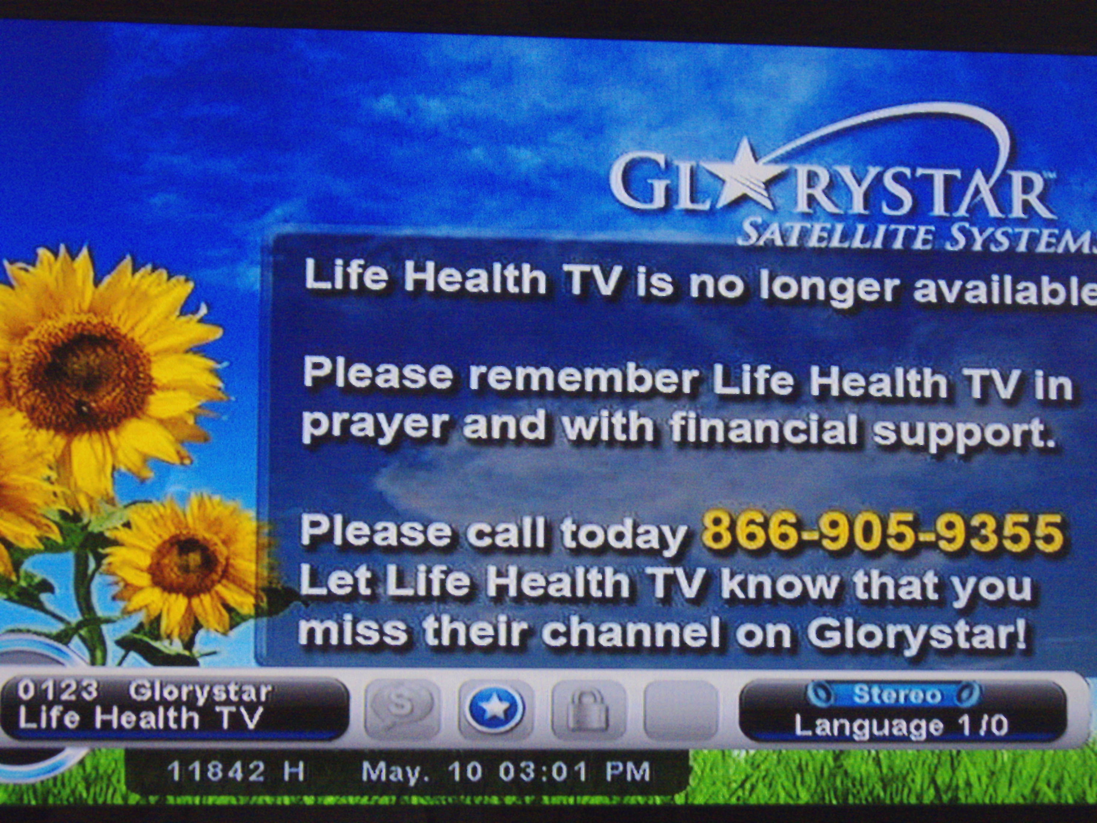

and this is more of a general question. I put my receiver in Glorystar mode to see how well it works and I'm very impressed. It logs the channels in that are Glorystar approved and its pretty much plug and play :) But I saw a few channels on the G* mode that the advanced one doesn't.
The 1st 4 channels (slates...pics attached)
The Glorystar slate
The slate that a channel left satellite
All of these show on 11842 yet they dont scan in on the advanced (hobbyist) mode. Is it something special that the G* mode has?
I did see a channel log on the advanced mode in the radio section as "SATAV"..no audio, no video. TP 11842. What is that?

Those 4 or 5 "channels" are static loads into memory and only look at the TP for time update. (maybe to check for software also.) Oh, it looks like you got 6 static channels. There may be more information on the Glorystar forum --- or maybe Brian and I covered it in PMs.
Those 4 channels slate channels are virtual channels-- they are downloaded with the firmware and are displayed from the receivers memory.
interesting they are attached to the firmware. I thought it had to do with the G* mode?
The Firmware version for the DSR200 is currently 1.37. The Channel List version is currently 1.57
The previous posts are correct. These images are part of the OTA-SSU TS stream that we have looping 24/7 on satellite Galaxy19, transponders 11842 and 12115 and are downloaded at any time during a manual update or with the automatic weekly Channel List updates. The images are not firmware embedded.
The images are displayed when the receiver is tuned to a channel with the VPID set to the JPEG image name (example 9901.JPG is the image displayed on Glorystar channel 1). The images could be called up in any mode, but they are primarily used for populating the Glorystar informational channels 1 - 5 and to let viewers know about channel changes and upcoming events.

no these arent G* dupes. These are those Arabic type channels. The G* ones log fine.
The way I understand it is that those channels are part of the firmware and only displayed in Glorystar mode.
you are right. I hooked up my C-Band LNB to it yesterday and hadnt done the factory reset yet (to go into advanced mode) and those 4 stations still showed up with 0 signal ;)
