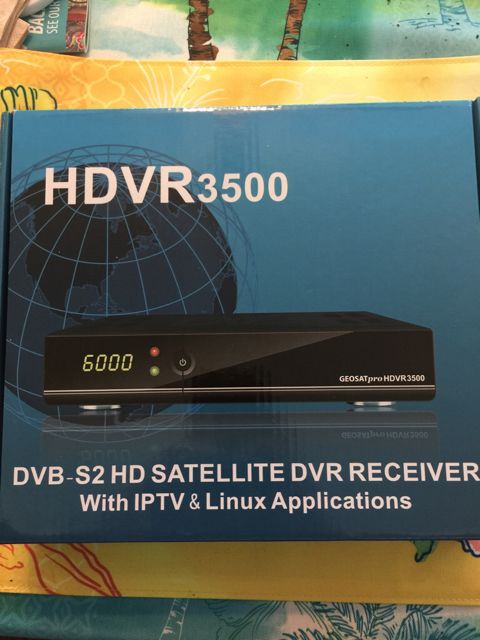

Geosat HDVR 3500 came in today

Got mine today too. Time to go play!
