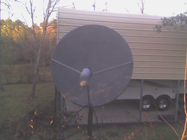

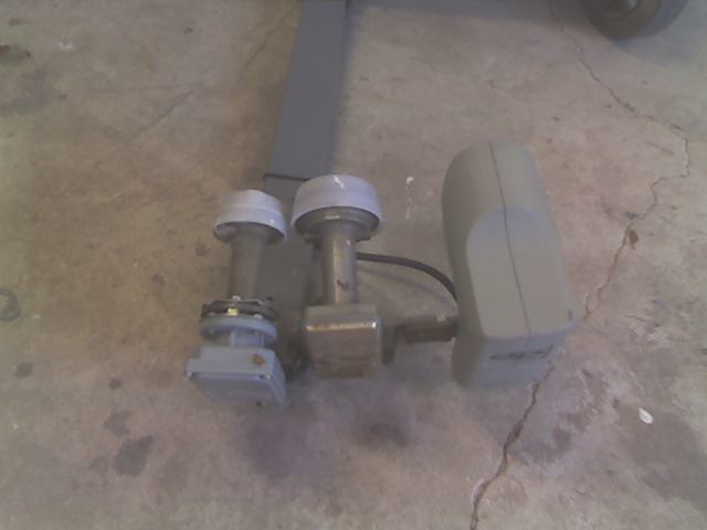

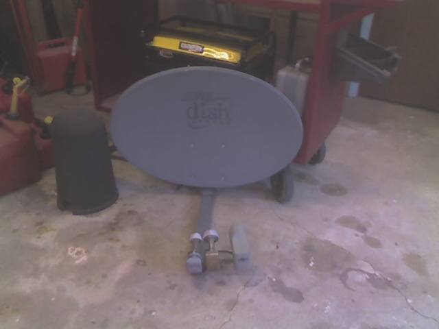

So far I have gathered a few parts -- other than the primestar dish, is any of the rest of this stuff worth keeping.
Also -- is the lnb on the primestar dish good for fta

Yes, lot of folks here use the Primestar dishs and LNB for FTA.
There are many discussions on using the existing LNB, replacing it, living with it if it's a bit odd, putting extra LNBs beside it, etc. :)
What's the diameter of your particular dish (should be some mold markings on the back side)?
That DishNetwork SuperDish has a linear LNB right at the end of the arm.
It's not a big dish for weak FTA, but it'll do for medium usage.
That's assuming you don't mind having a second dish up in the air.
The two LNBs off to one side are circular.
Depending on your interest, one of them could be used for NASA or Angel on 119º...

The Primestar LNB works fine for FTA...Use 2 of them :)
The SD will work for most signals...you may not get the best signal quality due to the smaller size but should work :)

If you want to replace the LNB on the Primestar, you can use the stacked linear LNB (FSS) from the Superdish. The feedhorns on both dishes use C-120 flanges.
If you do decide to use the Superdish LNB, either on the Superdish or on the Primestar, you will need a blind scan receiver to find the horizontal transponders (or you will have to figure out where they are by subtracting the horizontal transponder frequency from 24600). The Dish stacked LNBs send down both polarities on a single cable by stacking the horizontal transponders in a frequency range above the vertical ones. Some newer receivers have a DishPro (DP, stacked) setting built-in.
