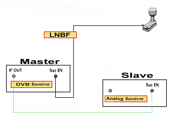

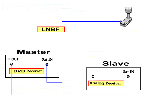

Does anyone have a diagram or can tell me how to connect this to the Fortec Mercury II for Ku only?
Will this work with my DVB system, as in the signature.
And, once I plug it up and turn it on, do I just select any satellite? (Keep in mind this Uniden 4400 has not been updated in 5-6 years so everything is either G, T, E, S, or F as the letters like G5 or S3....)
And then once connected and setup, do I do some type of scan thru the Uniden or the Fortec?
If slaved off of the Fortec, do I have to go thru the Fortec menus to add this Uniden 4400 onto it?

loop out of Fortec into UNiden. You'll need 2 inputs on your TV/VCR (one for Fortec one for Uniden)
yes
as long as you are on KU its irrelevant. I have Galaxy 7 logged in my Toshiba for all satellites BUT SBS6. SBS6 is logged separate because its frequencies are set up differently
don't understand what your asking. Analog has the same frequencies across the board (but SBS6) so channel 4 on AMC9 is the same as channel 4 on G11 (polarity might be different)
nope. All the Fortec is doing is supplying the power and polarity to the Uniden. All tuning on the analog is done on said box :)
Thank you very much, guess I will go play for just a few minutes...the braves and the race have me occupied for now, but thank you alot.....:up
Quick diagram!
