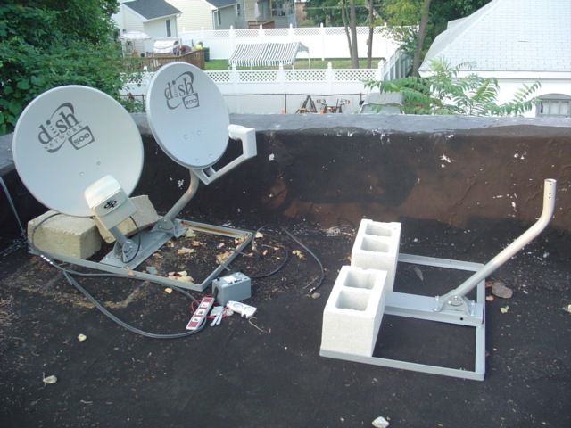

Well I ordered a FTA system from Sadoun with the rcvr,dish, and a motor. Should be here tomorrow or the next day. So I started to prep the area where I want to put the Ku dish.
Wile I was at it I put up a dishpro dish for 119/110 for NASA TV and a legacy dish for 91W (if those CA radiostations are still on there). NASA is all set and a guess the dish300 is pointed at 91W..ill find out when I get my FTA recvr.
Which brings me to my 1st of many Q's ill be posting here... Will an old DISH SW21 work as a FTA swich so i can swich between the DBS LNB and the Ku LNB? Im betting i have to get a "real" switch for this.

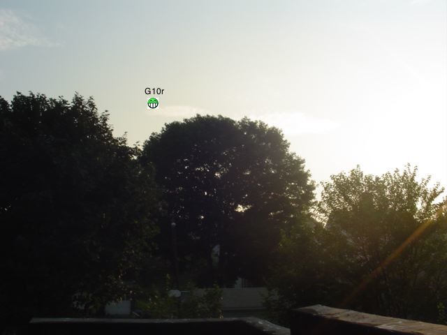

I snapped a few pics of my ghetto mounts and my LOS for G10R. At least what I THINK my LOS is.. :rolleyes:
Tomorrow I have to get some more blocks... :mad:
I hope the Ku dish doesnt flex the wimpy echostar/Direct mast :eek:

Nice pictures! If you look closely you can actually see G10R :D
