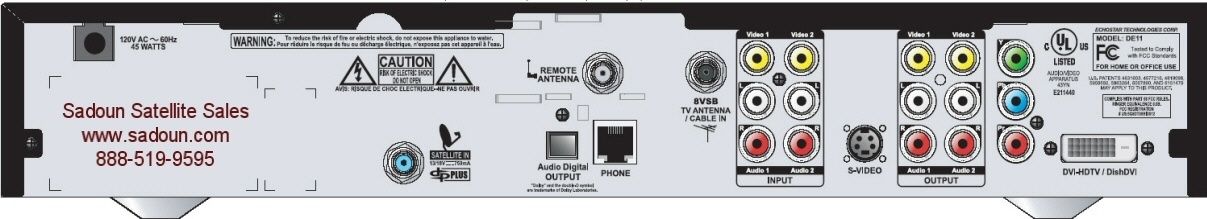

Yes you can get the FTA "LOCAL" PBS HD channel using the ATSC feature in your DN HD receiver.
To do that you will need to use a regular rooftop antenna or an HDTV capable indoor powered antenna. You hook it up to your DN HD receiver "TV Antenna /cable input". Then go to the setup menu>LOCAL Channels>and scan for digital channels.
