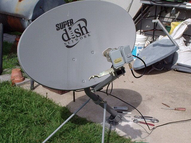

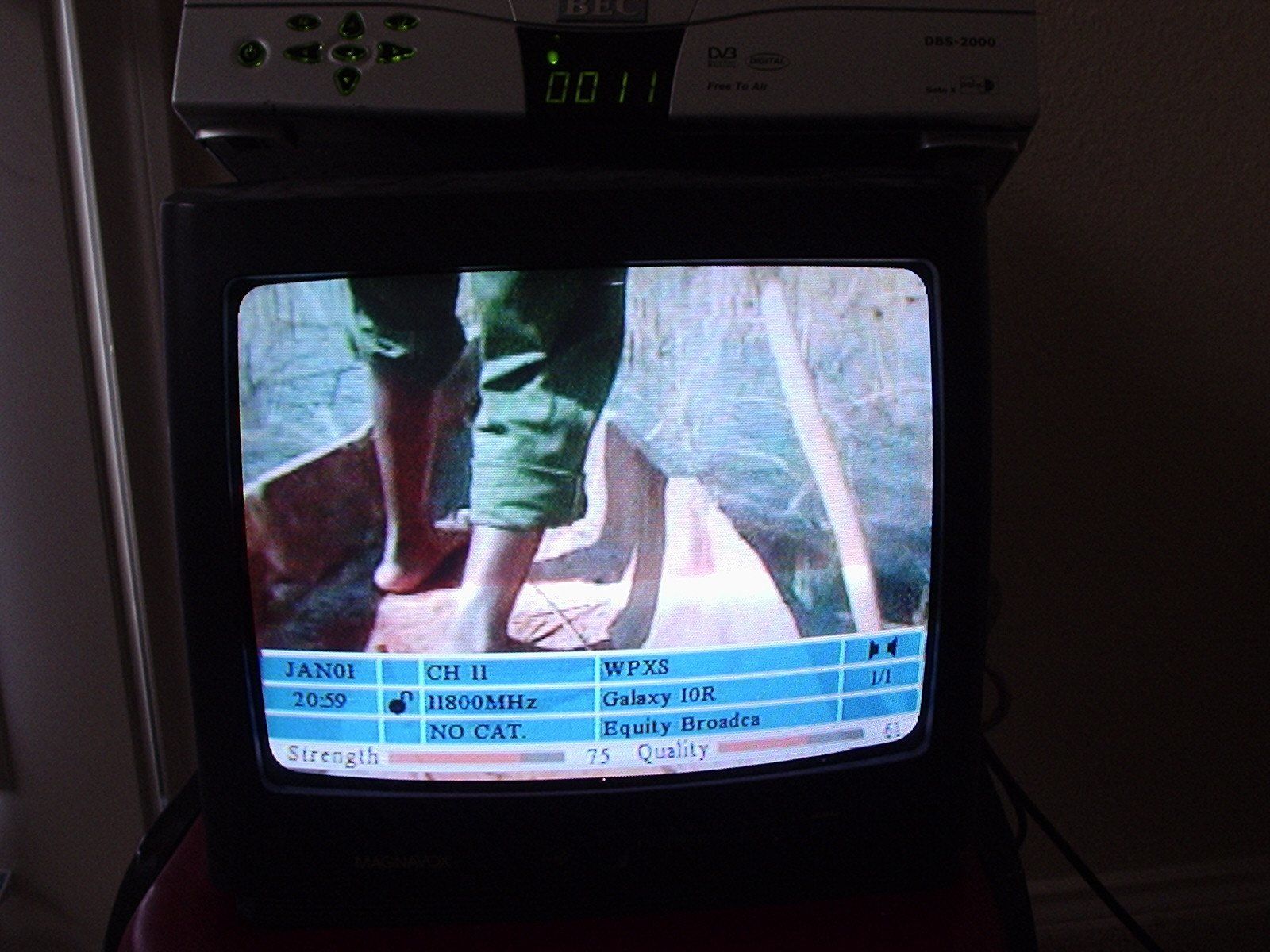

No work today, so I pull the S.D out from storage and set it up and see what happen. Turn out it a O.K. but not pefect. Because its at the out door, pictures not very good, last two TV at indoor is much better.

Thanks for posting, nice pictures! (I see your grill in the back, bet that gets LOTS of use in TX.) :)

Is that a PrimeStar dish in the background ? It looks to be larger than the Super Dish ?
Wyr
Wyr

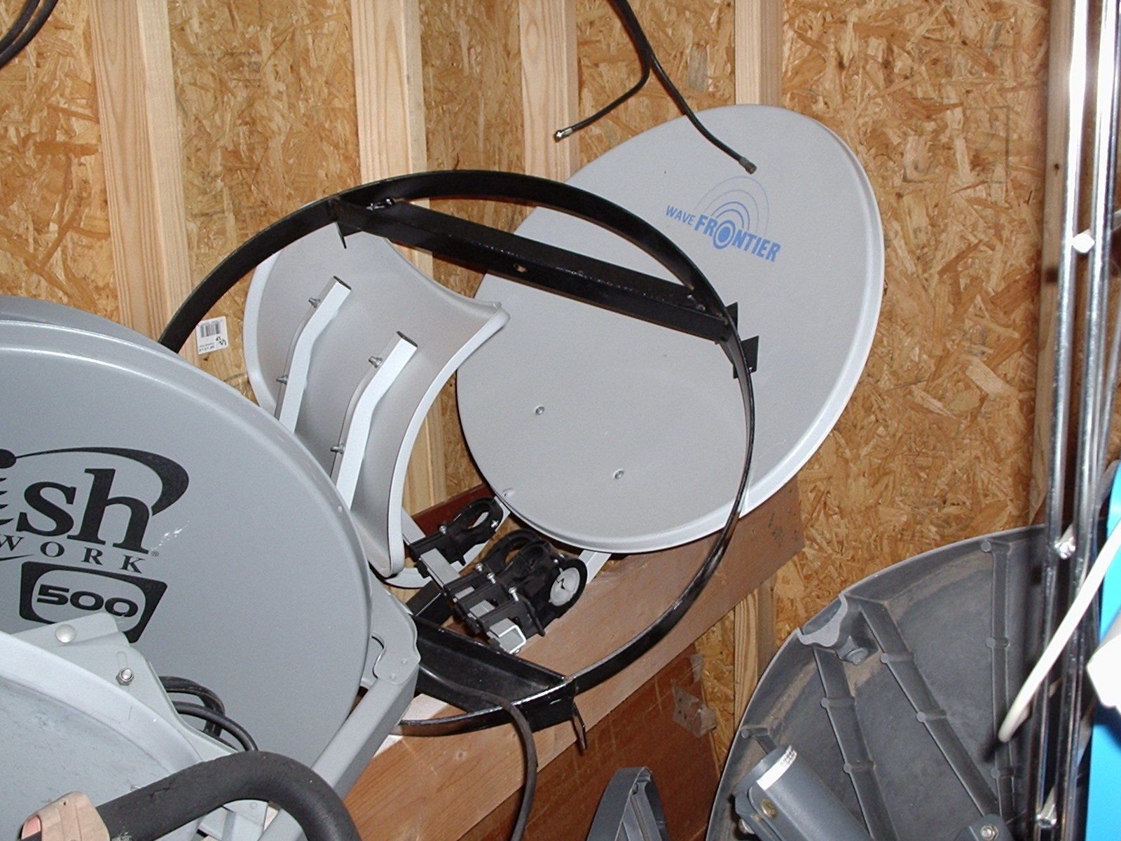

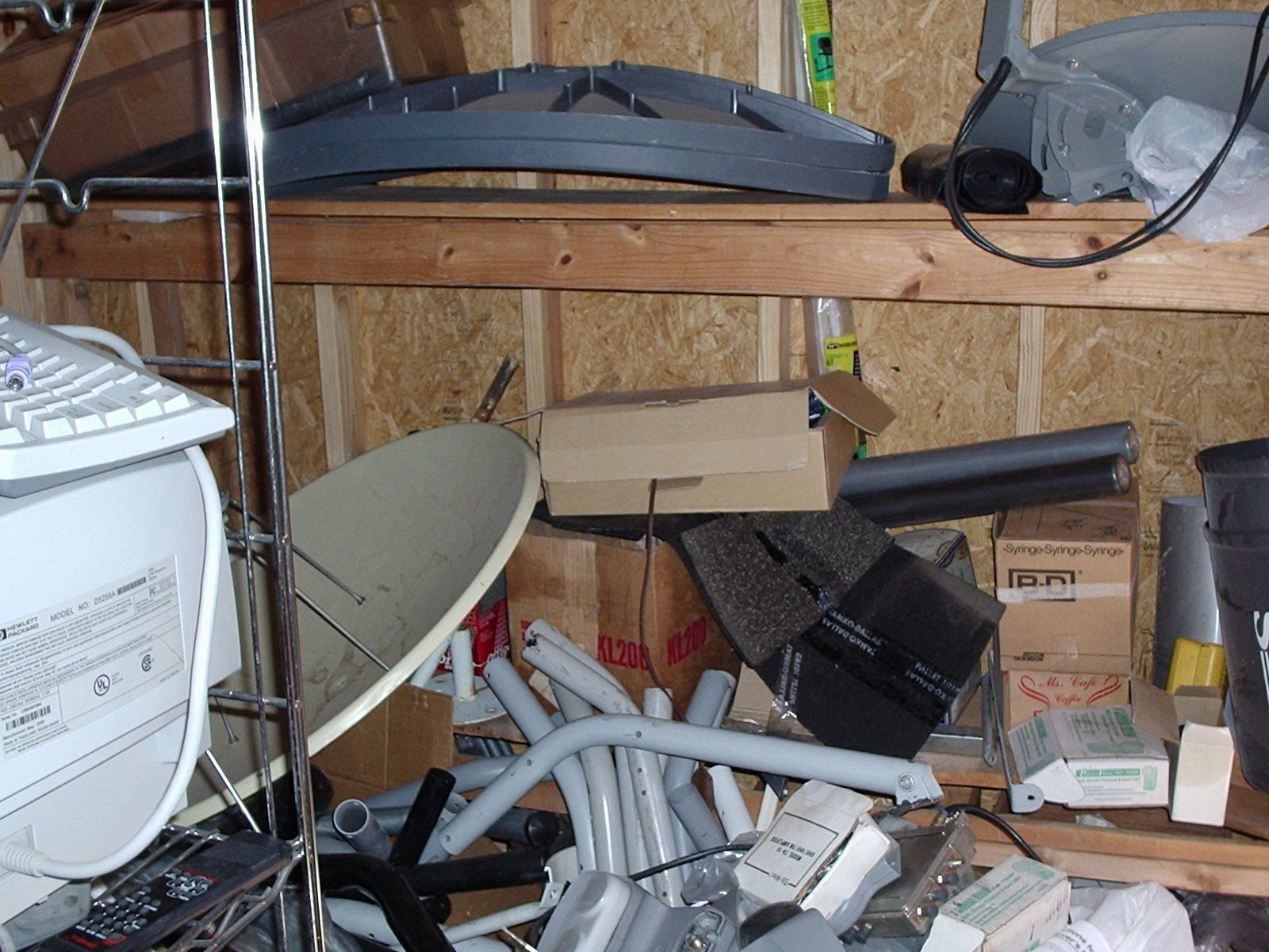

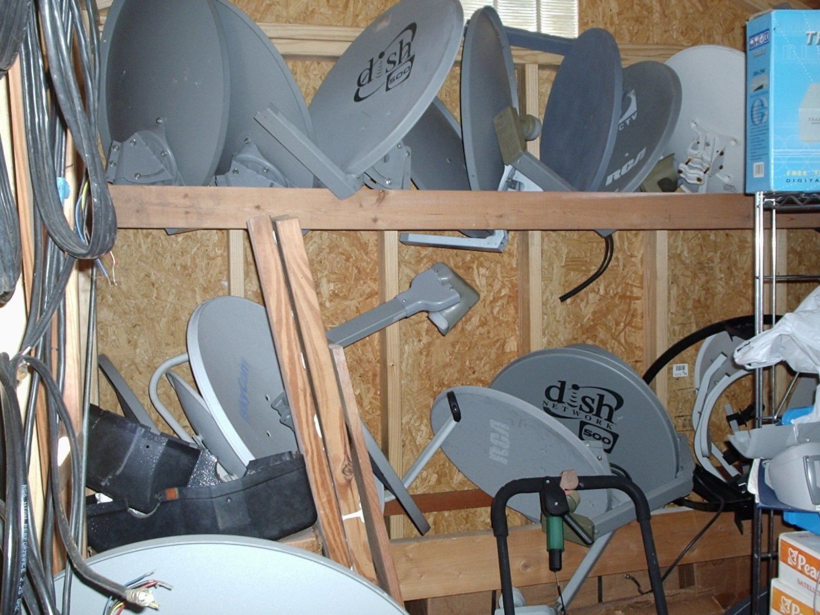

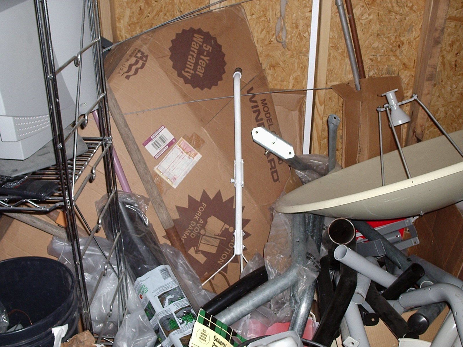

Yes, its the Prime star dish, its 2 inches bigger then the S.D. I still got some supply on this, but most are left at old house or lossed, but still I got some more left to put at my storage at back yard.

As it was getting dark last night I found my old SuperDISH and since I had my receiver, sat meter and TV outside I decided to see if its possible for me to get G10R using it.
Just holding the Dish I was able to hit 121 with no problem but was unable to his 123. I am thinking I should be able to hit it. I have a feeling that it may be because of the skew. As when I was scanning the skies I only got 121 if I twisted the dish to form a fake skew. Will the SuperDISH work for 123 if I can see it?
What settings should I use for the LNB on my Coolsat 5000?
LNB LO would be 10750
121 is STRONG especially when you are trying to get 11720 (the TP with Retro Jams)
Try and aim with 11800 V 26660...that is the main G10 TP and doesnt interfere with 121 :)

Dishpro takes the H transponders and makes them vertical so even with a DP FSS LNB, G10 is mostly V polarities :)
I like the graphics on the BEC receiver. It is nice to see both the quality and level signal strengths as well as more detailed information about the transponder.
