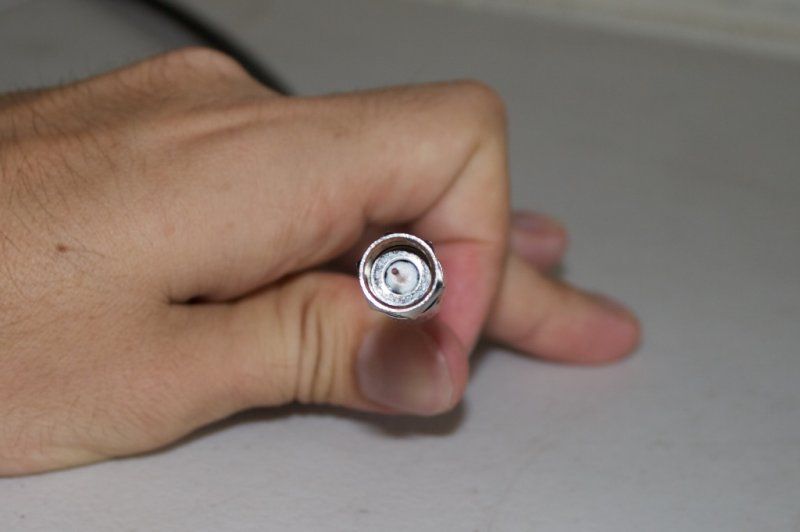

775 is a SWM communication error. With your receiver list, you should not have a tuner count issue, however SWM communcations happen at 2.3 mhz, and errors can be caused by signal drops or reflections. These could be caused by a bad F termination on the wallplate rg6 jumper, or behind the wall plate, or at the splitter. The RG6 Dielectric (white stuff) should be flush with the bottom of the F fitting, not recessed or protruding.
