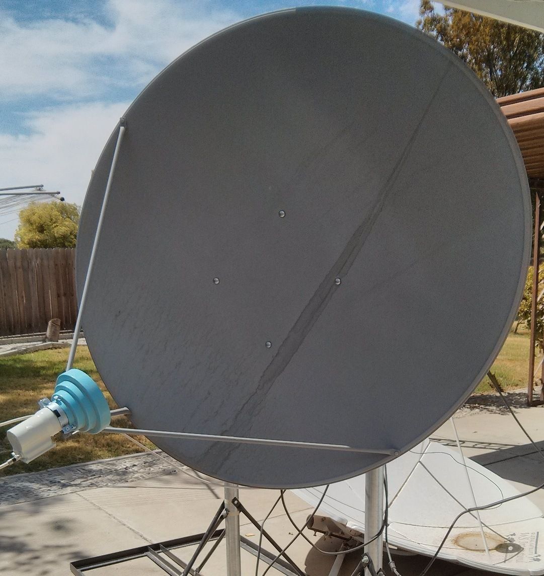

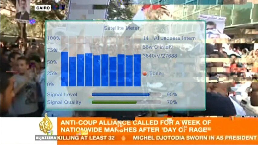

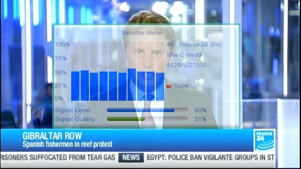

Checked out 58w on my motorized 1.2 with a geosatpro c1 and I barely get a lock on both channels. Al is breaking up bad - I'm guessing I need more signal with the 7/8 FEC??
But then I just slapped on the lnb this hot afternoon without any further adjustment to focal distance, scalar, elevation, blah blah :p . You'll probably do a better job than me fine tuning in these channels.

Strangely i do not receive France24 on my current 58W set-up but both DW work fine.
I had it right next to Al Jazeera.
Also it is marked as "Favorite". so it had to work before.
Any idea ?
Did it move to another tp?

Rescan. It is there on 4120 V 27500 SR.
