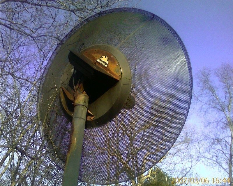

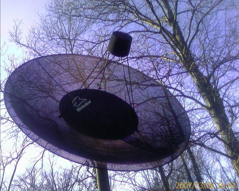

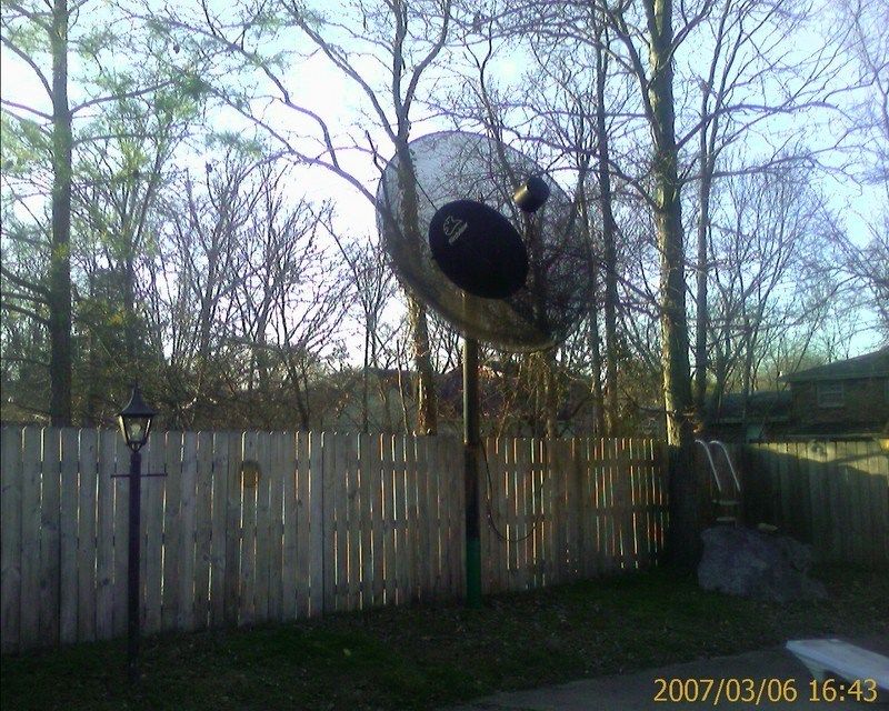

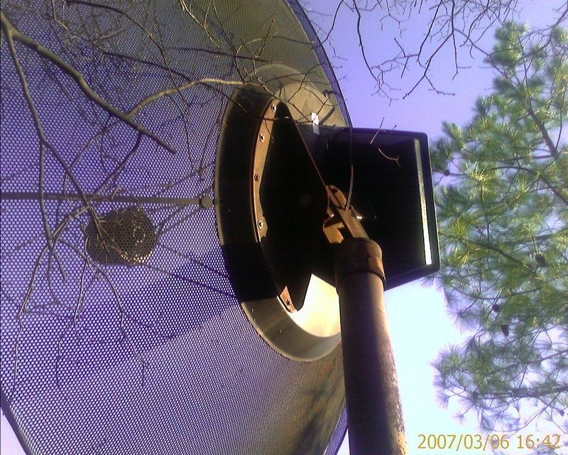

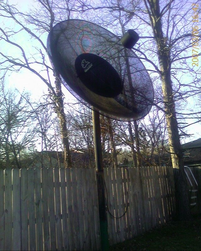

I went satellite dish cruisin and I found this Birdview dish 4 miles from my house. The owner said I can have it for 50 bucks, so it's a go! It looks like it's going to be hell to remove and the pole looks as if it's about 9 feet in the air, so I imagine it's about 4 feet in the ground. I am 5'11 and can't reach the bottom lip of the dish unless I jump for it.
Any suggestions on removing this dish. I wonder how did they installed it!

The way i've been removing them is. if you cant or dont want to dig it up . get a buddy and get a sawzall and cut it at the very bottom of the pole that way you still have enough to plant it when you get home atleast 2 1/2 feet :) or you can digg for ages lol :) and better have a few people with you to carry the pole :) but i wouldnt take any thing loose but the dish from the pole...forgot to add that's a very nice dish there i hope you have fun with it . do you know if it has Ku? everydish i've gotten but one didnt have KU there hard to find around here anyways :) good luck with it

I Dont know I've Never Seen A Birdview before . but how big is it ? 7.5, 10 footer? its a nice dish i bet it does have good ku:) i see it looks like it has the Horizon -Horizon Mount i hear those are good to look over the arc?
From what I heard, correct me if I'm wrong but birdview was the Cadillac of dishes back in the day. I think its a 8.5 or 10 footer.
I've got a 10 footer that I'm thinking of taking off a buddy's hands. He assures me that he can weld a couple pieces onto the pole and then use an engine hoist to rip the pole outta the ground. I suppose we'll see if that works :)

Remove the dish from the HH mount--two people can move dish
Remove the HH mount from the pole--two people can move mount
Cut pole at ground--two people can move pole
Leave dish assembled--It'll take an army to move it and you'll probably damage it.
This is the same dish I had in Arkansas before I moved to Florida. Once it was adapted to the "modern" C/Ku electronics and the declination angle was optimized, I never had to touch it again. It survived several tornados and ice storms.
Rent or borrow an auger type post hole digger and auger a 12" hole no less than 3 feet deep, set in "sackcreet" (make sure it's plumb), and it'll last forever while you watch every satellite from horizon to horizon. Also note that it is a true HH mount. It'll look 90 degrees to the earth both East and West.

Oh yea, I was definitely going to take the dish down, then deal with the pole like you stated! It would be hell if I didn't. Thanks for the advise because I will get me a auger type hole digger.

When I adapted the old Birdview to "New" C\Ku electronics, I had the rings machined off the stock feed and the hole enlarged to accept a Corotor2 feed. I believe, after going to all that trouble, that you can remove the scaler from the Corotor2 and insert it into the Birdview feed without machining off the rings.
Skyvision sells a reedswitch conversion (rather expensive) to replace the pot, so your IRD can operate the HH. My dish had the conversion on it when I bought it. By the way, I paid $75.00 for my dish. The Skyvision reedswitch went south during my installation, so I made a homebrew replacement that worked fine until I moved to Florida.
