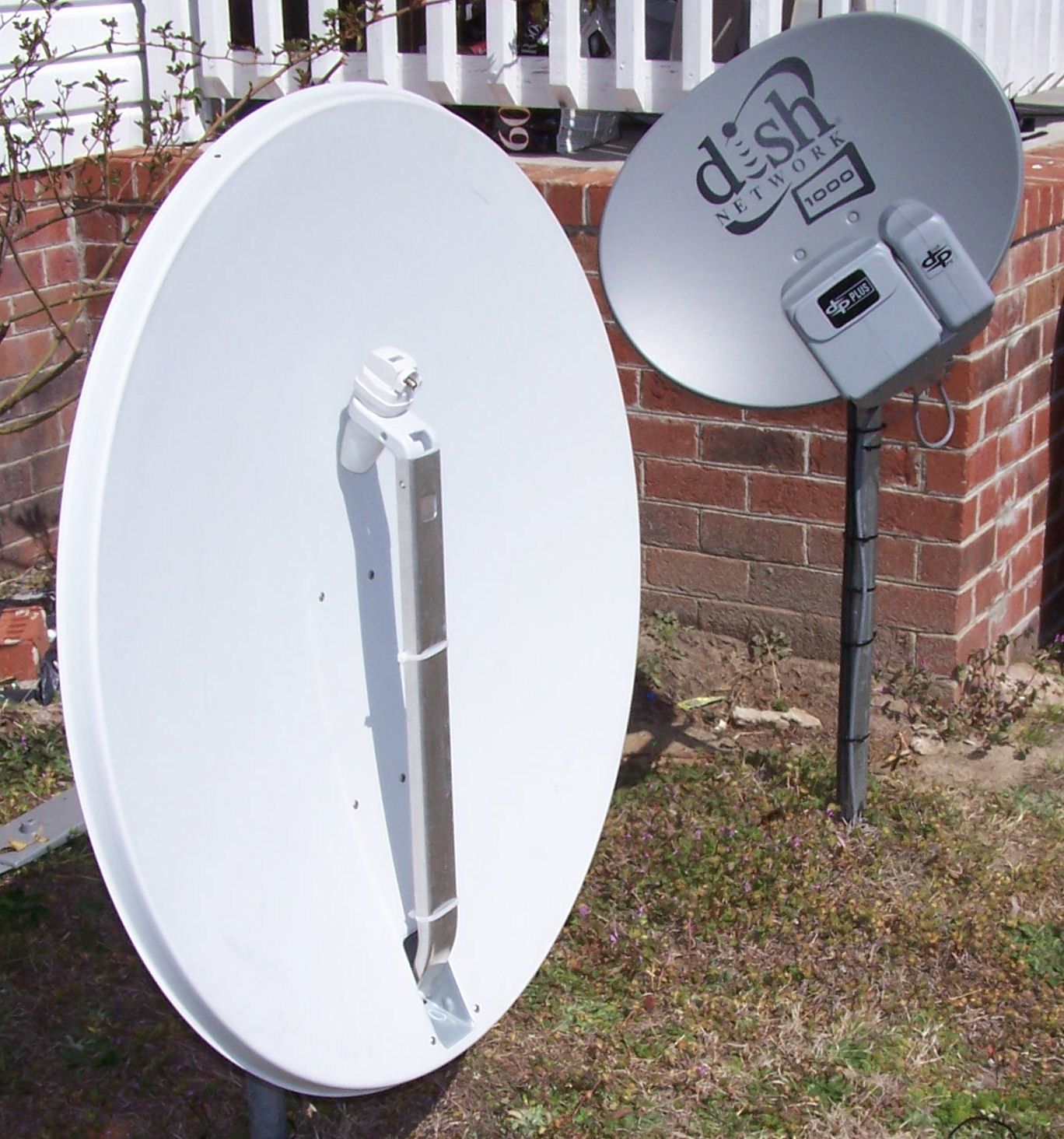

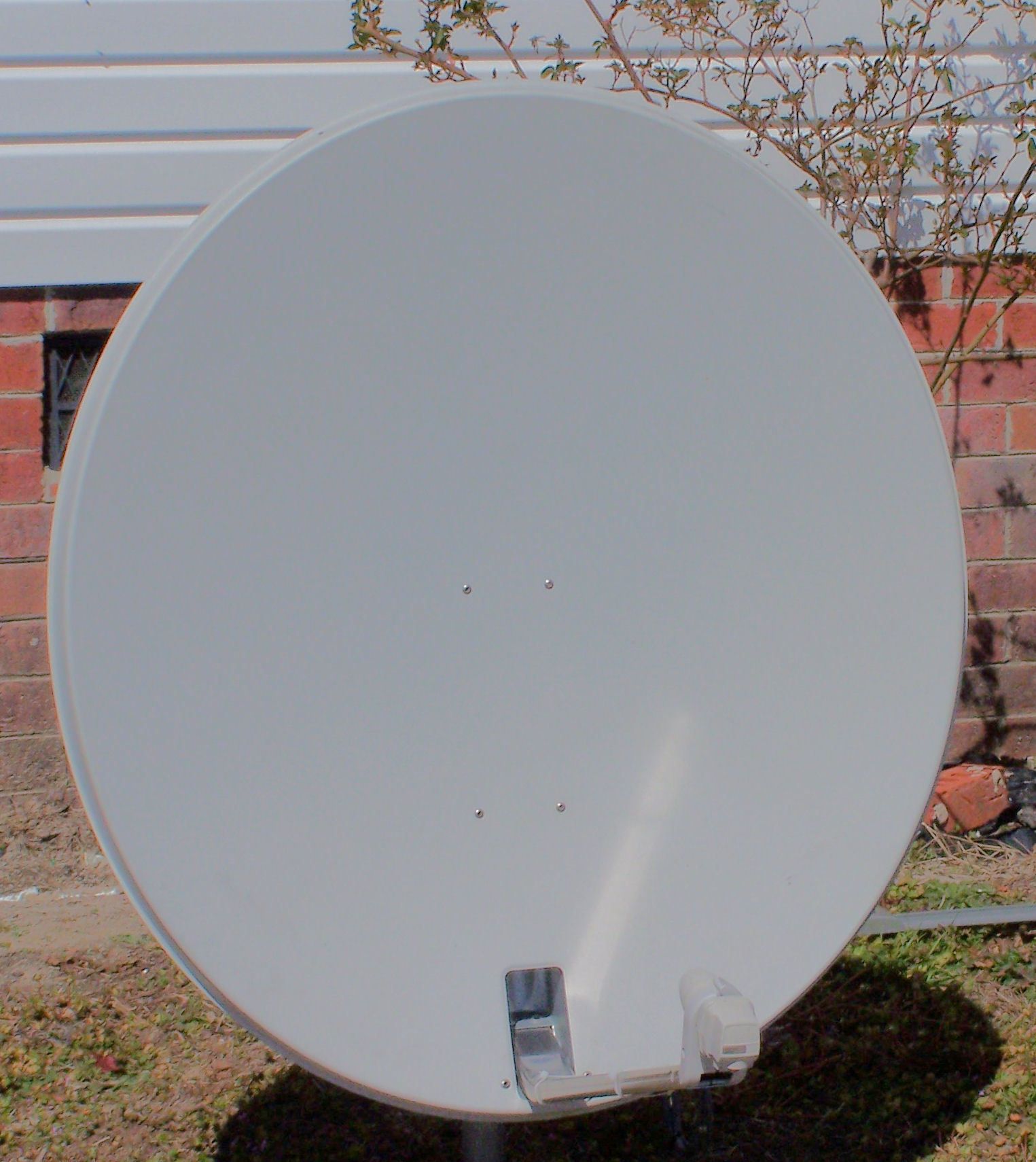

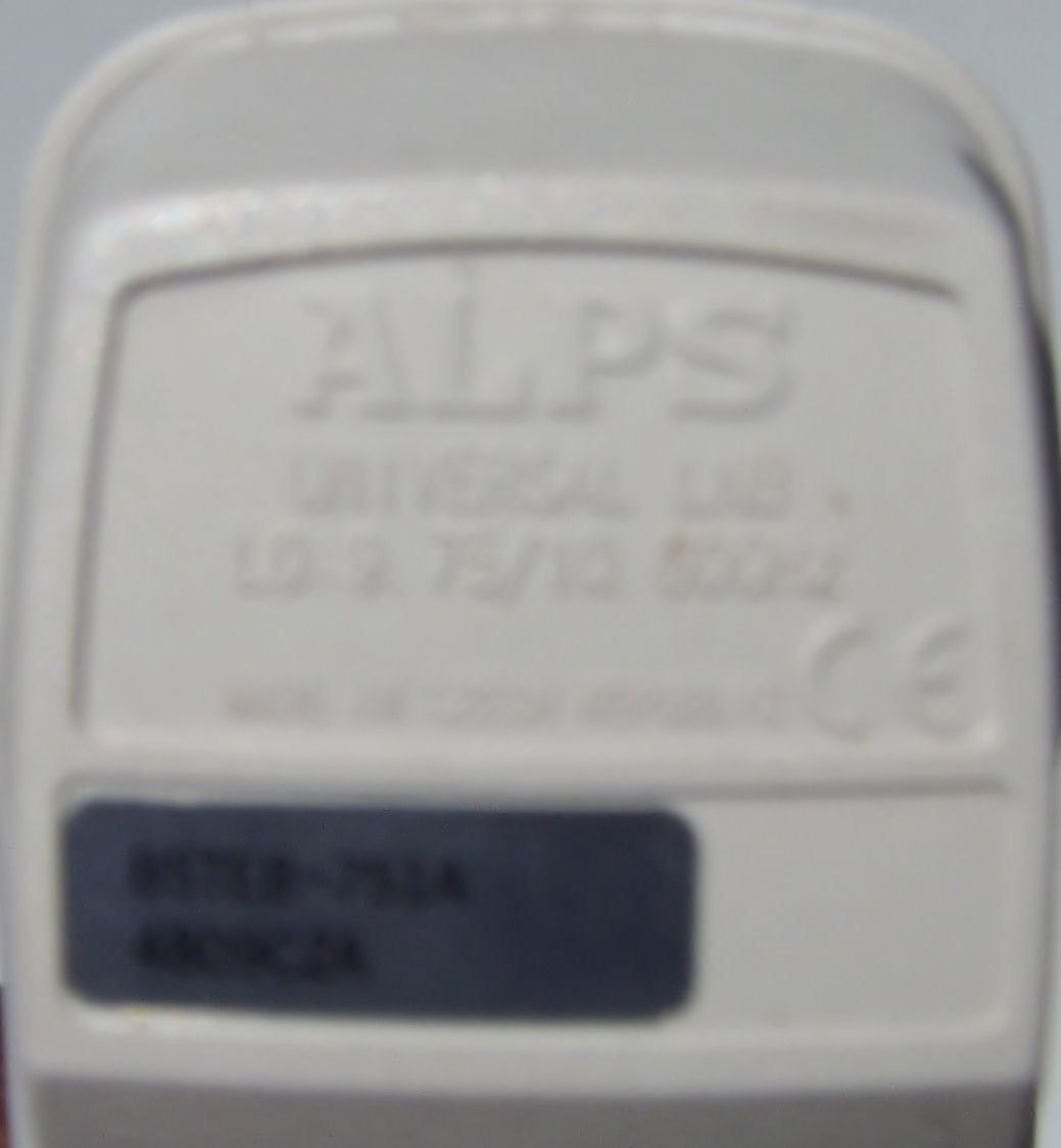

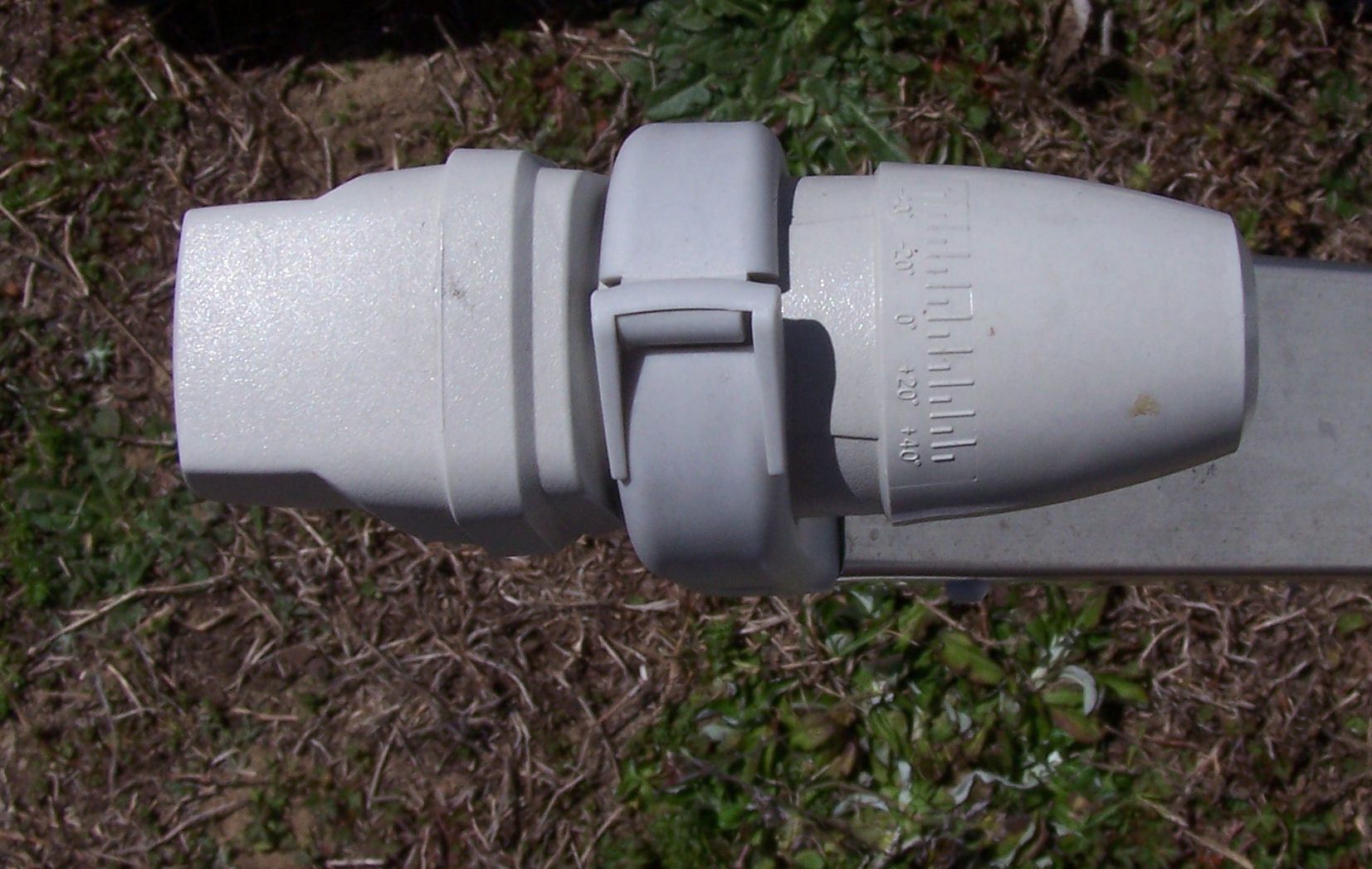

I came accross a dish that someone was throwing away. Has anyone seen this type of dish that the dish arm folds? Also hsa anyone used this type of lnbf? I am planning on using it for GR10.

I assume its at least 30"
That LNB looks weird. Is there any writing on it or specs? As long as it covers 11.7-12.2 MHZ you should be OK...otherwise you could put a different LNB on
The dish and the lnbf came from germany where the couple used it to get AFN.
oh it will work then....you just need to set the receiver up for a Universal
either set up for "Universal" setting (LO freq. will default)
or "Standard" with a LO of 10600 22k on will work :)
