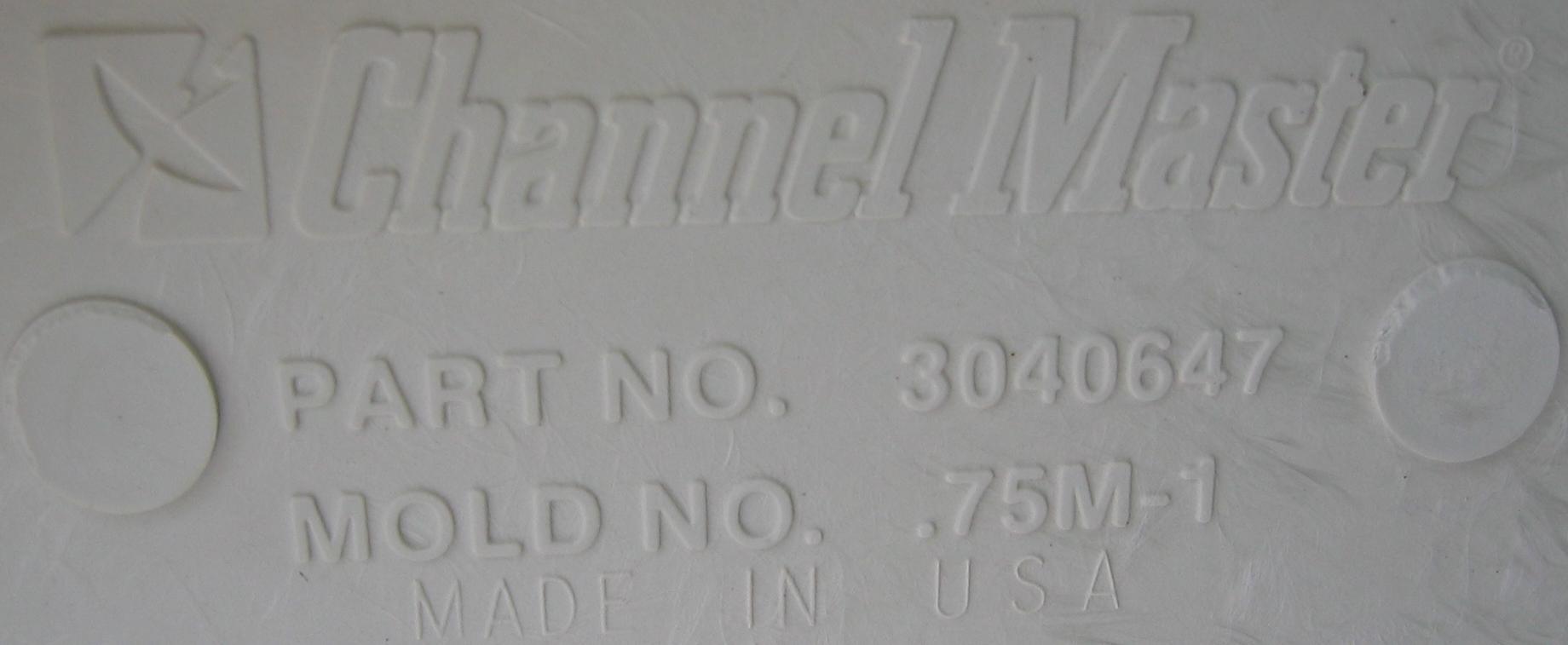

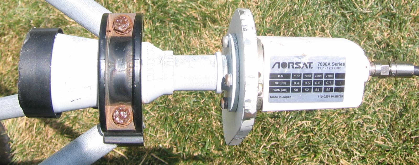

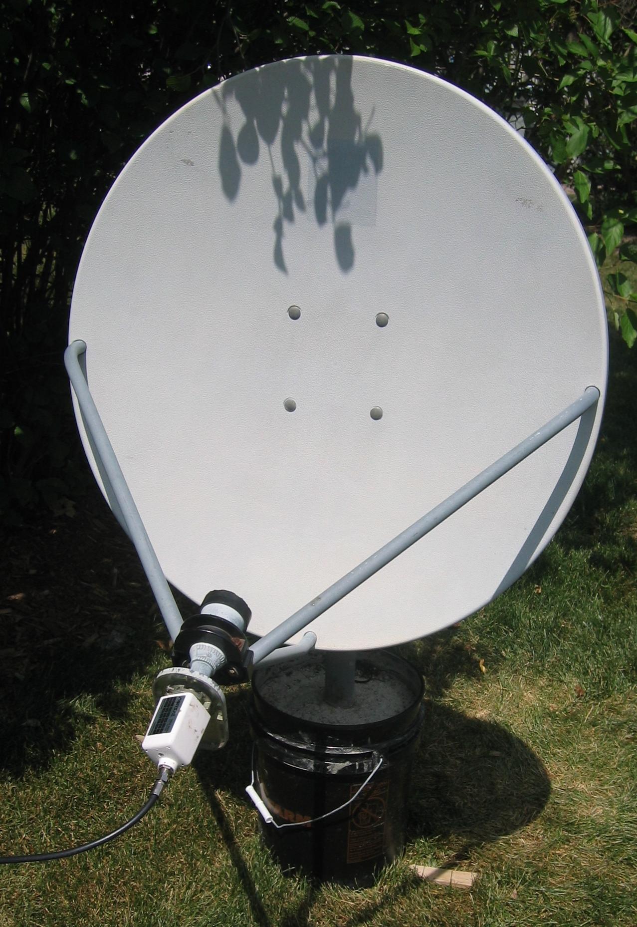

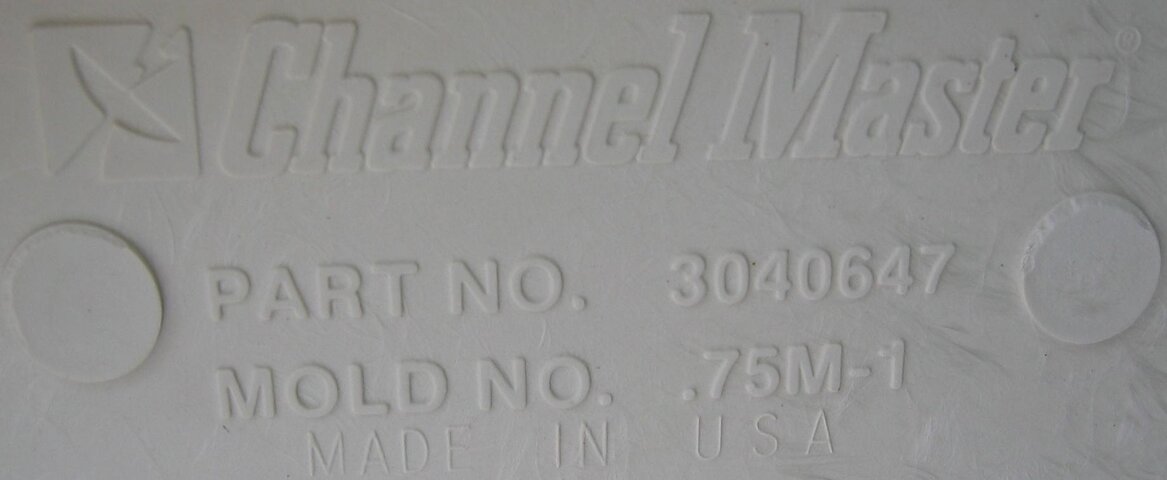

I picked up a .75 Meter Channel Master dish this weekend, mounted it on a superdish pole, and pointed it. It has a linear KU lnb, I actually got two of them, i adjusted polarity manually.
Part Number = 3040647
Mold Number = .75M-1
Pointed At G10R
Signal Strengths . . .
11720: high = 47 , low = 30
11744: 76
11773: 58
11800: high = 61 , low = 55
11875: 44
11905: 56
11968: 75
12034: 74
12077: 56
12103: 56
12114: high = 90 , low = 76

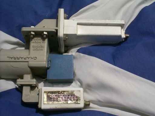

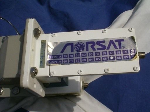

Norsat are GREAT LNB's I have a few myself!

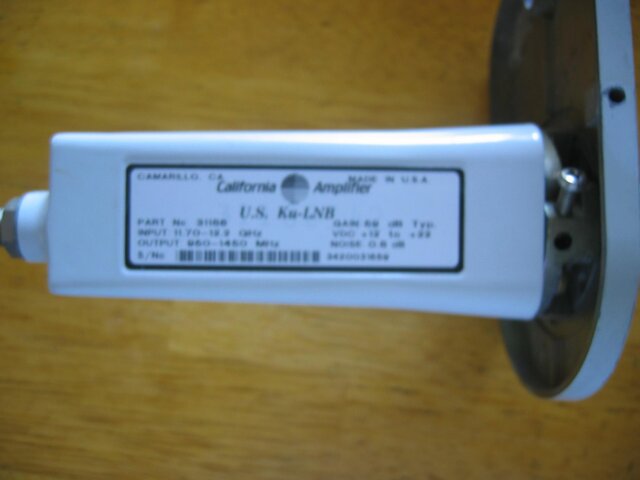

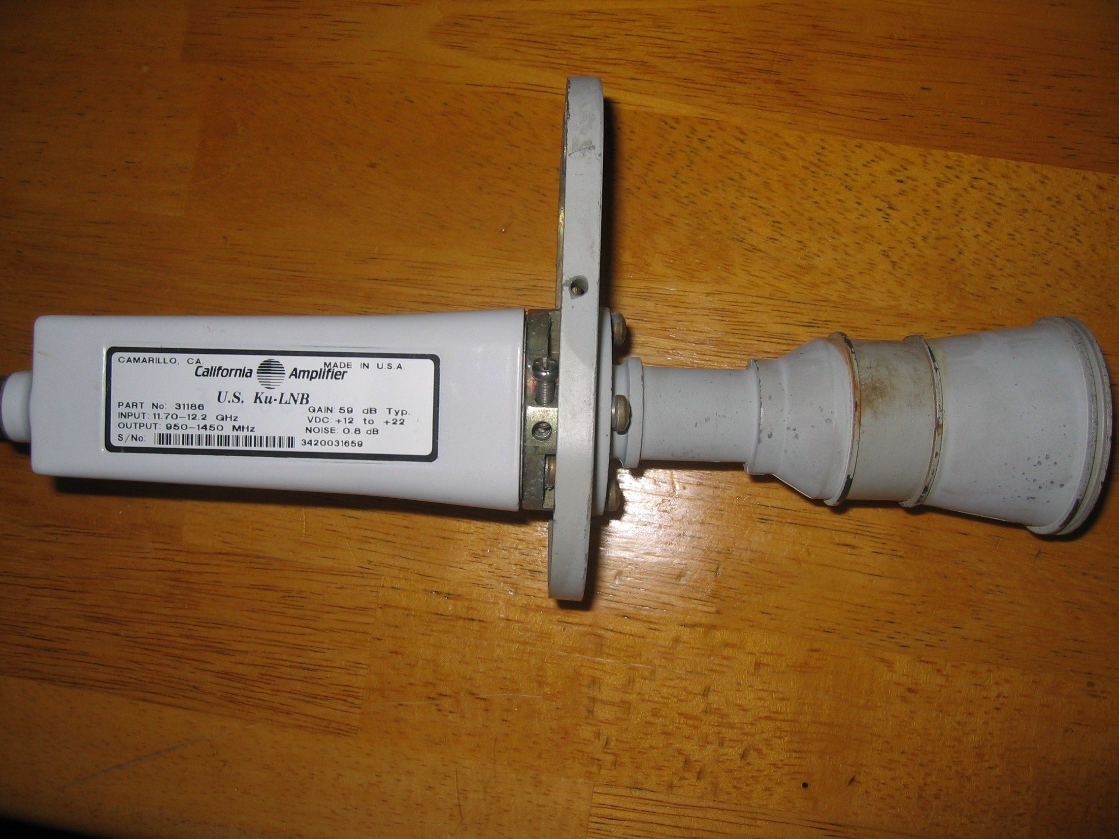

I got 2 ku lnbs and the fiberglass dish all for free. Found it on my local freecycle.
Both lnbs got about the same signal strength, i went with the norsat just because its smaller.
So far signal strengths have been much more impressive compared to my superdish. Maybe its time to get rid of that superdish (make some profit).

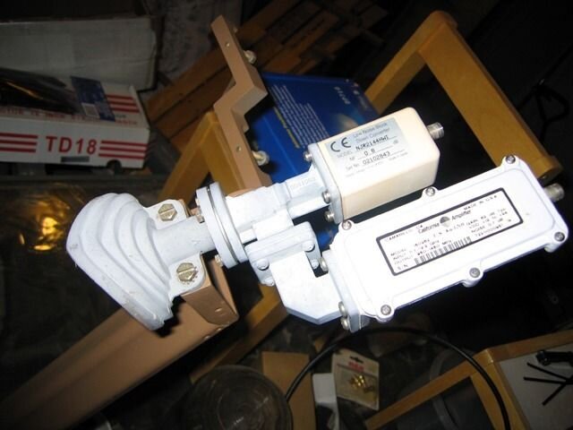

If you can find one, the waveguide from a VSAT setup would let you get H and V on the same dish using both LNBs. Attached is a pic of a waveguide a salvaged from an ex-starband dish. When I put this dish back up I'll add a 2x4 multi-switch so it acts like regular LNBF.
