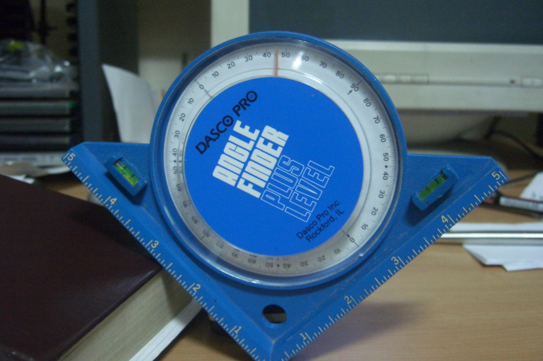

Now I have an inclinometer and I will check. My elevation should be 63.17. Offset is 22.62. My inclinometer reading should be 40.55. Where do you take this reading , front or back of dish? One person says front of dish I should minus the figure from 90. My inclinometer has 0 at both 12 and 6 oclock. I will place the flat surface like inthe photo on the dish (book here) Any help welcome.

Thank you all for help. Anole thank you. I've been able to point my dish to PAS 10. The problem with this dish is the poor mount. The bracket showing the scale is easily bent while sweeping in Azimuth. That was the biggest problem. I intend to change this with a Geosat type mount. On one sat My inclinometer reading showed 10 deg instead of 15. while going to PAS 10 the same logic is not respected. It showed 38deg(should have been 35.5as per first sat) instead of 40.5(calculated) and the scale on the mount read 65 in place of 63. so only two deg difference. I think this difference is not linear through the arc due to the poor mount.
