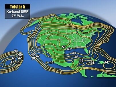

Is anyone from the west (i.e. california) getting IA5 and what size dish are you using? Is there any weak transponder on that satellite that warrents a dish size greater than the fortec 80cm? I'm contemplating whether to go 80cm or 90cm fortec dish. Here in southern california it's pretty much sunny most of the time and if there aren't that many weak transponders then I wouldn't need to go higher than 31" correct? Any feedback would be helpful.
