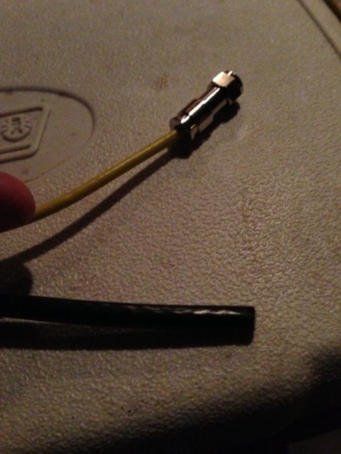

Depending on the footage, go with mini-coax...
http://hollandelectronics.com/catalog/catalog.php?product_id=mini-coax-video-cable
Technically its RG59, but if your doing a short run it should not make a difference in signal quality or loss. I use this stuff for headend installations, because its so small its very flexable and easy to work with.
You can probably get away with 50-75 Feet.
I got white, blue, black, and yellow in all single strands. PM if your looking to have one made up.
Just pay my actual cost plus shipping, which is about $.25 cents per foot plus $1.50 for each compression end.
Mini coax is on the top regular rg6 is on the bottom
