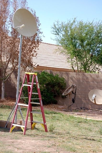

I put together a non-penatrating mount that's been sitting in my yard dang near a year now and decided to shoot for Dr Dish this weekend. Now this particular non-pen was from a small company what was rolling it's own wireless connectivity between remote sites. Because of this the mast is 10' tall (see pic). I skewed the dish to 54.5, dialed in 9 degrees elevation to start with and went to work.
This got old to play with like this but I wanted to try it up there first because I figured with my low elevation to the bird (8.7 degrees) I needed all the help I could get.
This didn't pan out though...
I took the dish off and went after my sawzall. I cut the pole roughly in half, re-skewed to zero (well 90 on the dish, but you get the point), eyeballed the LNBF to 45 degrees or so and went hunting. I set the elevation as per Satfinder and didn't get a thing.
I decided to hit somehting I knew I 'could' see and use it as a point of reference. 58w here I come. I quickly locked on 58w and compared my elevation marking to what Satfinder said. It was +4 degrees.
I dialed in 12.7ish elevation and swung the dish East. There it is!
