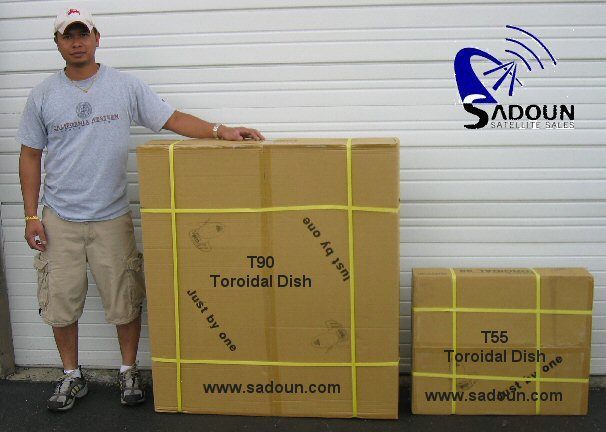

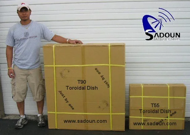

I would recommend a Wave Frontier T-90, but you're dealing with a beast of a shipping box and extra money for each LNBF you install.
Well, LNBFs are cheap enough these days, but the shipping on a T-90 will kill you...
Shipping a T90 will run $75+ :mad:
Look how big the box compared to the T55
SatinKzo said:
Is that a picture of Mr. Sadoun himself?
Back on topic, that T-90 is huge.
Not very big at all, i wish they would have made a T120 or T150 also as the T90 is way too small in Europe for some birds.
