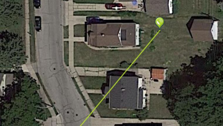

I get a solid signal on every Ku satellite on the arc except Eutelsat 116.8 W.
Here's why:
Looks like you need either an OrbyTV dish to the south of your house or some elevation gain on the current one.
Sent using Tapatalk
I raised the dish about a foot on the pole in hopes that would be just enough to get the signal. Didn't help.

I now have an Orby dish installed. Mounted the "J" pole on the side of the garage. Assembled the dish inside the house and preset the dish elevation and skew to dishpointer spec. Ploped the dish on "J" pole and turned dish to where Eutelsat should be. BAM! Instant signal 91/83.
