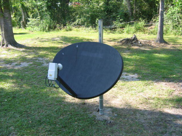

I just set up my new Channel Master elliptical dish (36" high x 24" wide) and it's reception is just as good (so far) as my 1.2 m Channel Master oval dish! I also bought a cheap 36" oval dish (thin metal)-what a piece of crap! Can anyone explain the excellent performance of the elliptical dish v. the significantly larger oval dish? Also, I have learned that quality really matters--quality seems to be more important than size :) (no jokes pelase!!).

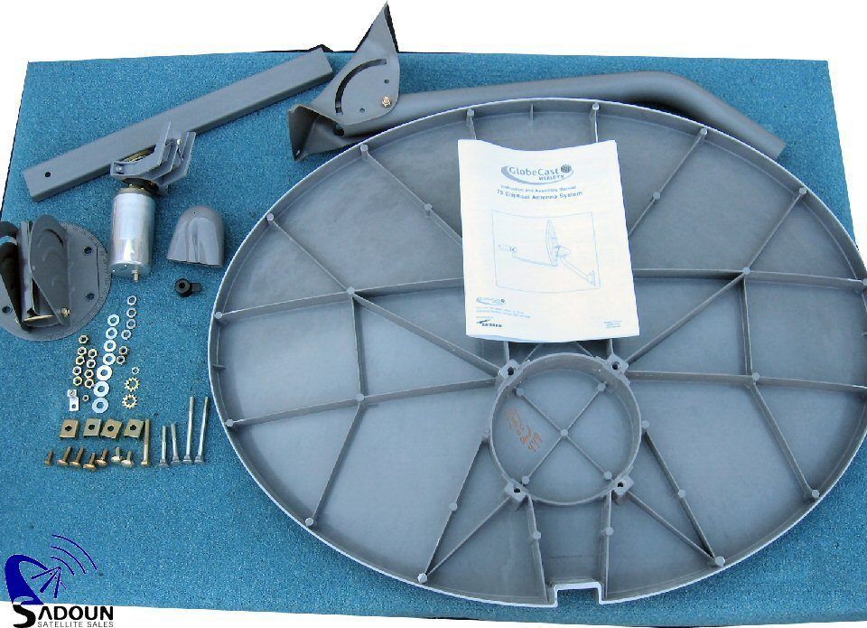

although i don't think its impossible to motorize (and i don't have one to try) . these dishes are newer design and have a lower mounting point than the older primestar/channelmaster dishes.

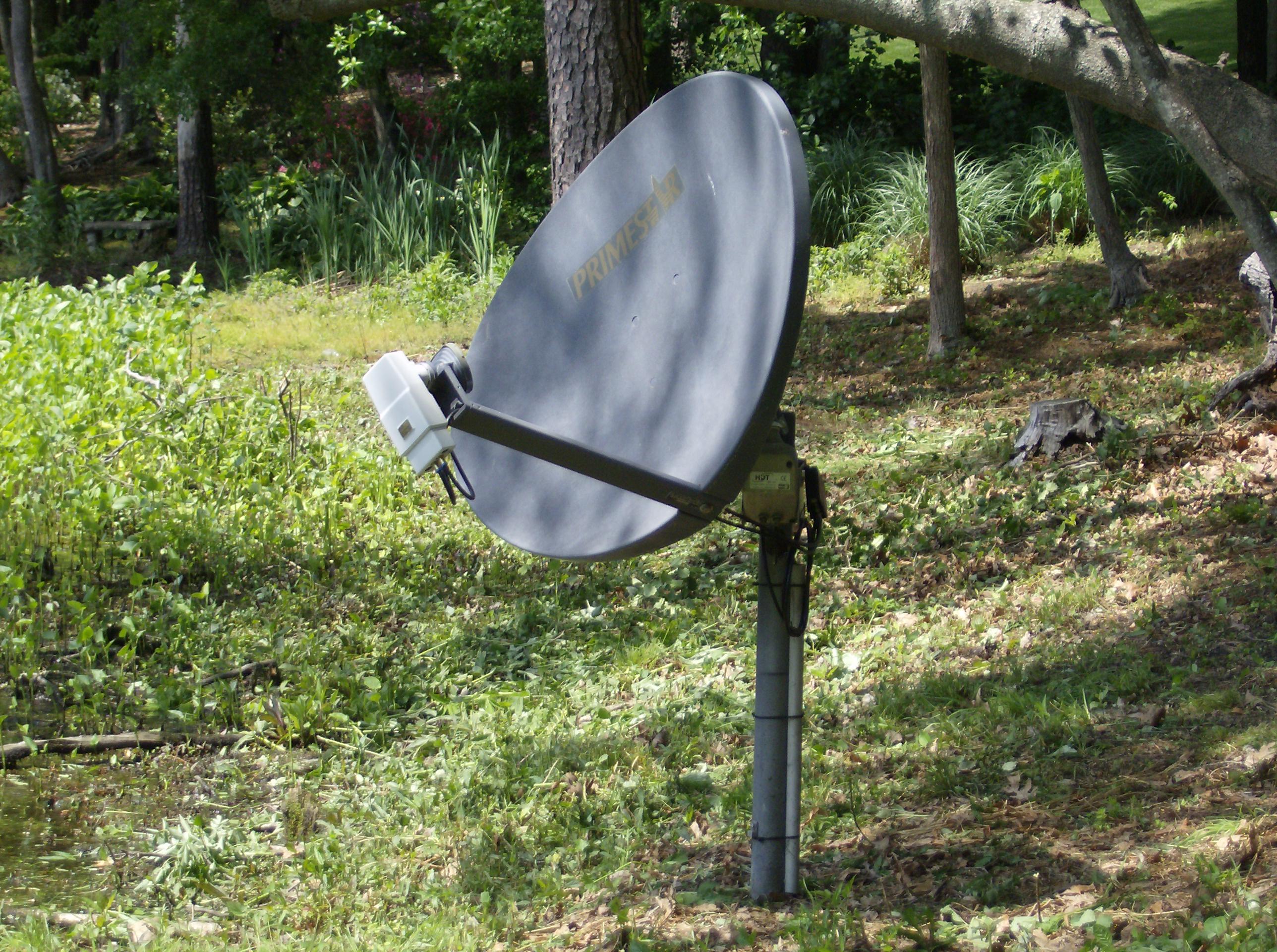

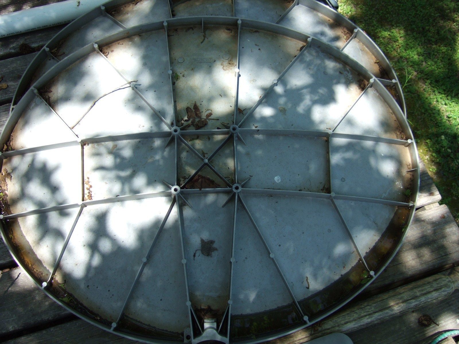

heres a photo of one of my primestars and you can use the link above to look at the globecast/channelmaster dish. The globecast/channelmaster dish will show a lower mounting point for the skewable mount. so lower mount & lower holes for the bolts (i don't even see bolt holes for the higher mount on this dish) so they might have been covered/filled.
the primestar/channelmaster dish mounting point is in the center of the dish.
with the globecast/channelmaster mount being lower i don't think it will track the arc correctly on a motor. but untill someone tries it, this is only a guess

I would like to mount my Channel Master elliptical dish to a motor--see Thread No. 1 above--since the mount on the back of the dish is lower than center will I have trouble following the arc? DO I need to build an adapter so that the motor will mount to the dish at the direct center of the rear of the dish??
your in uncharted waters here i know sadoun says no
i think since the mount is now lower that it probably wont track the arc but the only way to find out is try it . if you already have everything.
you have the globecast dish with lower mount right .....do the holes for the center mount go all the way through , the new lower mount looks like it remakes the lower two holes and adapts the new skewable lower mount . if you was close by i'ld just let you try one of my old primestars

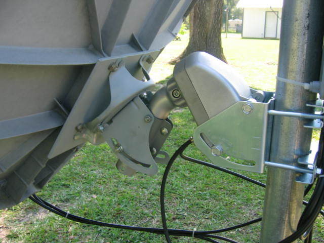

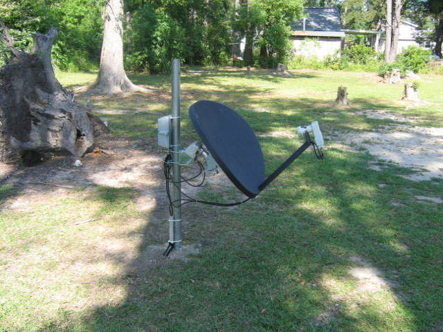

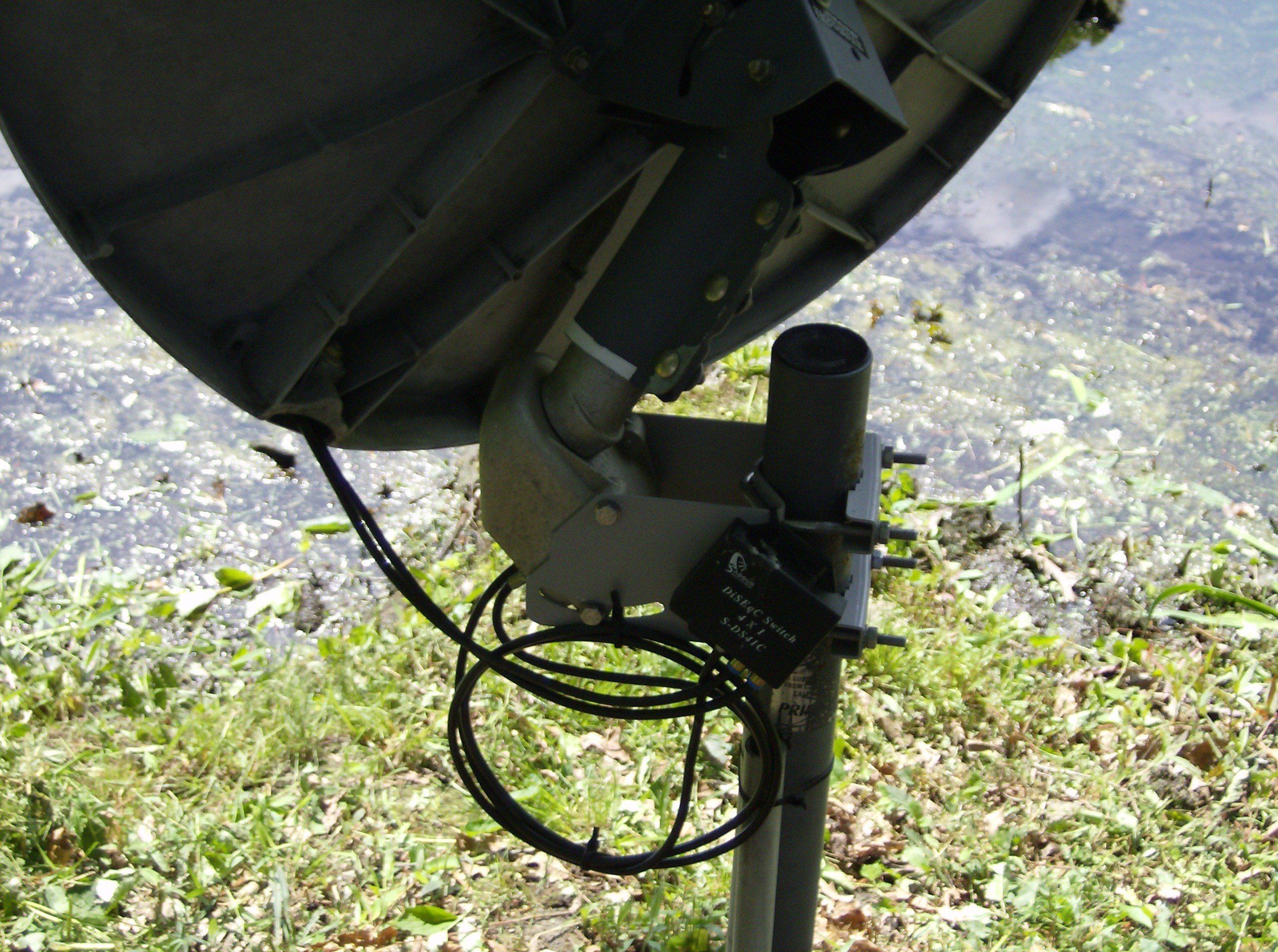

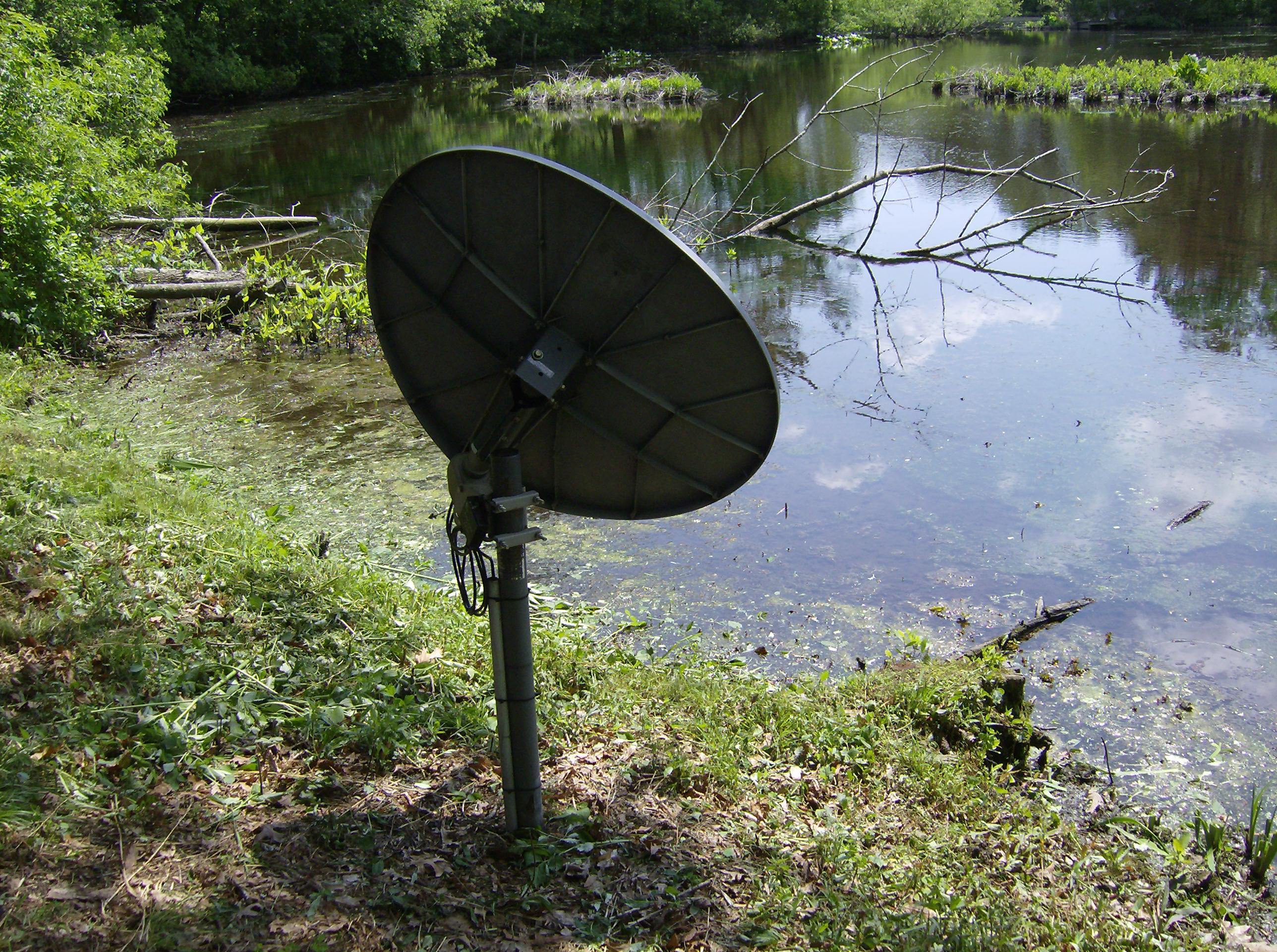

I recently mounted my Channel Master Primestar 84E to my HH100 motor. Used the original mount - the only minor modification was a $2.00 piece of PVC pipe that I used to shim up the shaft.
Works great - tracks the arc perfectly. Here are some pics:
