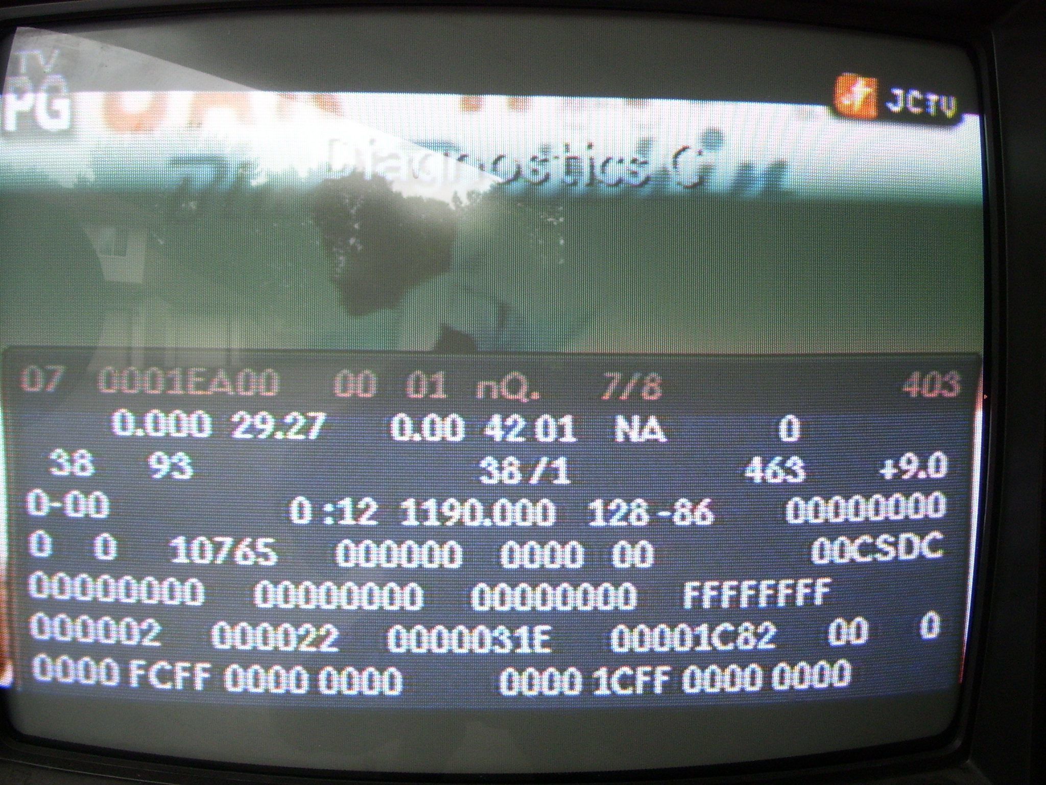

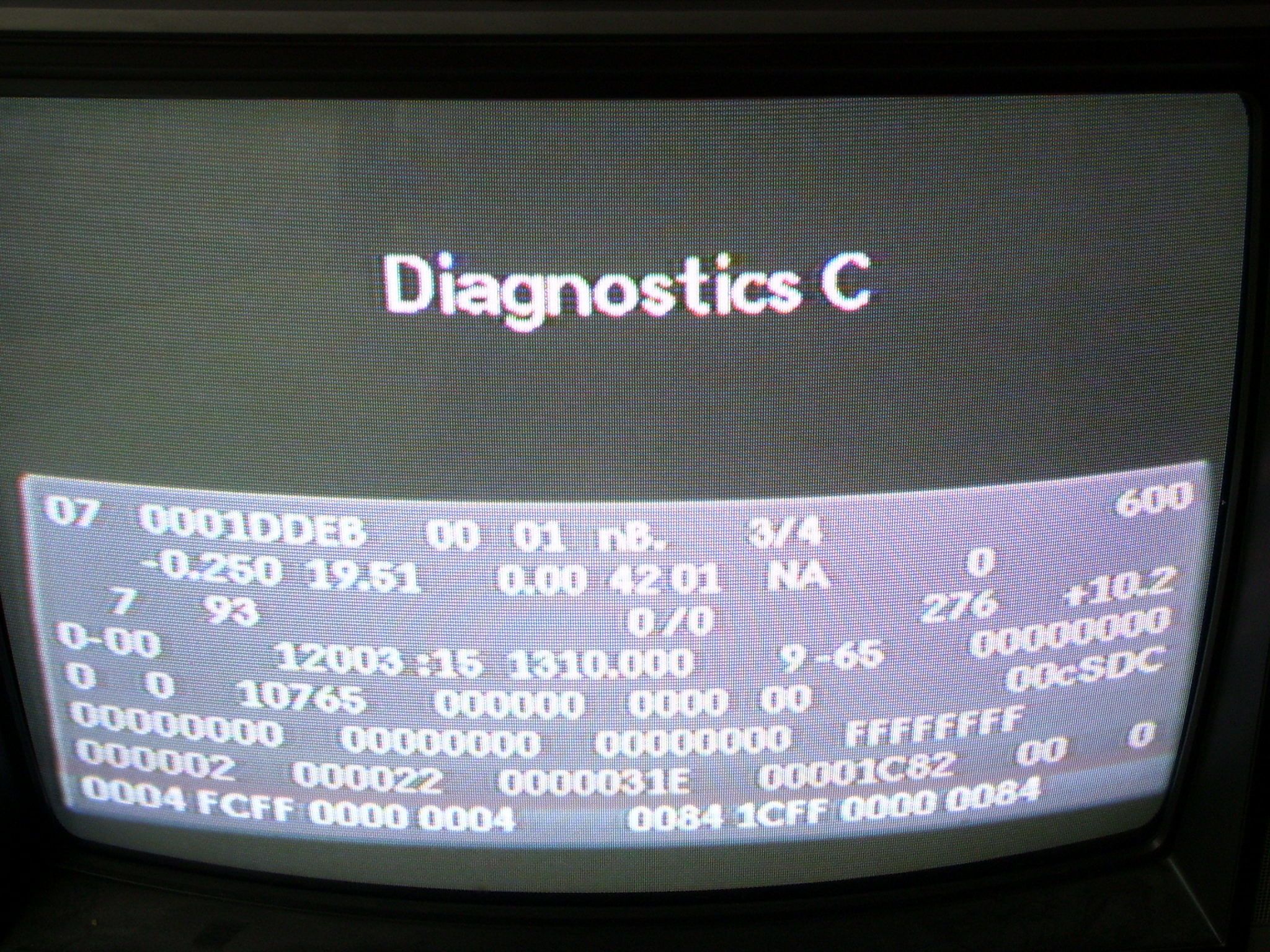

I thought it was a fluke because the 905 ebno # stays at what the last channel was until it locks the signal. So when I saw 10.2 I was like "yeah ok...must have been when I was on AnikF1 the other day"
so I did this...went too GB and locked in JCTV and got a 9.0 (see below pic)
moved the dish far enough for it to lock an ebno but not be stable... was at 3.8
then I brought up G3 600 and ebno was still at +3.8
moved dish slowly until green lite came on and it was at +5.8
moved a little farther and locked at 10.2
if I keep moving west it goes down dramatically

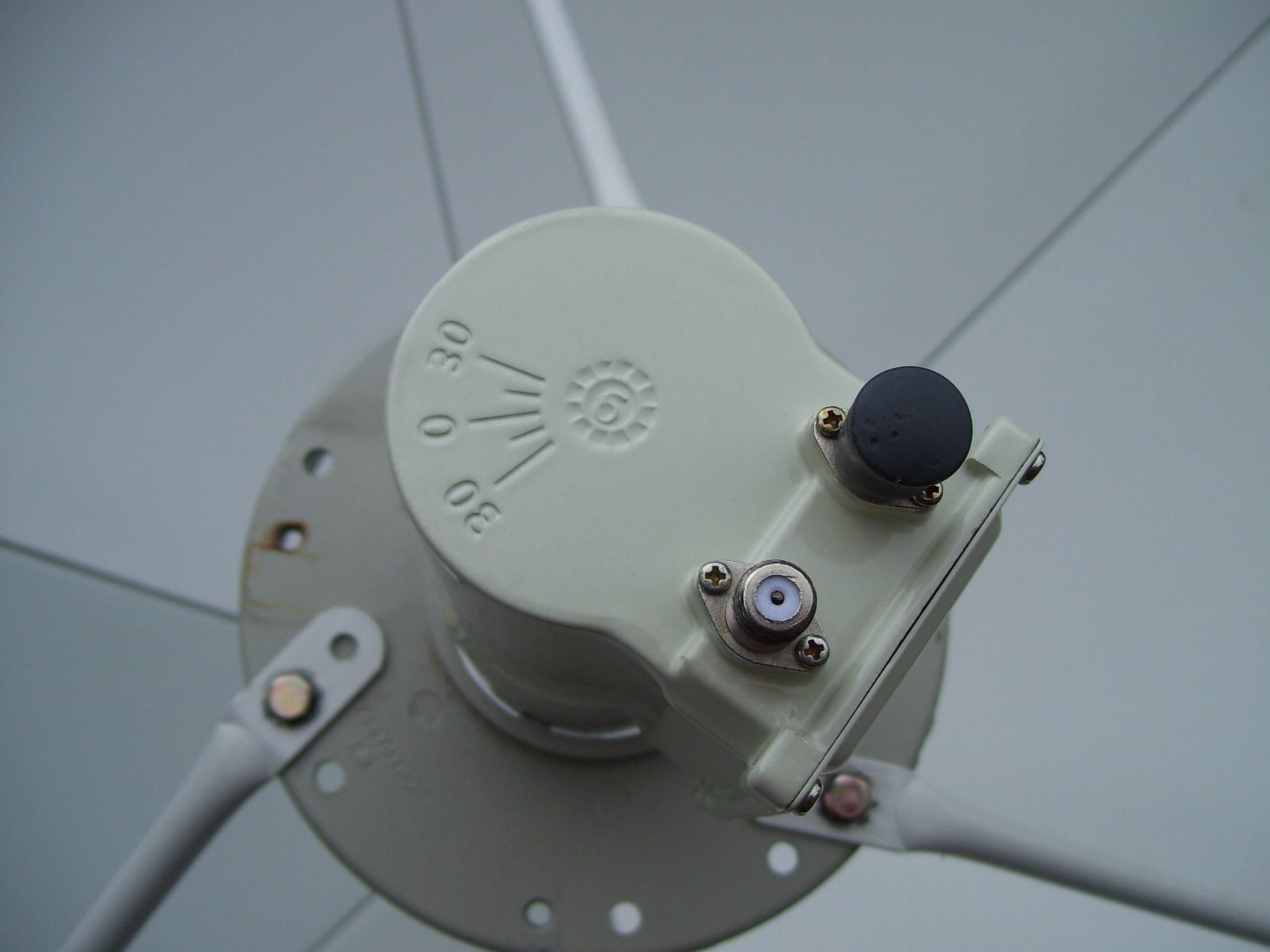

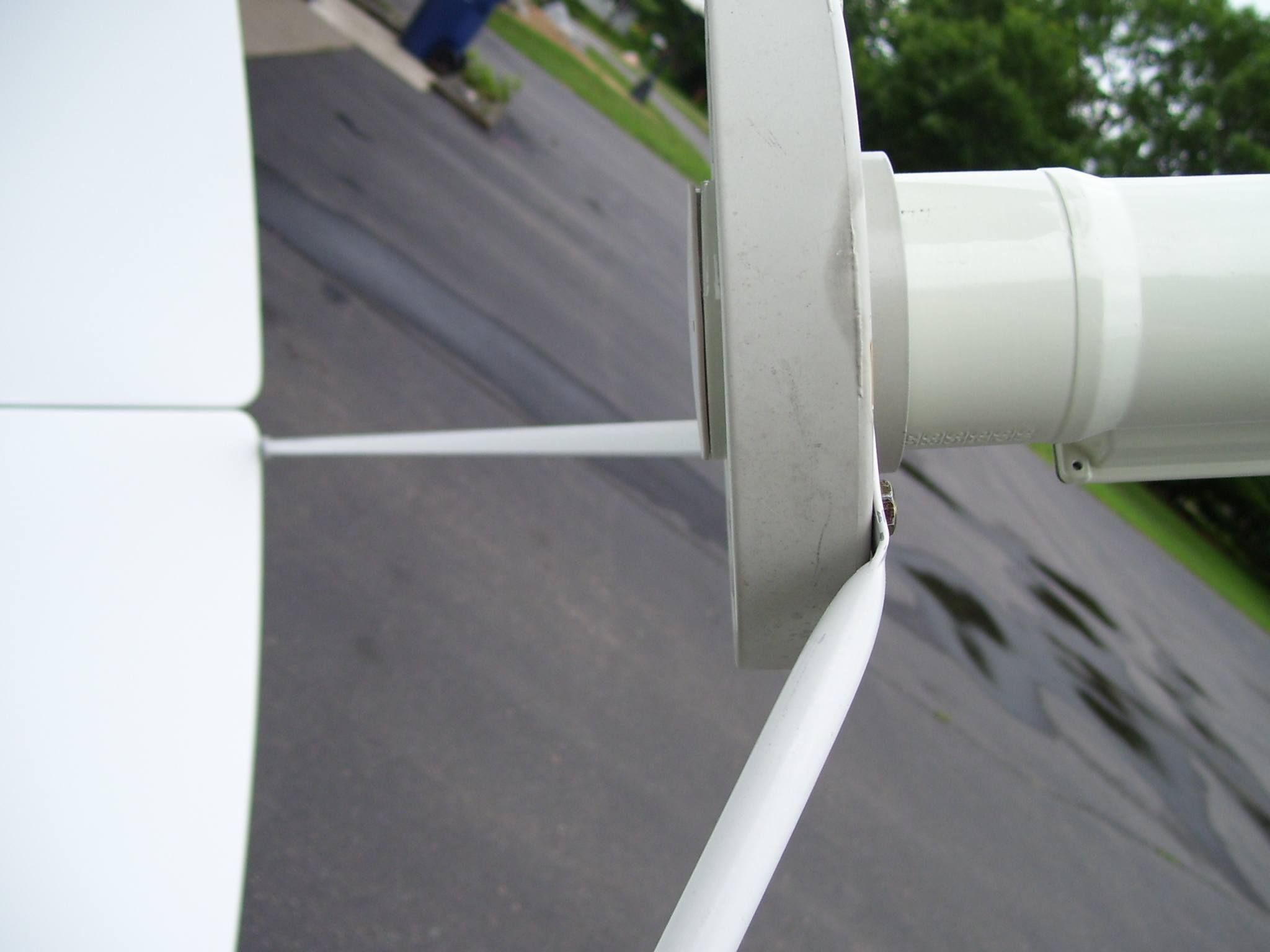

also attached are pics of the LNB skew and how far its in the scaler ring. This was actually set up for 99W the other day so nothing had been changed

Hey Ice just a suggestion If you don't use the second port on your LNBF. I would put a light layer of RTV around the cap to keep moisture out when it rains.
that cap isnt good enough? Once in a while I do use the 2nd port
This is the dish that gets wheeled out of the garage :)
Oh if it's in the garage most of the time in bad weather your good to go. I was concerned if it was out all the time I would seal it. Because any water that gets in that connector will cause oxidation. An God forbid any water makes it to the circuit board "POOF CITY" I'm very good when it comes to weatherproofing connections especially when there's voltage on it.
BTW Ice I just got off the phone with my client that I did the 410 system for. He really is interested in making his 6 foot movable and get all the channels (he's got the bug big time) So if you hear of anyone selling a 4DTV, PM me because he will need that for sure.
Thank's Tvropro.
all of my dual LNB's that are in the open have coax cables hooked up to them ;)
