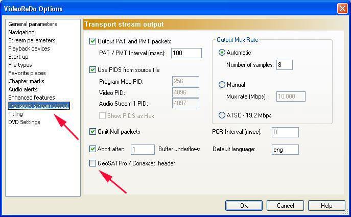

I can record a program and play it back fine with the DVR1100c I transfer it to my PC and it plays fine but if I edit out the commercials with VideoReDo Suite and then try to play the file back on the DVR1100c it shows a message that says "Wrong File" the file plays fine on my PC after editing though and the original unedited file plays fine on both the PC and DVR1100c. While the edited one only plays on the PC. I'm using the Maxtor OneTouch 4 Plus formatted to FAT32 I tried to format it with Swissknife but that program does not work with Vista but I was able to format it with another program. Otherwise I'm really enjoying the DVR1100c. I have been recommending it to a few people.
VideoReDo TV Suite starting with build 567 has TS output support for the GEOSATpro.
Thanks for the Kudos!
