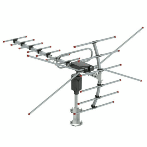

I have DB8e antenna with rotor, anyone know of forum that still around

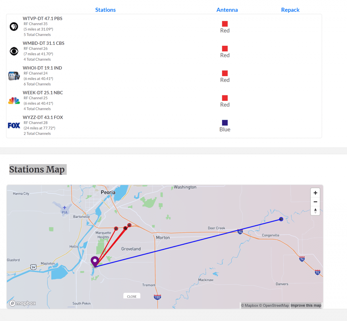

Since you guys are so knowledgeable, Peoria local channels are within <20 miles of any antennas and I pick those up with no issues with my Televes that Dish still sells. It's about 20' in the air, pointing slightly East North East at about 110 °.

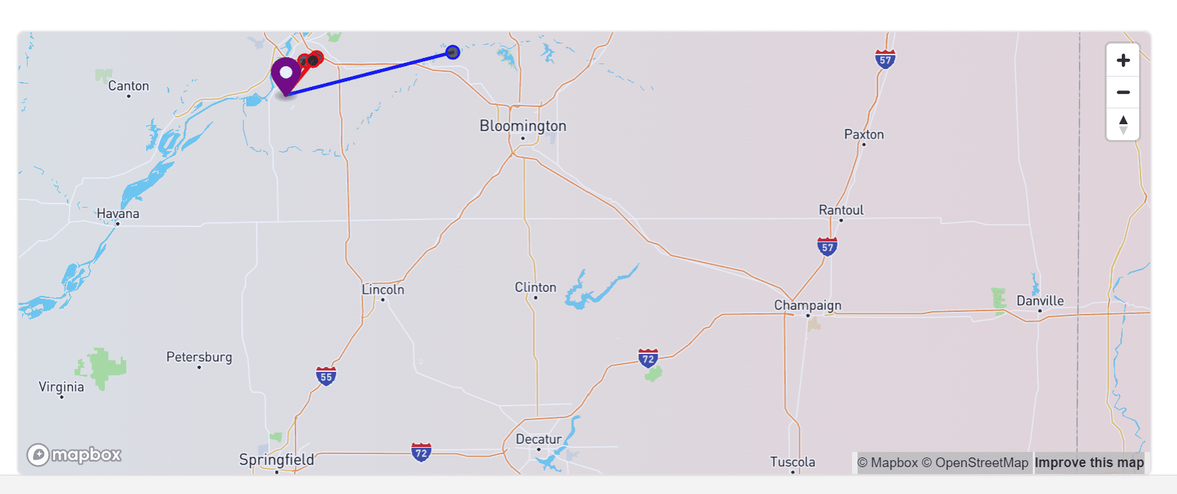

Over >50 - 75 miles away to the southeast if I could reach that far, are the Champaign/Springfield/Decatur locals. I'd like to hit both using, if needed 2 Antennas combined, but trying to find that longer-range Antenna is daunting with so many out there. And how to combine 2 into one feed?

My DB8e isn't all that great, I pick up two more channels with it than I do with $6.00 indoor from ebay

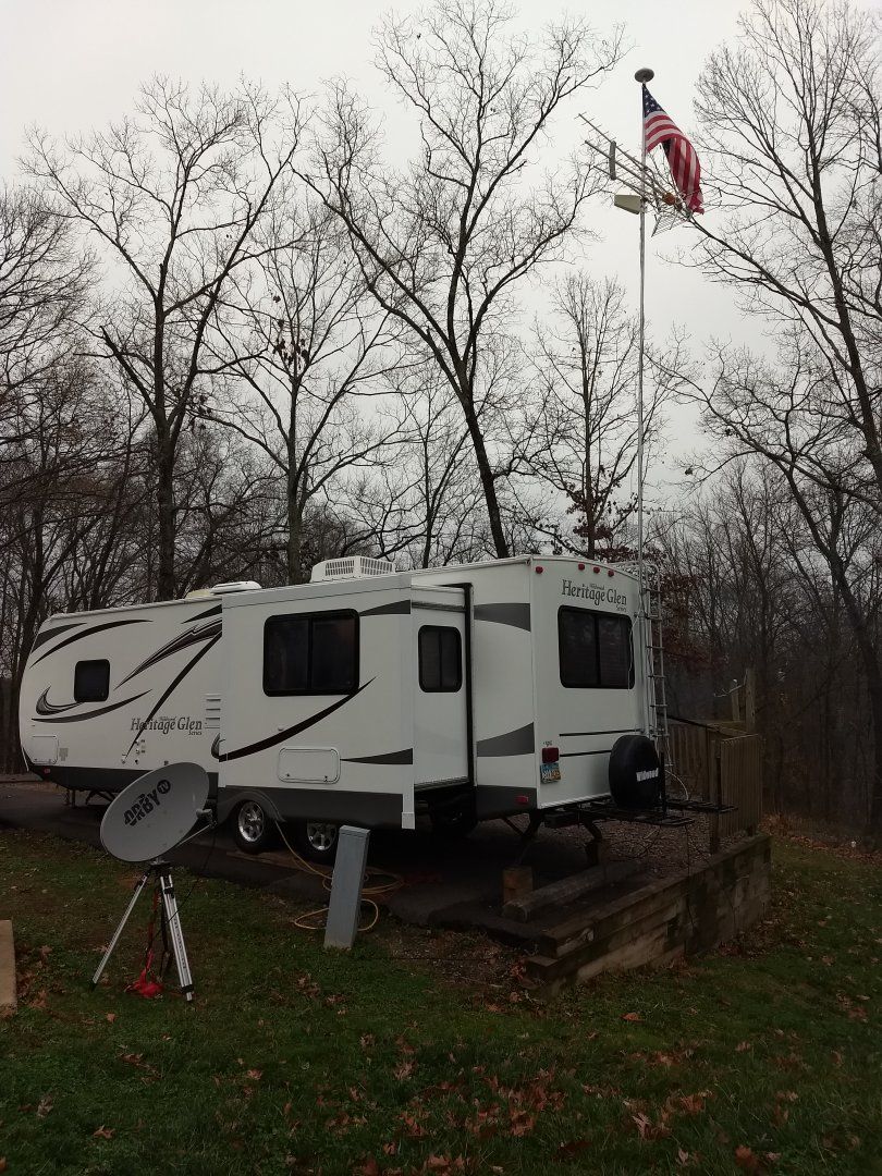

My Airtv dual tuner adapter doesn't work very well for long range either..We are camping 68 miles SE of Columbus Ohio this week..My Wally with the adapter and a Televes DAT BOSS Mix LR antenna wouldn't pickup a signal.. Since I also have Orby I switched over to it and now I'm pulling in Columbus with a signal watching Buckeyes football
