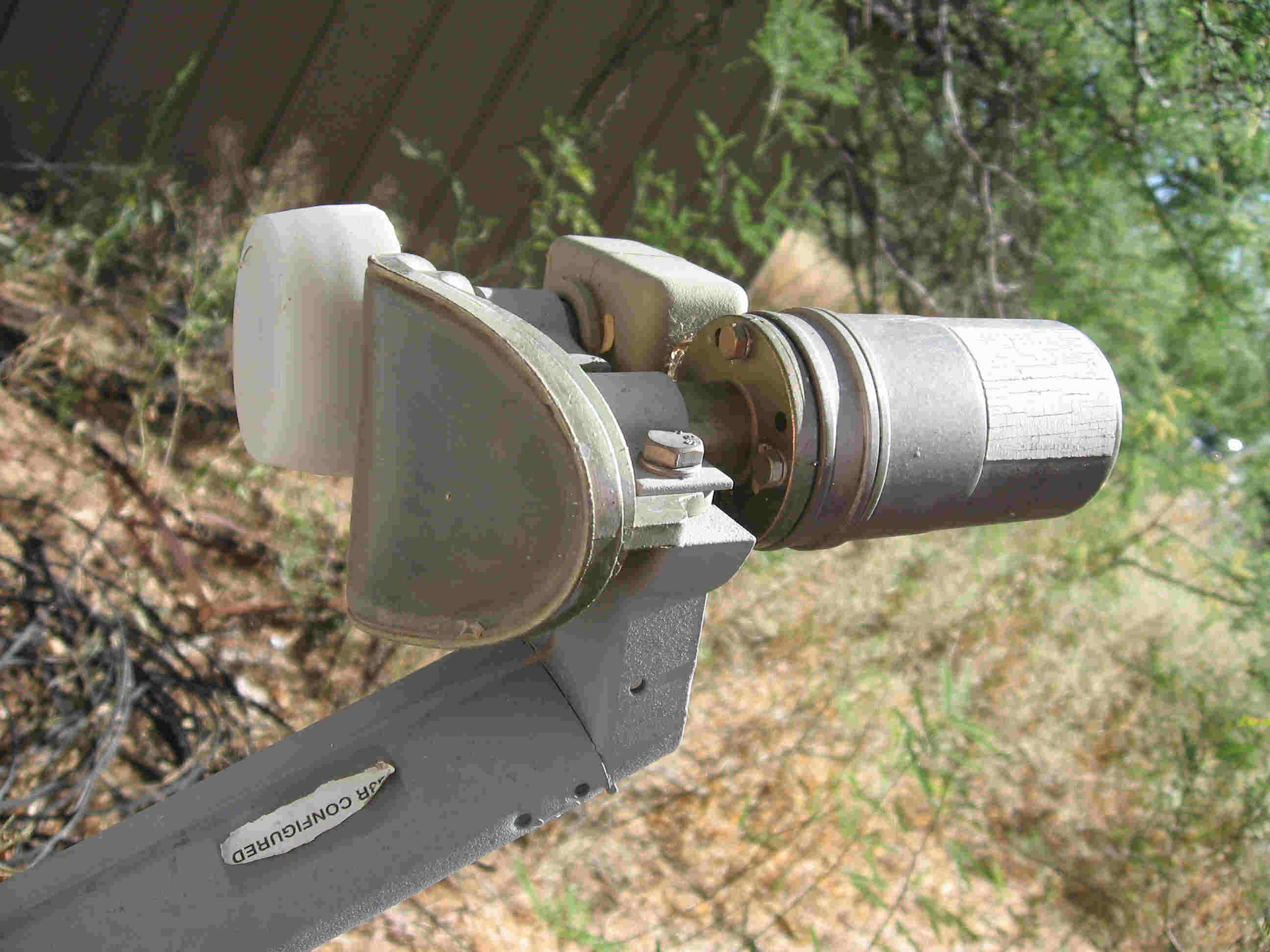

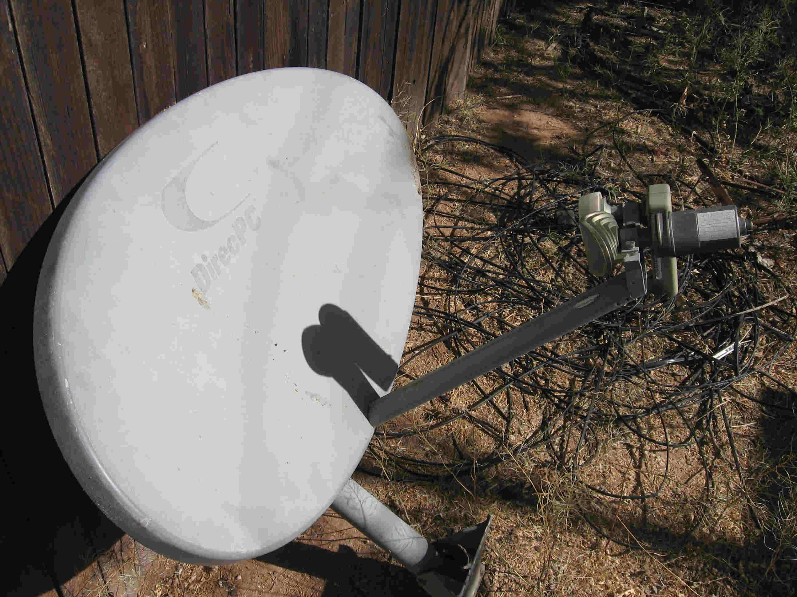

Would this C120 LNB work with the attached DirecPC dish pictured?
I would rather use a standard Dual LNB instead of a universal one. Another issue is that the Invacom LNB is pricey. Anyone know of a better alternative?
That funky looking feedhorn leads me to believe it would be a good idea to use it with this odd dish. Or, doesn't it matter?
What about jury rigging a normal Dual LNB (40 mm mount is it?) for this dish? Just use a stainless steel hose clamp or something to fasten it.
Any ideas would be appreciated.

Those stock LNB's work great for FTA. Have a few of those set up at one time or another
But if you want to upgrade to a dual, you could get any old dual and take the casing off. The groove on those dishes is a 25mm throat and most LNB's are 40mm. If you take the casing off you get a 25mm throat that slips right on there :)
I just had to swap out the Primestar LNB (looks like that one)...it crapped out. Put a Sadoun dual on with no issues :)
You could also mount a stacked LNB onto that dish (the stacked FSS LNB on a Superdish will work fine). I did this when I couldn't find a cheap, suitable dual output LNB for my 1 meter Channel Master dish.
The DP FSS LNBs have a standard C-120 flange.
I would use the LNB you have

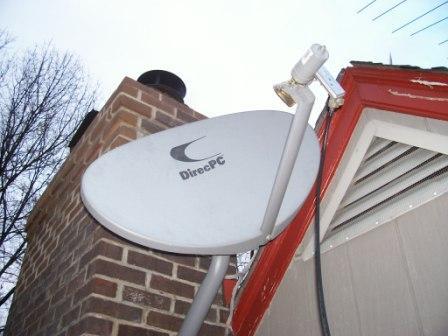

I have the exact same dish and it works great! That Hughes LNB is excellent!!!
The DISH and LNB work great together and even though the DISH does not look too good it should perform very well indeed. :up

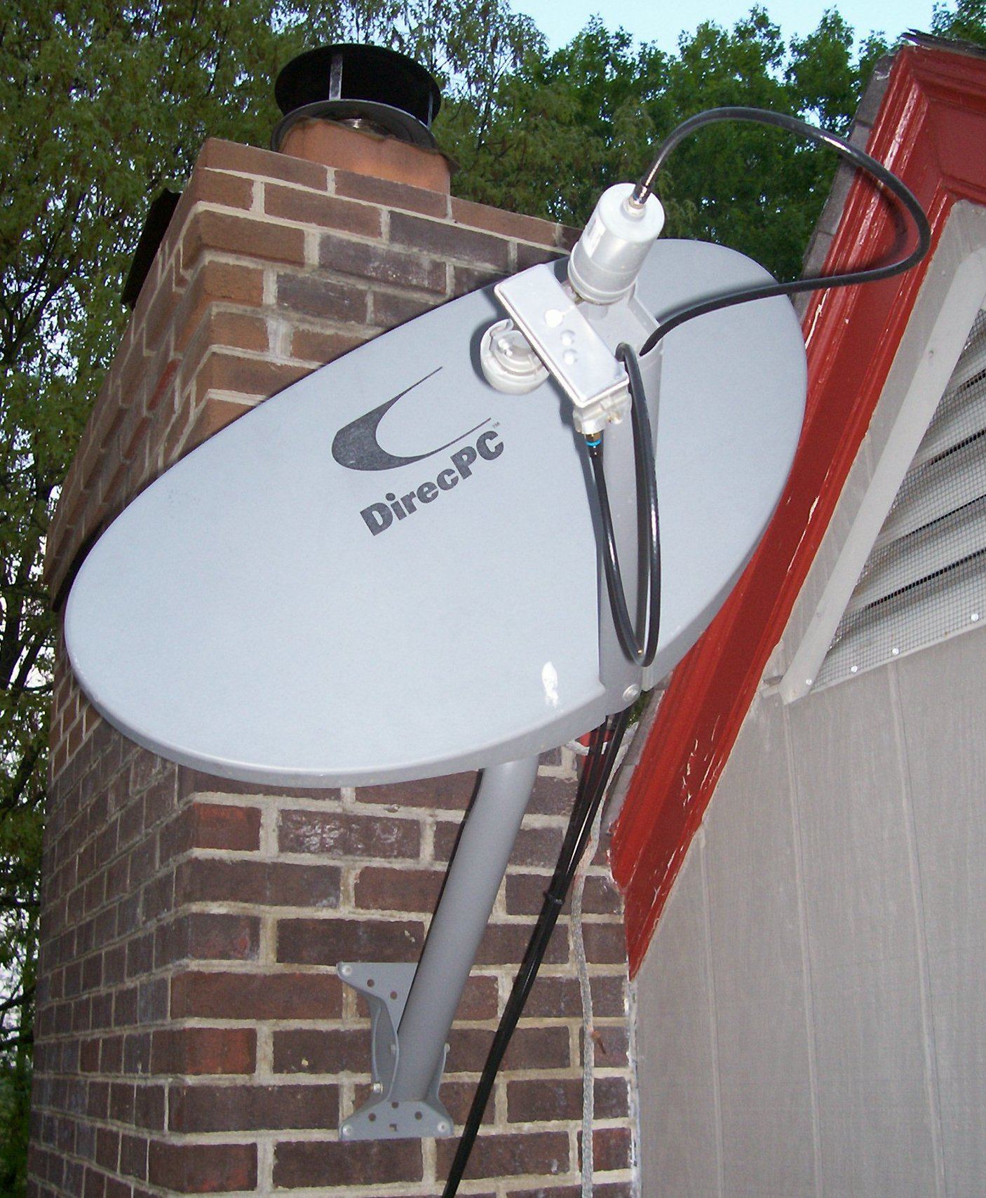

On that photo, the coax is connected to what kind of LNB? Linear or Circular?
This is an early picture when I was still getting everything setup. Here is another picture from today. The Hughes linear LNB is on 123W (G10R) and the shiny LNB is a DISH network circular LNB with cover removed for 119W and the NASA channel and Angel One. This setup works very well and I highly recommend this dish.

Those DirecPC dishes work well do they? Excellent! I've been trying to locate some dishes for either Galaxy10 or AMC3. I've made a phone call, and I'm going to have one of those dishes in my hands on Saturday when my parents come for a visit :)
My father picked up a DirecPC dish at their local rural garbage dump - he thought that it might be useful for something someday. That "someday" will be very soon!
