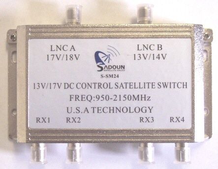

A particular brand to recommend?
Would something like a DP34 switch work?

i have dual c and dual ku lnbs on my dish. my vertical lnbs only get 13v and work fine. my horizontal lnbs get the full 18v and work fine. I use powered multiswitches two of them.
one 4x2 for c band and one 4x2 for ku.
c band only would only require one multiswitch. I recommend a powered one out next to the dish to minimize the power loss from longer coax runs as far as the 13v lnb is concerned.

I have a Chaparral Dual C-Band feedhorn. I use 2 @ 1x2 HF splitters (one port power pass) and the power pass port goes to a 4dtv, while the other port goes to a 4x4 multi-switch to V/H respectively. The lnb's get there power from the 4dtv and both get 18 volts. The 4x4 switch feeds 4 DVB receivers.
This way I have 4 cables, 2 for the 4dtv and 2 for my DVB system

My switches are in a plastic nema enclosure on the mounting pole at the dish to minimize the vertical's 13v low voltage losses.
