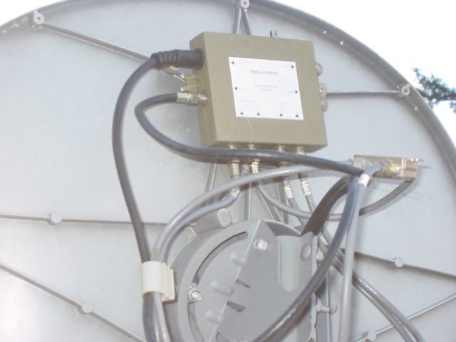

I plan to get an HD DVR (probably the HR-250) and DO want 2 cables feeding it. Re the picture below, the square box toward the top presently has 2 lines running from it to 2 Sat receivers located in different parts of my home. They are labeled Ant 1 and Ant 2. The two empty ports are labeled Ant 3 and Ant 4. If I were to run a line from Ant 3 to my HR-250, would that set me up for full 2 channel recording?

Is the square box toward the top of my D* antenna a "stacker?"
