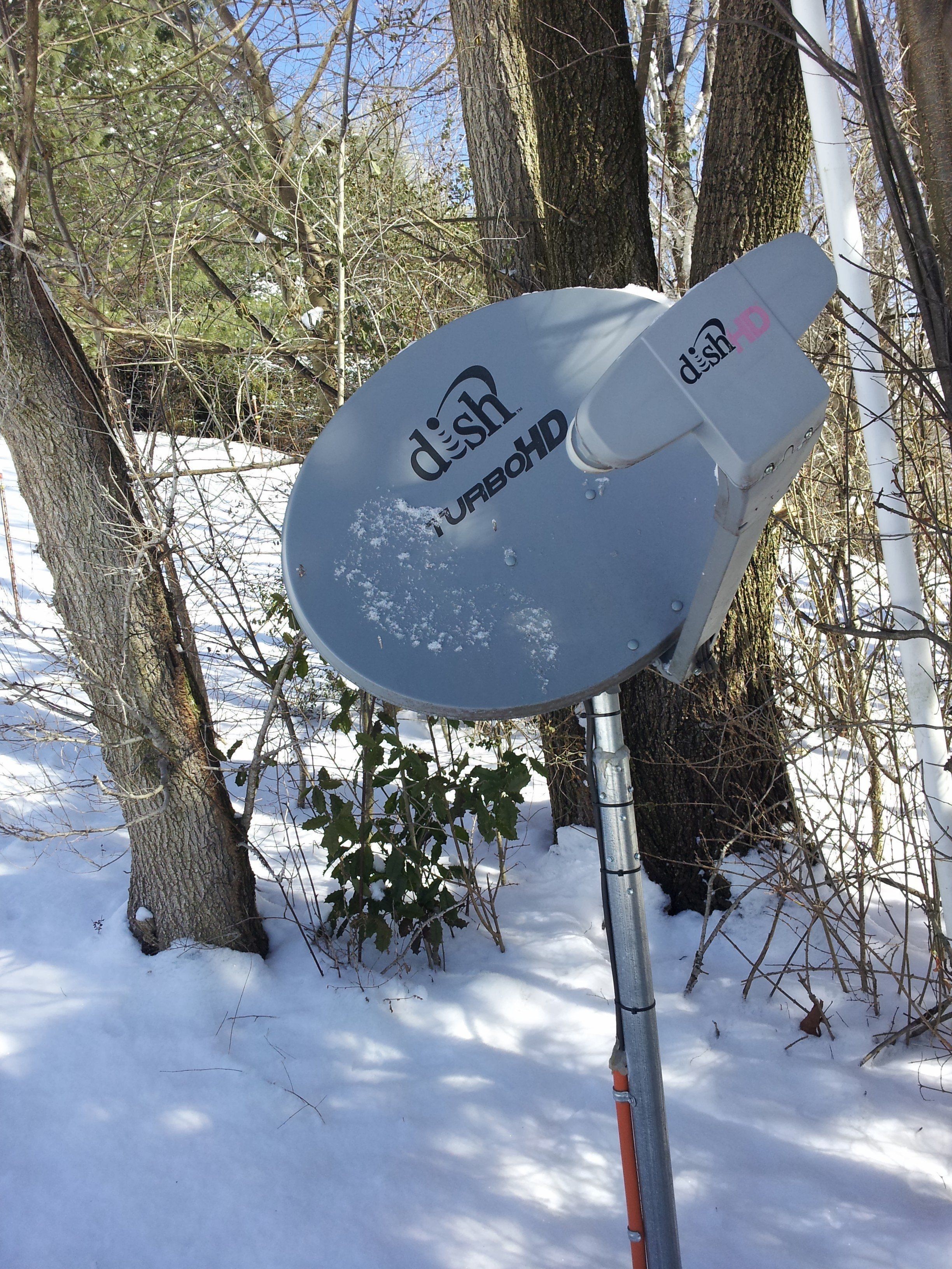

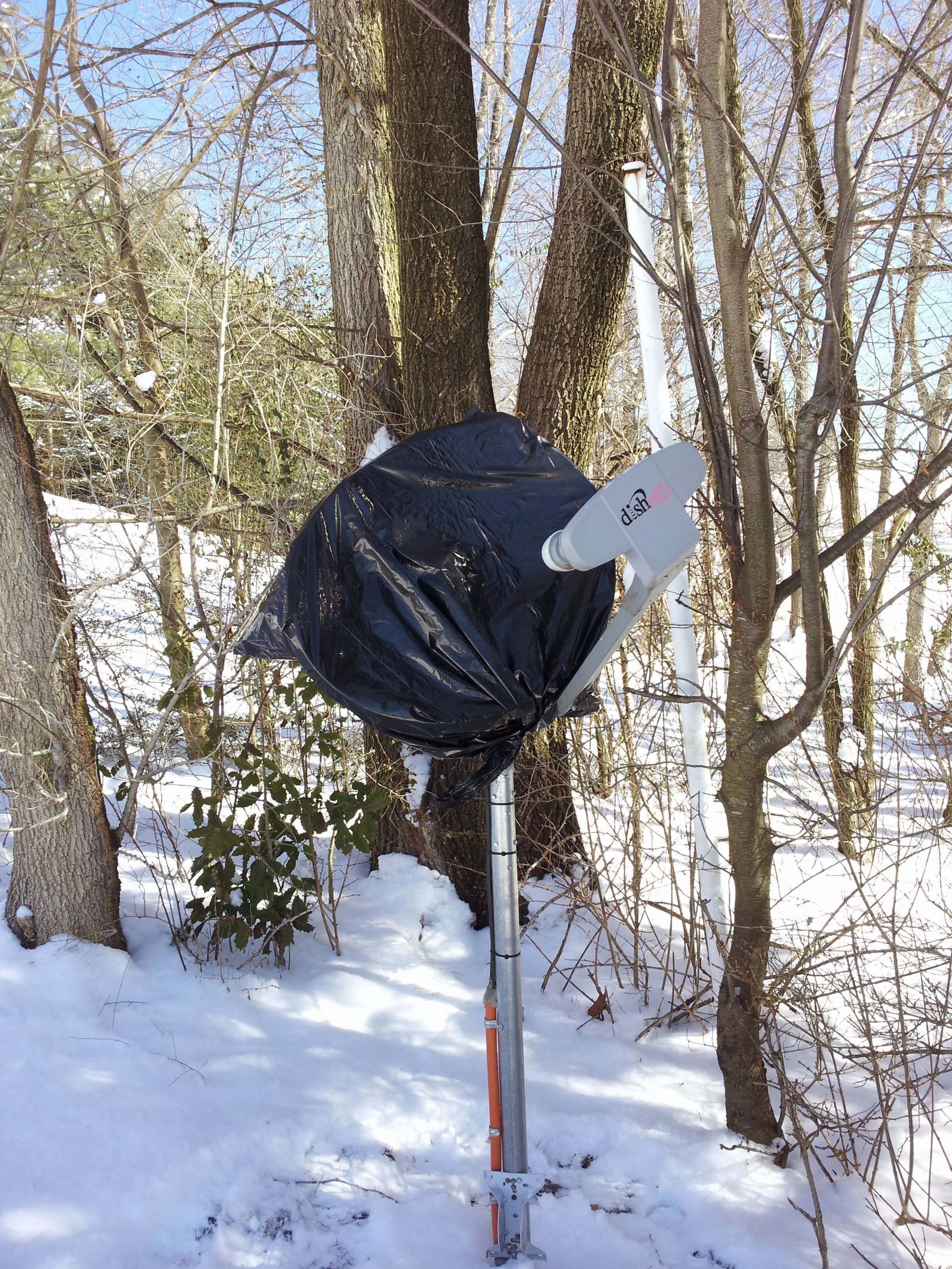

Reporting back on the trash bag experiment. Virtually no change in signal with trash bag on the dish. Here is my #'s, all signals were checked on tp11 on all 3 sats. Clear skys btw.
129 no bag 47 with bag 48
119 no bag 80 with bag 80
110 no bag 78 with bag 77
Now will have to wait to see how effective it is in keeping the dish snow free.
I wish you good luck with the garbage bag. I tried this several years ago at the suggestion of others here and experienced NO difference in signal levels either......until the first snow of the season! It was just a light but somewhat wet snow which immediately stuck to the plastic and I lost all 3 satellites. Almost broke my neck getting the damned thing off the roof mounted dish.
For the last 3 years I've had 3 small Katz stick-on heaters on the back of the dish--one in the center and one on each side of the bottom. These heaters are made to stick to engine blocks and are available through Amazon. My dish is mounted on the roof of my garage area (attached) and I simply plug in an extension cord running from the dish to an outlet in the garage when it's snowing or snow is forecast. Works great!
Others have reported good results with the bag fix but it sure didn't work for me.
