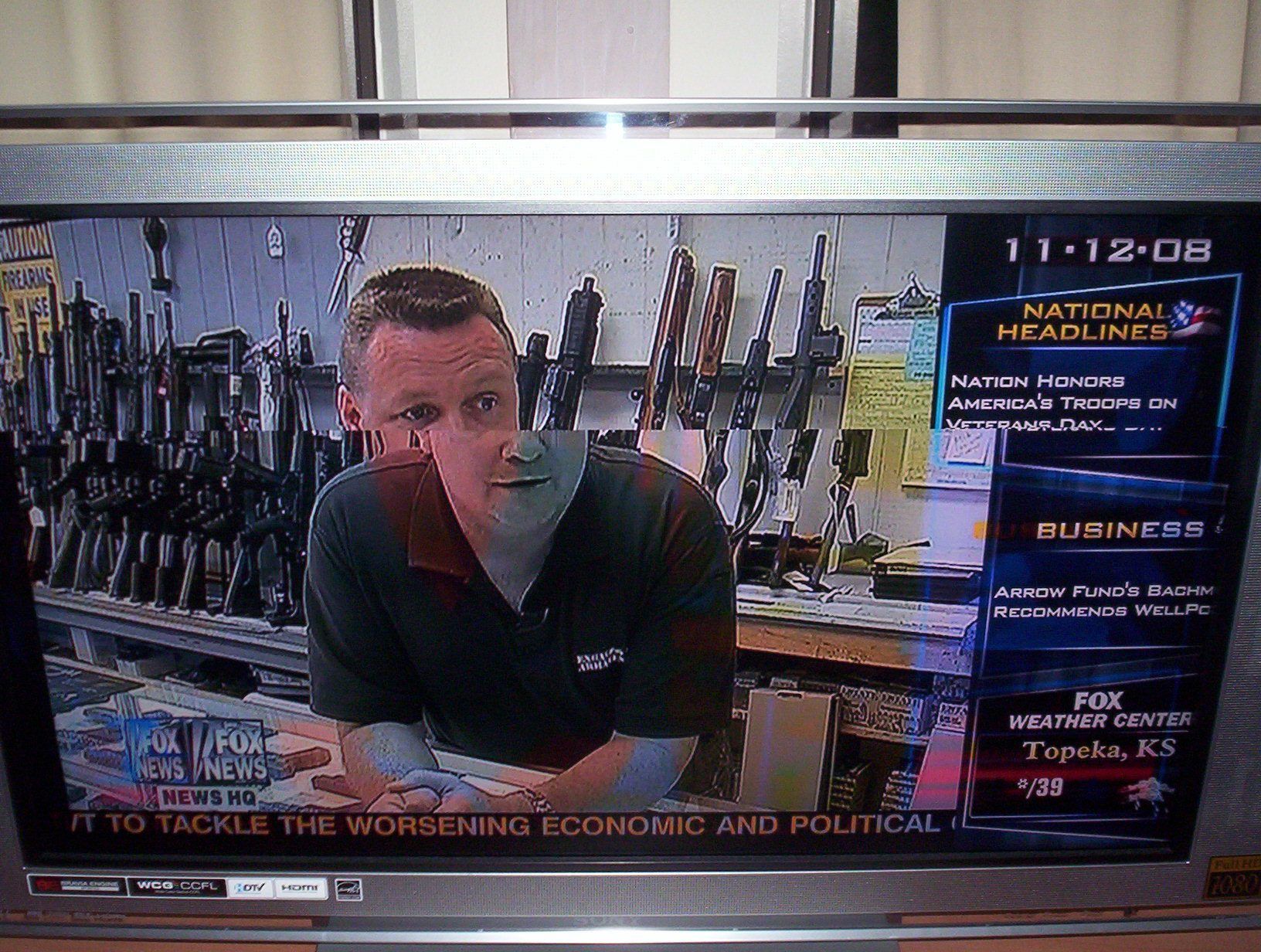

Does anyone know what this is and cause?
sonydude1966
Sep 19, 2008
199
Attached is a picture of what is happening. This is on pause. The picture splits and goes back together in about 1/2 a second. It's a very quick stutter when watching live TV. This happens every 15 - 60 minutes on atleast two HD channels.
I've noticed this with two different receivers (HR22-100, H21-100) and on two different TV's. I have a 5LNB Slimline, non-SWM. Two cables going to my HR22 in the livingroom (Sony Bravia LCD), and one cable to my H21 in the bedroom (Panasonic Plasma).
I've got a service call set for Wednesday.

Yes, reset everything numerous times through the menu button, red button, and even unplugging.

I thought you could have been on to something there. Unfortunately, after I plugged the rec directly into the wall socket, the same problem happened.
Nothing else is similar with the 2 recs, and are not going through anything else.
The channels that this happens on are 360 (FoxNews HD) and 290 (Disney HD). I haven't noticed it on any others, but of course do not watch every channel. Locals HD seem fine, as well as 244 (SciFi HD) and 284 (Science Channel HD). Showtime HD also doing fine.

Also, I have been getting the very occasional strobe like picture. It would go from picture to a blank screen back and forth in a strobe like effect. Noticed this the past few days a couple of times for 5-6 minutes each time. This morning my DW noticed something about "no signal" but didn't notice a number code that she remembers. It worked fine the rest of the day.

The problem is either in your receiver or TV. Have you (or a service tech) tried swapping either? How does your receiver interface to your TV?
This thread reads like a comedy series! When you "really" don't know what you are doing you blame anything. electrical, trees... etc. I am surprised he did not come over with a saw and start cutting down limbs.
He tried blaming the trees when we were on the phone together after his supervisor yelled at him. When he got back over here and I pointed at the dish, and said, "What trees are you talking about?," he quickly changed the subject. Yes, now that it's over, it was a comedy. At the time, it was frustrating. I think I handled myself pretty good. Sometimes I don't. :rolleyes: A work in progress for me. It was still worth the trouble though, because I got 10 more points on the sat signals for 99 and 103.
The only problem with your theory is that it's 2 different receivers (HR22, H21), and 2 different TV's (LCD and Plasma), using 2 different cables from the dish to rec's. Actually 3 cables (2 to the HR22, and 1 to the H21). And it's the exact same problem on channel 360 (FoxNews HD). I use an HDMI cable on the HR22, and component on the H21. I changed out the HDMI cable, no difference.

If it happening on one receiver I would say it's RAM issue or DAC or VideoRAM; for many receivers and one TV - TV is bad; but the issue cannot be related to dish/LNBF/cable/switches for sure.
It is inside TV or receiver or between - i.e. signal processing, and transporting.
