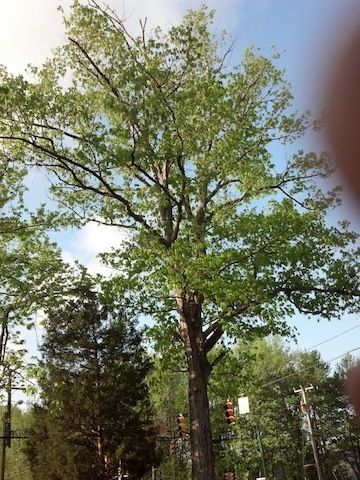

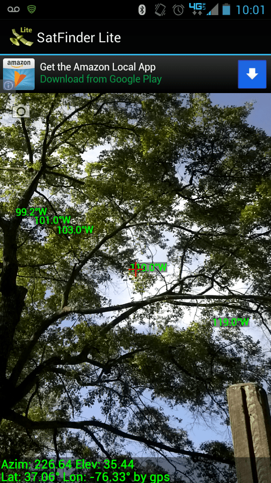

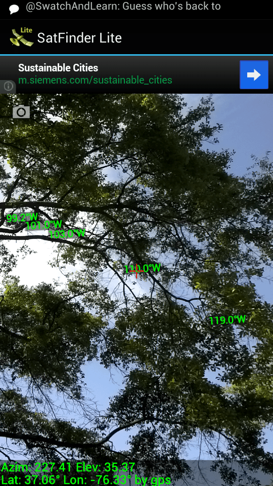

Hello everybody! I have a question. I used this app and took these two pictures of the LOS from were I want to put the DirecTv dish. Do you think I can get a good signal with this tree in the way? I am moving here and this place is full of trees. Let know what you think.

Umm, no. You must have 100% clear blue sky.
Slim to no chance of a reliable signal with all those leaves in the way.
Should I describe the shotgun trick...........or is this tie a saw to a monkey and pray?
As an installer I would just drive by and call with the bad news.

You could probably make it work, but as soon as the trees started to fill in, you would be out of service.

Judging by those pics, I am 99.99999999% sure his dish isn't sitting there. Them branches are too full to get a signal through them

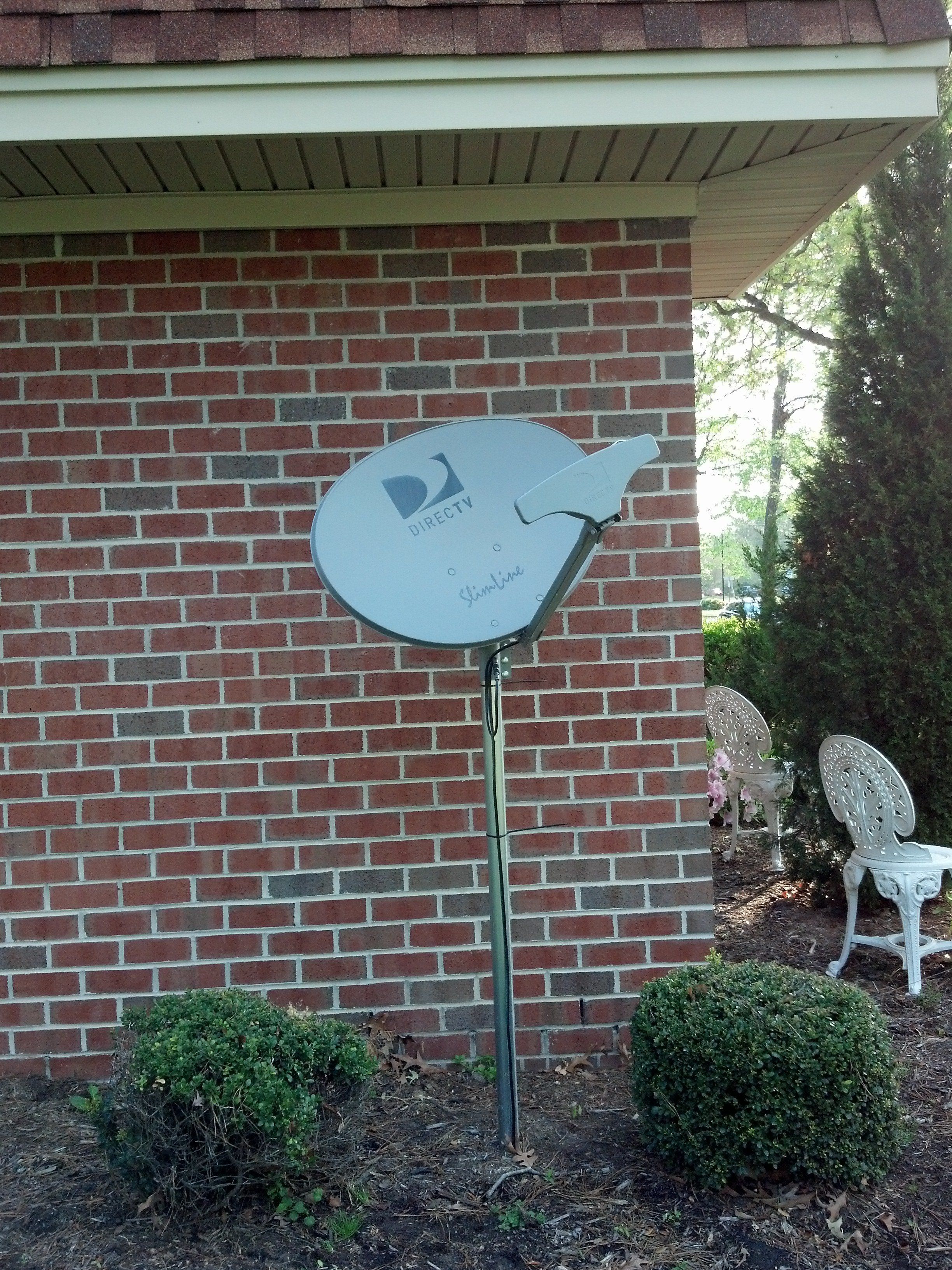

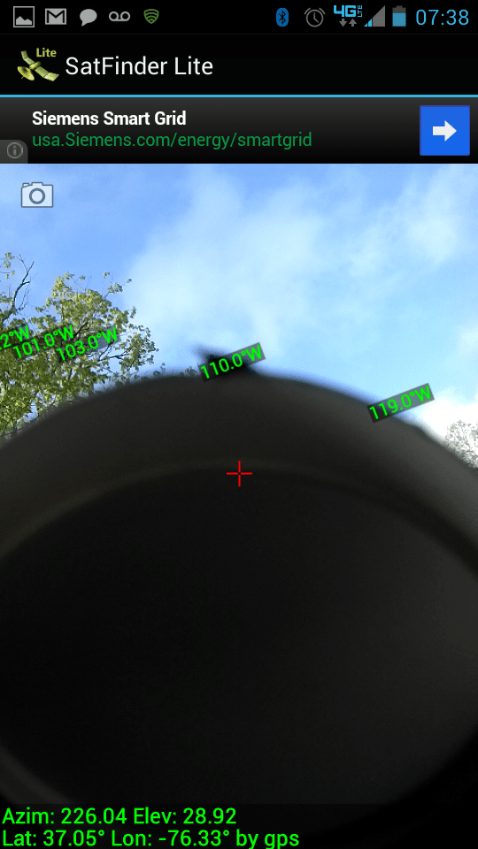

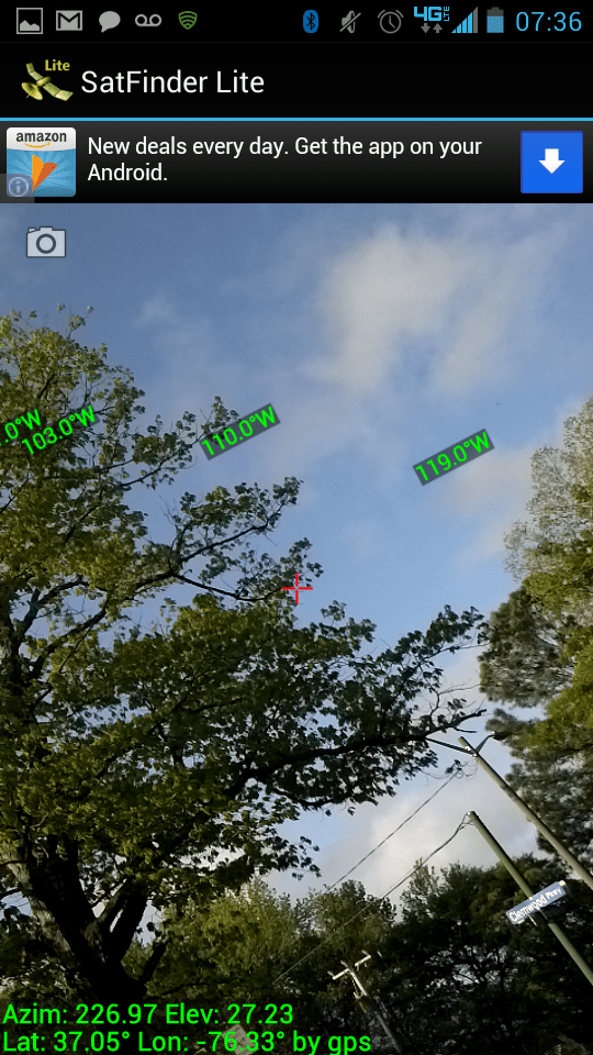

Here is the view of my current D* dish. See how this tree is blocking some of the LOS? But I have never had any errors. Unless a very hard rain comes in here. It has to be very hard. Most of the time during rain I get no problems at all. I took a picture from inside the dish so you can see how it looks, and from the outside of the LNB's.

If you look at the cross hair on the signal pick and line it up with the top of the dish you will see your los is close, but actually fine, not to mention apps are usually a few degrees off of an incclinometer.
Sent from my PG06100 using Tapatalk 2
Yeah you are probably shooting over that tree or more than likely to the right of it. There is no way with the app showing the 101, 99 & 103 dead in the tree that it would work like that. I would assume that the dish is pulling your compass in the phone off a bit.
