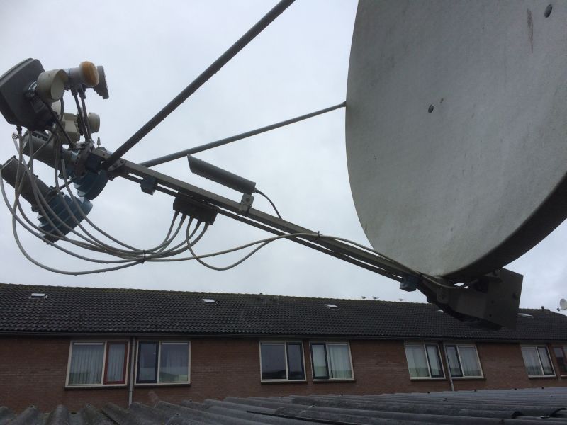

very cool, and definitely interesting, but i have to wonder why so many LNBFs. I can see the need for 4 of them: C-Linear, C-Circular, Universal Ku Linear and Universal Ku Circular. Ok maybe also a few variations of Ka (which I'm not familiar with at all), and maybe the exotic 4.5-4.8 GHz C-Band (which exists in Linear and in Circular).
But the 2nd video shows what looks like 5 Ku LNBFs...
Reactions: martin-f and N5XZS
Hi yes KA band four LNB is needed to cover the whole spectrum I am unsure if he hunts extended c band but he could do.

Old picture of C- circ / C-lin / KaKu combi / Ku lin / Ku circ / SL3K at 1.8 m Channelmaster
Now also a modded Ku lnb attached for EsHail 25.5º E (10.300 - 10.700 Mhz)
