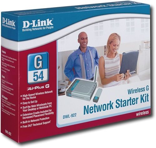

I have tried all the Admin and Administrator but did not leave the password blank. I have tried the Admin and Administrator in the password also.
The attachment is like the one's I am having problems with. I cannot get a DW7000 to work with them. I am thinking it may be something to do with the connection type the router is looking for.

The router was for a customer I installed today. I called him just a moment ago and and got him in the router and his connection was set for PPPoE so I had him change it to Dynamic, saved and reset everything and it is working fine now. From the test I had him do it is not running far off from the hardwire I had him set up with when I left so he was happy. Thanks again.
