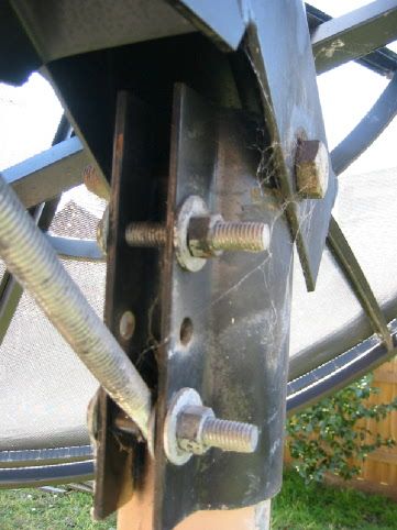

Like to ask if my current dish 2.6M KTI Mesh C Band pole which have 89mm Outside Diameter. Can I substitute for a smaller pole , perhaps a 76mm OD Pole?
Here's a pic of my polar moun.
Regards
RMT
Looks like you have just about enough clearance to reduce the diameter slightly, if you measure the space between the nut and the blot heads on the mount clamp, as long as its greater than 14mm should work.
You could always use some PVC tube split to take up the difference in diameter!
