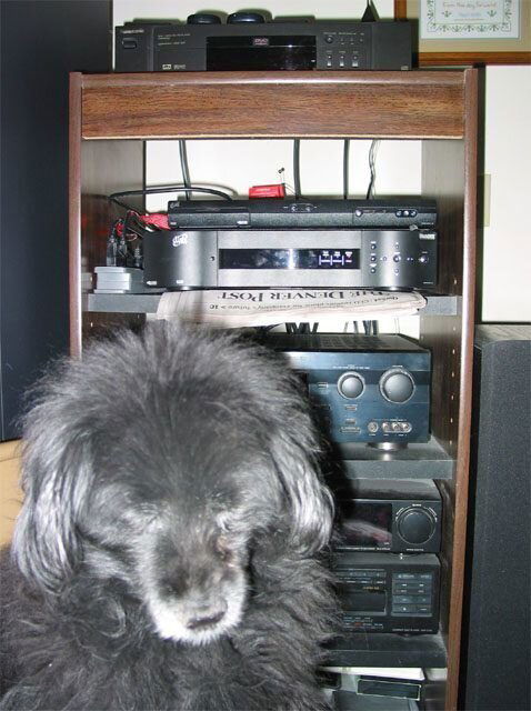

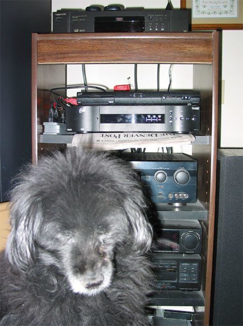

And just in case you don't believe me about that old blind, deaf dog, I've attempted at attach a picture ...
I thought you were joking about the dog... Hey! I see that! Be careful with that newspaper under the 522. You can't count on the 522 to pee on the paper when it catches on fire!
BTW Haertig,
Your fan is probably running a lot because you have a component sitting on top on the 522. Most of the heat is generated by the harddrive which is in the upper-back-right corner of unit. Yes, I know there's no ventilation holes there, but a lot of heat is dissipated there. I used to keep a DVD player on top, and the fan ran all the time. I switched the DVD player and 522 so the 522 is on top and the fan no longer runs. Well, I've only noticed it run when my wife sets a DVD or book on top of it. So, don't put anything on top of it!

That's my 322 - right where the Dish installer put it. I was initially worried about the heat problem, but the fan never has run before that I'm aware of, so I forgot about it. Now that my fan runs on occassion I think you're quite correct about moving the 322 to open up some airspace.

The dog actually has one eye, although you can't see it in the picture. Unfortunately he's blind in it anyway. p.s. - and don't worry about the newspaper/fire potential. The newspaper was just a stand-in for the photo op. I'm not THAT dumb! ;-)
