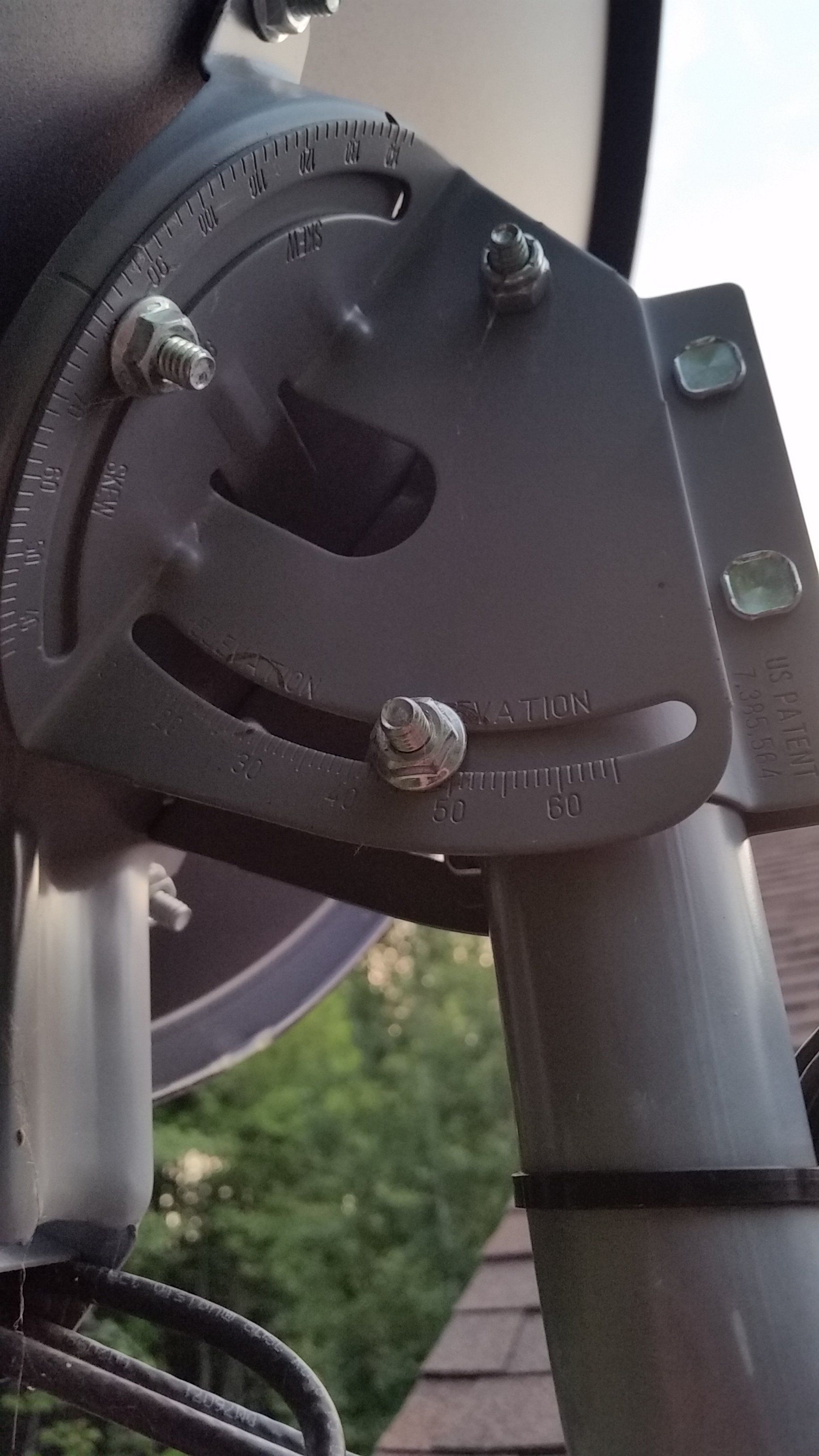

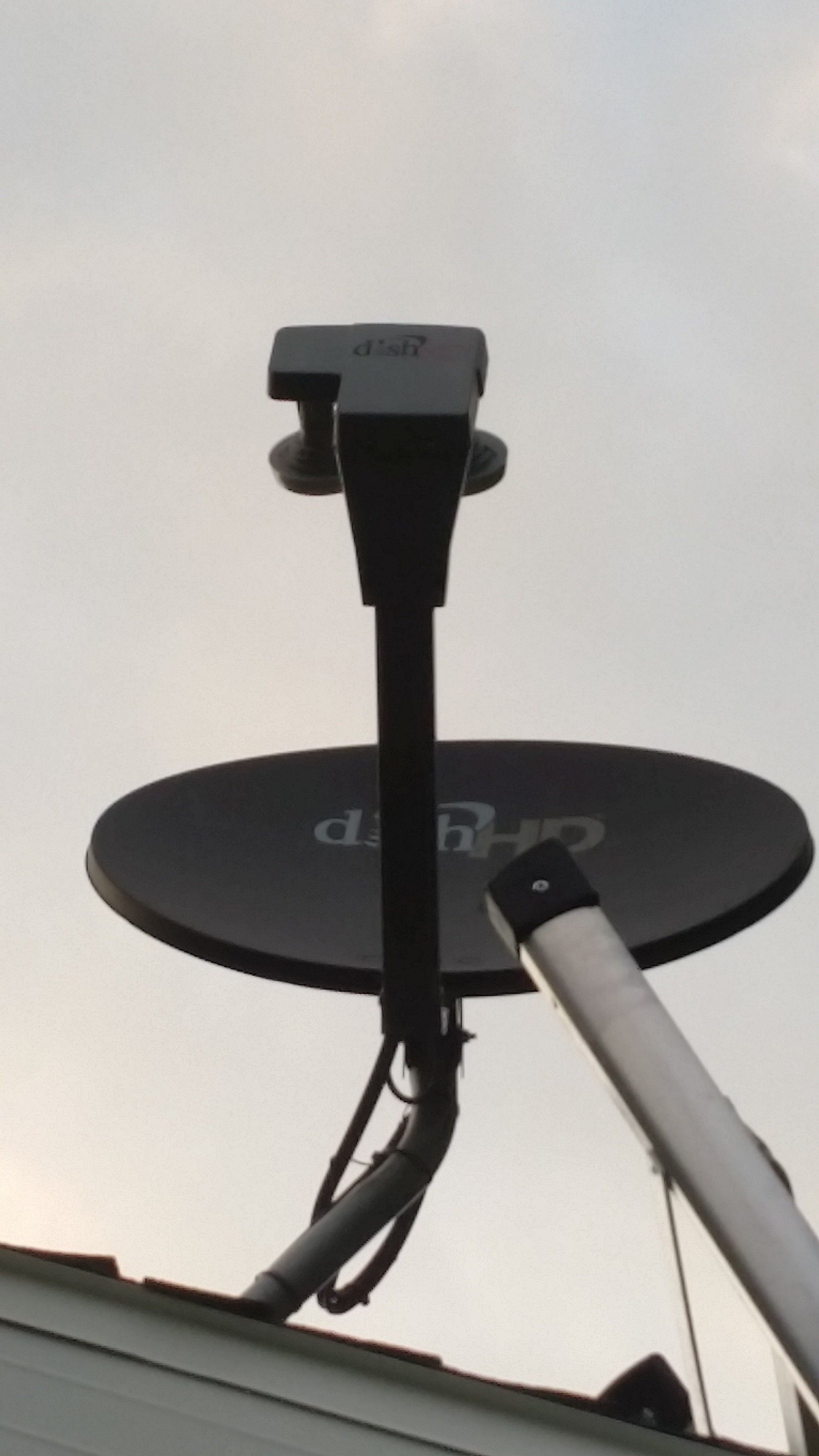

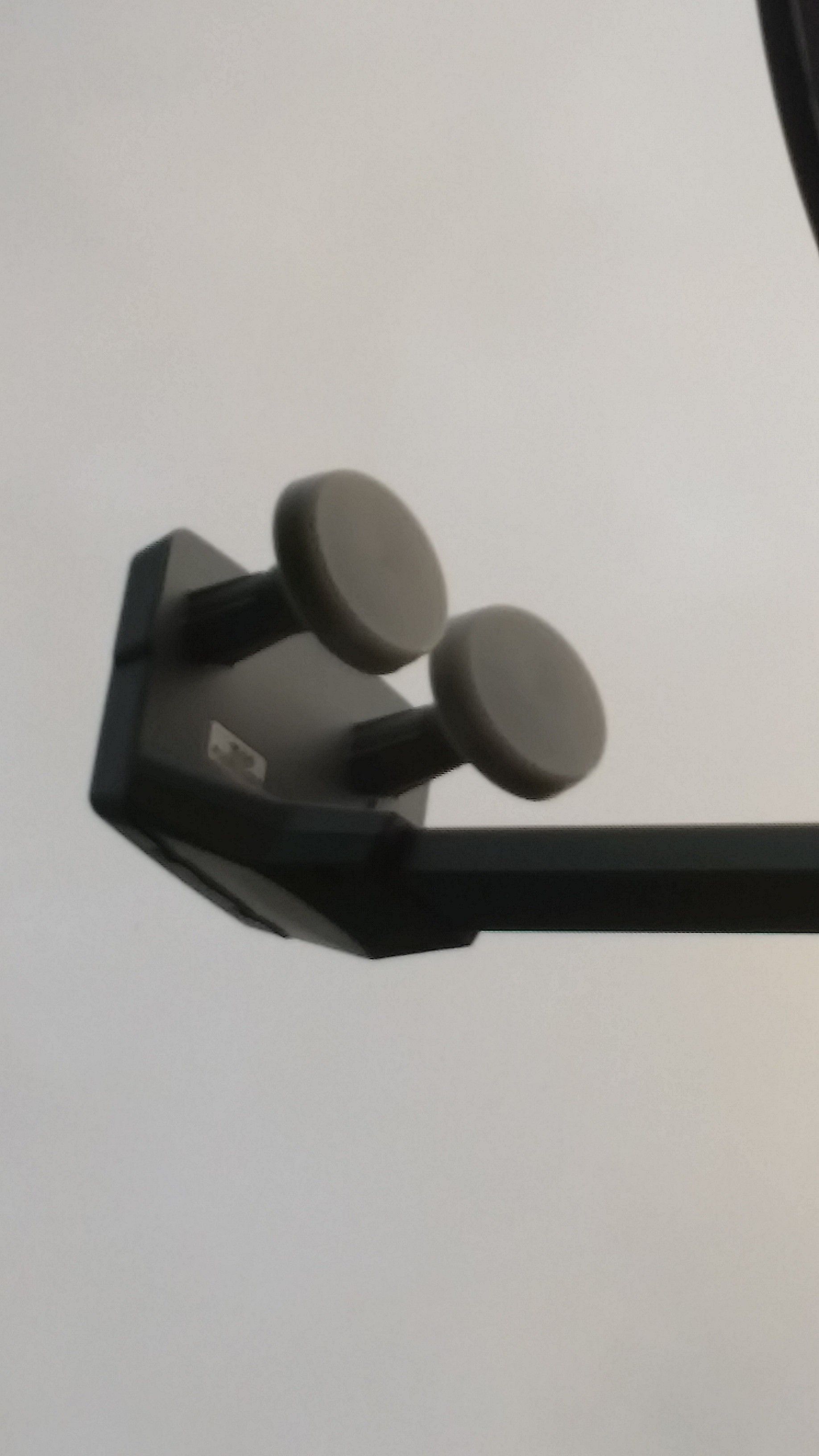

Got to take a closer look at whats on my roof. Its a black DishHD measuring 21" tall, 26" wide. It only has 2 LNBF (same size right next to each other) with 2 coax cables running down into my basement. There are no switches inside connected or disconnected to these coax runs. I was thinking of using 1 - 2 receivers max. Skew is set to approx 82 degrees, Elevation approx 45 degrees. My zip code is 14040. Not sure what if any of that information is useful. I am interested in pulling in HD channels.

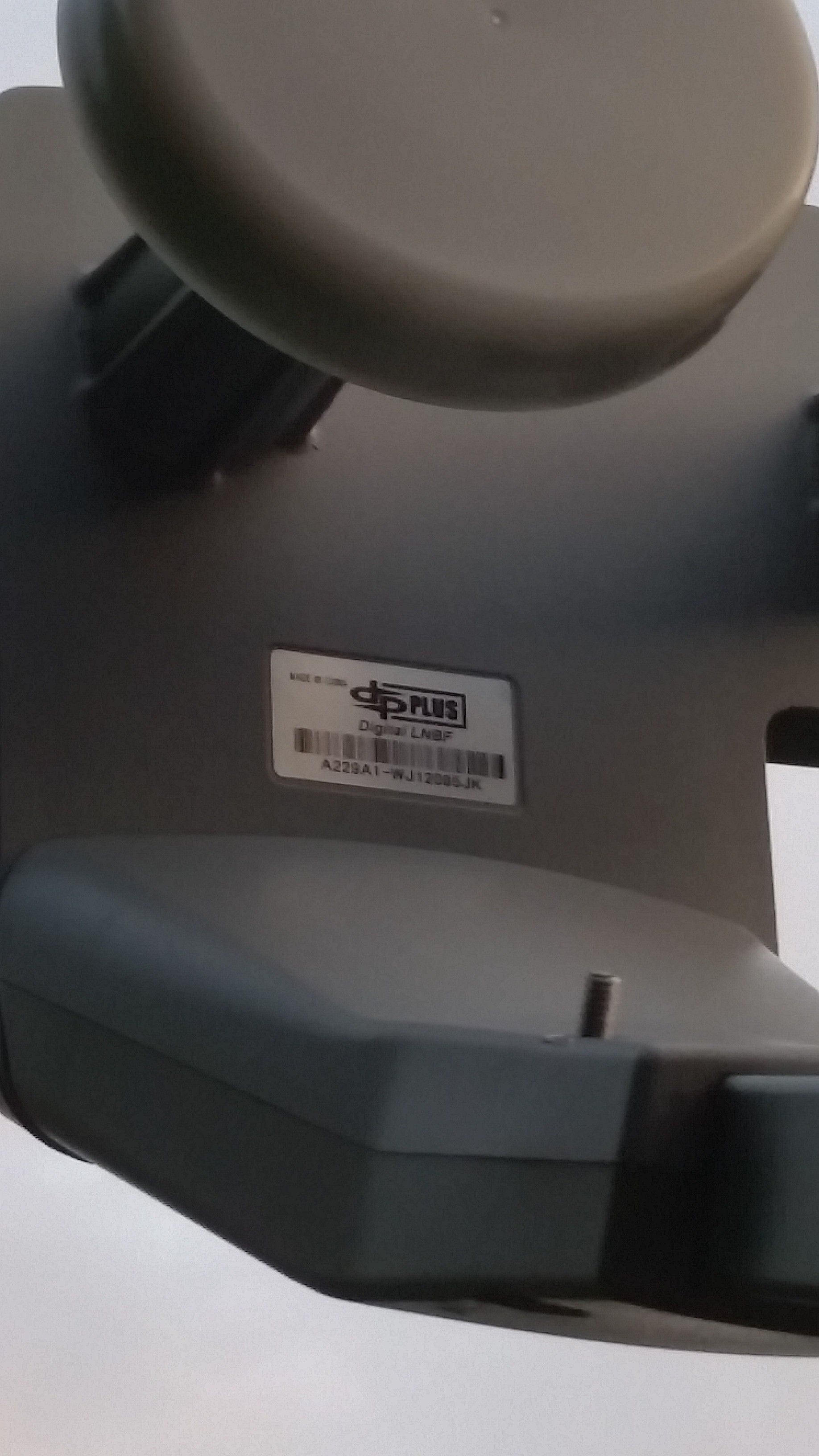

I could be wrong but I am pretty sure that there is a switch installed within the LNBF and is an integral part of it, so it cannot be removed. Each Coax should see 3 orbital slots. I guess there is nothing to loose trying to aim it but with this set up I am not sure that the Bell Receivers will understand the type of switch used so you might have to resort to another Dish/LNBF combination.
That is an Eastern arc dish. it is aimed at 61.5 and 72.7. The switch is built in and would support two dual tuner receivers.
You can try to use it for bell. however with the LNB spacing being 11 degrees instead of nine one of your satellites will have more signal

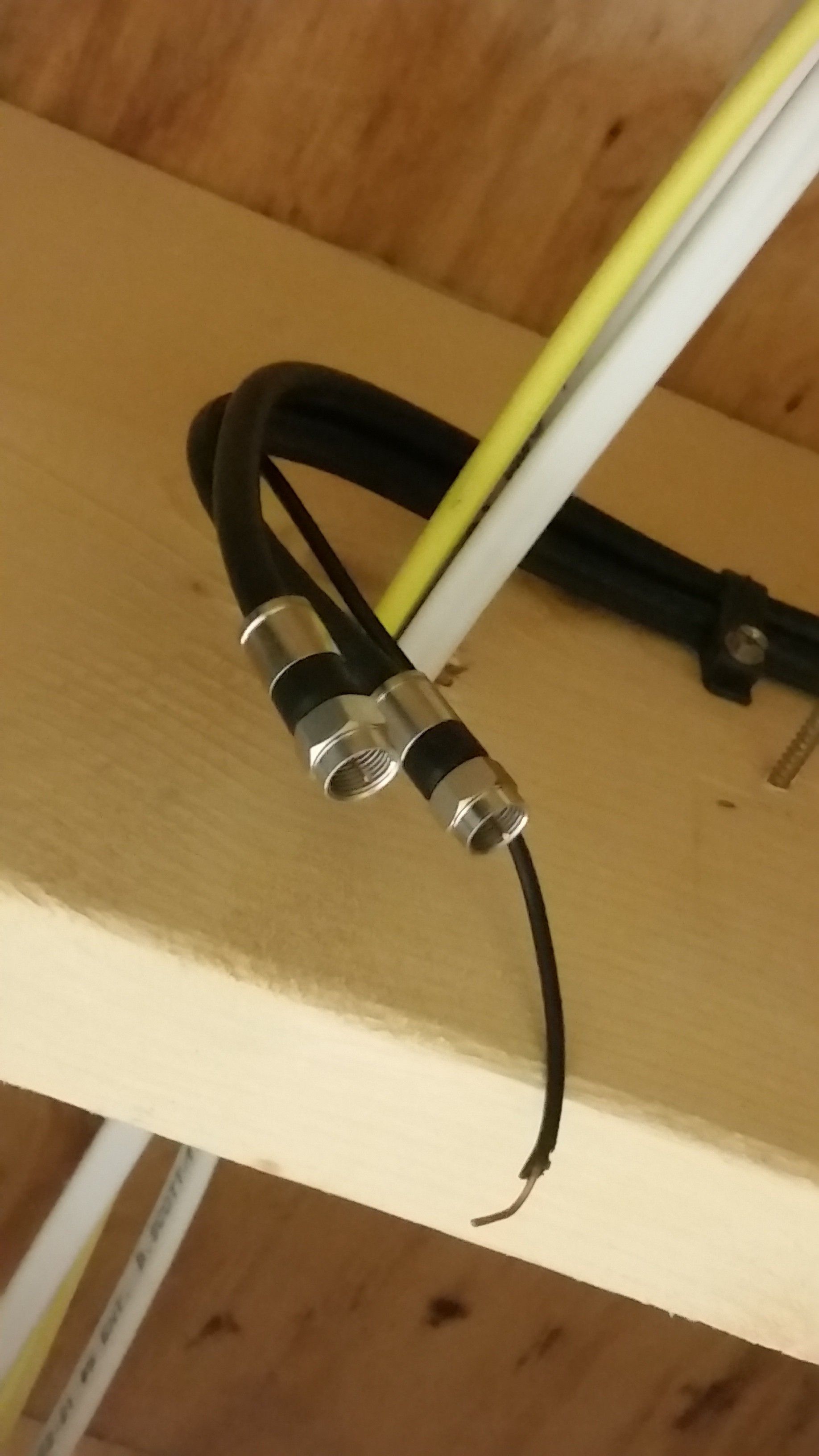

Actually the DPP EA2 would support 3 dual tuner receivers.
So would the Eastern arc 1000.4 LNB.
But it looks like to me they didn't run the 3rd wire into the house.
They didn't run the 3rd wire into the house.
The holes don't line up on the dish network arm to mount the bell y adapter into the dish network arm. Plus the arm of the dish network dish is a solid few inches longer than the bell arm, not sure if that would make a difference though i would think so.
The bell bracket does fit on a dish network mast.
