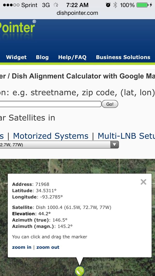

I went to dishpointer and there is no selection that I can find for 1.k2EA ?
You're right. But if you look for a 1k.4EA(gives you the third bird) this would be your angles

I would hook it up to your home dish, let it download the current firmware and activate it before going to the lake. I find the 211 very hard to point, it's very slow to respond to changes you make to the dish. If it's got the wrong software your dish configuration might not even show up in the point dish dropdown menu.
One caveat is the receiver is going to warn you that your dish configuration has changed if your home dish is different than the lake one. You can run a checkswitch without the dish cable attached to clear the matrix and start fresh.
If you get it mounted to the dock and aimed correctly, the dock will have to move pretty good to screw up your signal. I have a 1000.2 EA dish on a heavy duty manual rotator on the top of the radar arch on my houseboat. I have seen the back of the boat swing ten feet and not lose signal. Rocking left to right has more effect. I use the rotator and a $15 signal meter to reaim the dish when I take the boat out and tie it up to shore for the weekend.
And, JayStil is correct, the 211 family can be slow to respond to tweaks to the dish. So, I would suggest that you buy a cheap signal meter to help with the initial aiming.
