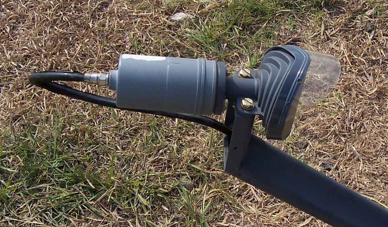

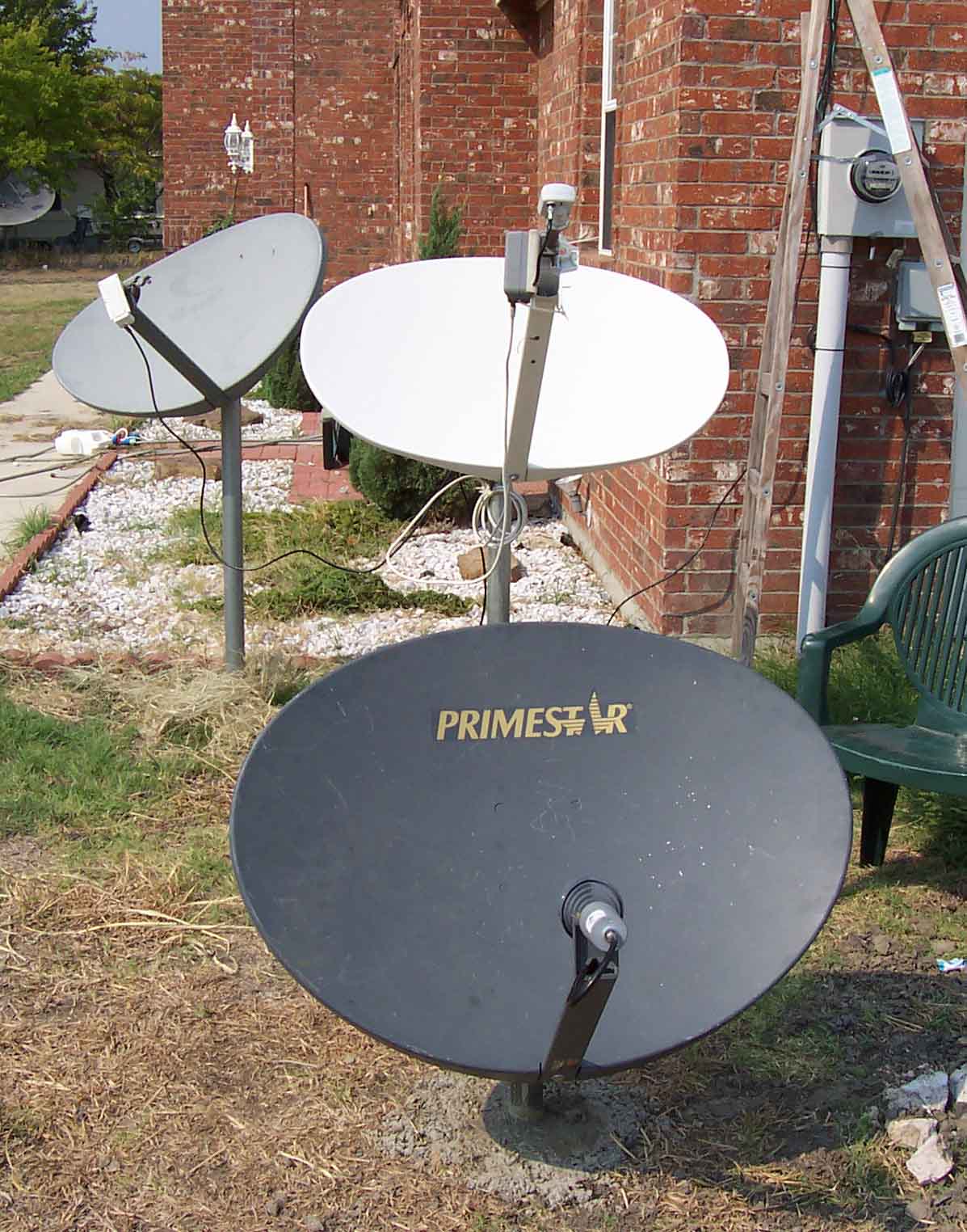

Added Dish #3 today, A Primestar 84E that I picked up for free from a member of this forum. (Thanks SlicerMDM!)
The white dish in the center is my first dish, it's a motorized 1 meter direcway dish. I added an invacom LNB to the original feedhorn.
The smaller grey dish on the left is an older, smaller direcpc dish. I picked it up cheap off ebay. I'm using the original feedhorn, but the LNB from the white direcway dish.
I'm using the original feedhorn on the Primestar dish, but I'm using the LNB from the grey direcpc dish. The LNB that came with the Primestar had seperate connections for V and H and I only had one port left on my switch.

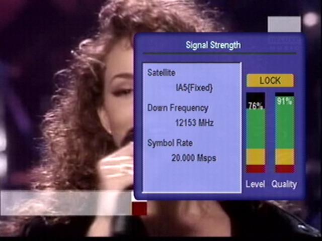

I'm getting *great* signal from it, even using that ancient direcpc LNB. It's got to be at least a 5 or 6 DB LNB, but it's pulling in 90-94% quality on IA5, Deluxe Music TP.

I'm pretty fortunate in that regard... I keep trying to get my neighboor to give me his unused 10 foot BUD. If you look carefully, you can see it on the very left edge of my picture.
I seen it! Does not look to be working as its covered by branches. Much like the 6' dish I have the owner said "it only works in winter" : ) Works all year round now its got a clear line of sight to the Clarke Belt : )
