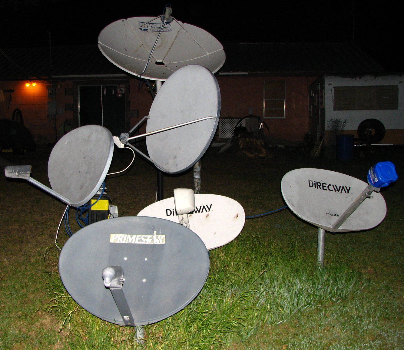

30ku Cuban movies ;)
83ku RTV/TUFF :) (Tuff only at midnight)
87c MeTV :D
97ku various news channels :)
101ku History (defunct) :(
125ku PBS :)
The above dishes are fixed and on a switch for instant channel changes.
The 6' Cband has a motor but I have no need to move it off of 87 AMC-3. :D
Soon I am putting up a 10' C-band and motor and sometime this summer I am putting up a 1m ku with a motor in addition to the above dishes.
Just for fun.
I need to switch the dishes around again because I put my biggest ku dish on the PBS satellite for better reception. So now I have two pointed at 125. I need to put one back on the Cuban satellite. As for 101, eh.. That was a real loss. I'll leave it as is for a few months and if they don't fix it I'll figure out something else to point it at.
