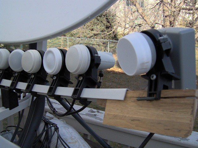

the reason you think they are "backwards" is because it hits the dish and richochets to the LNB. When you work with multiple LNB's, they will be opposite of what they are in the sky. So from behind the dish 119 is to the left of 110
In the below picture is an example. The closest LNB is 119 (the one on the piece of wood), then the next one ia 111.1, 107.3, 103 & 101
The 119 is the farthest LNB on the left if I stood behind the dish

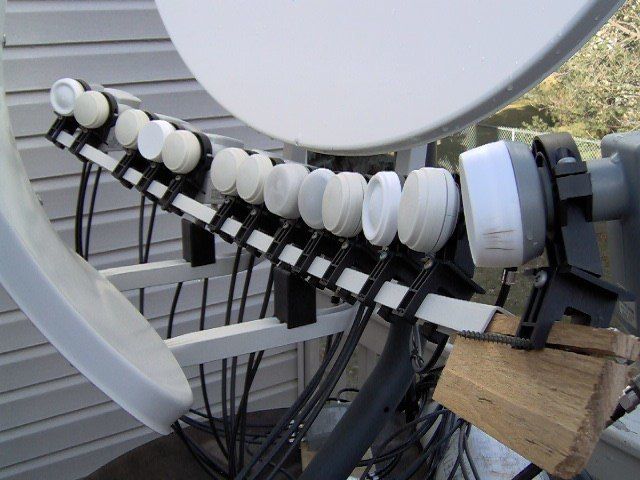

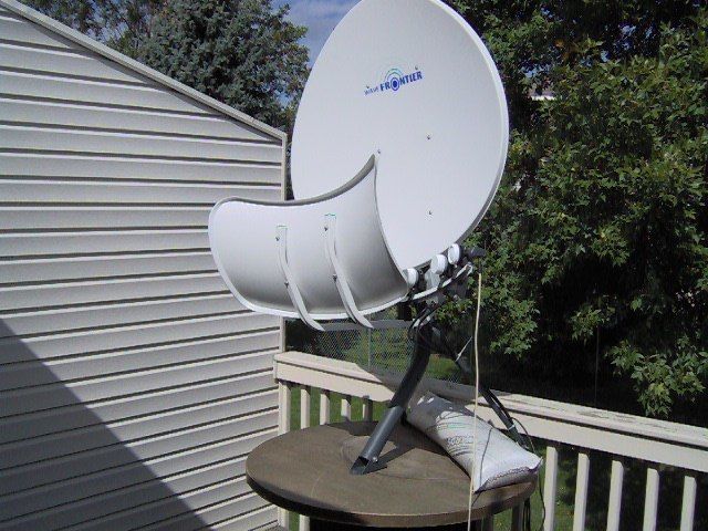

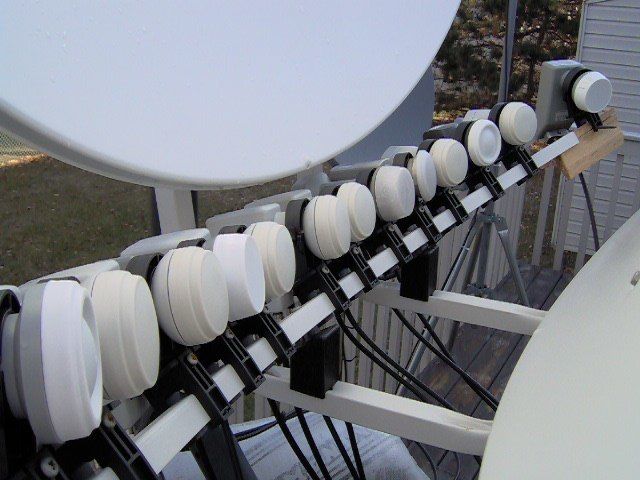

I have a Toroidal T90 dish that allowed me to combine my Free to Air stuff, my StarChoice subscription, and 119 from Dish onto one dish (110 is on a fixed 24" dish)
The LNB's that I have it at are in my signature and here is a couple more pictures
Well I look at your pictures and it seems like an obviosly diffrent set up than the dish500. Yours are pointed towarded a reflector? and then bounced to the dish. Mine are pointed directly at the Dish.

You've got to be kidding me! I hadn't seen your setup Berg, how many satellites is that picking up?

If you stand behind the dish, the lnb on the left side is 119 the one on the right is 110. They're also labeled in the plastic bracket, with small numbers. Like I said, cover 110 with aluminum foil and look for 119 then run check switch. It's gonna make your life easier.
13 satellites picked up at one time
FTA satellites
72, 74, 79, 83, 85, 91, 93, 97, 101, 103
StarChoice Subscription
107.3, 111.1
Dish Network Subscription
119 (110 is on a 24” dish)
Here is the review I did on the dish
http://www.satelliteguys.us/showthread.php?t=77005
Correct, The T90 is a dual reflector dish so the LNB’s are aimed at the sub reflector. But the reason of the picture was more to show that with multiple satellites, the LNB’s are on then opposite side of what they are in the sky
